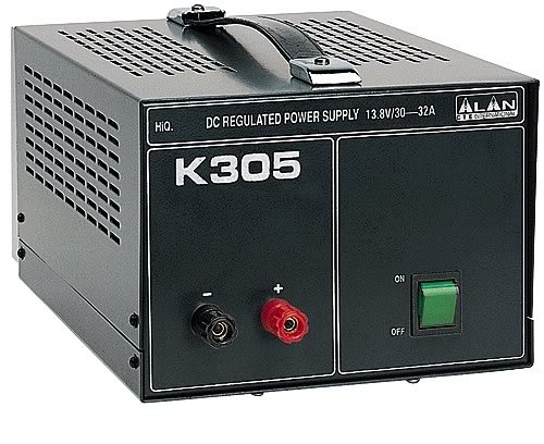

cocacola 0 Posted February 26, 2008 Some mid price range camera's for outsite, hope they give a nice view Gona put a balun on al of them and run it whit 20 meters of cat 5. This gona be the first time i gona use can 5, so hope is better than coax. (By the way witch wire i need to use for video?) Congrats!!! It's always fun opening boxes from UPS and seeing things you've purchased, I love it. As far as which ones to use for video it will not matter inside of the Cat-5 as long as you use the same ones the same way on each end. The small white boxes are your power supplies am I rite? Why not a distributive power supply box? Thanks, John Like this? ebay Item number: 220205368503 or better one that i can push, so overclock the voltage do composite for cable losses? Item number: 170195918267 Or is this cheap solution better? Share this post Link to post Share on other sites
Smit9352 0 Posted February 26, 2008 Like this? ebay Item number: 220205368503 Something like that I was thinking. But you can get a smaller one that functions just as that large box that takes up to a 4amp DC power supply or an AC power supply as well. Either like the picture I posted or the one you posted. For a smaller application I really don't think you need anything to to large. Thanks, John Share this post Link to post Share on other sites
rory 0 Posted February 26, 2008 Like this? ebay Item number: 220205368503 Check out Altronix, much better. Share this post Link to post Share on other sites
Smit9352 0 Posted February 26, 2008 Like this? ebay Item number: 220205368503 Check out Altronix, much better. I had assumed that he was trying to keep things inexpensive which is why I posted the other one Thanks, John Share this post Link to post Share on other sites
rory 0 Posted February 26, 2008 Altronix is only about $30 more than the OEM PSUs. Get individual fuses, etc, and a small box. Otherwise he could just buy a 2amp Transformer from a local electronic store ($10) and splice all the cameras into that .. From experience though, its not a good idea to go cheap on the PSU. Share this post Link to post Share on other sites
Smit9352 0 Posted February 26, 2008 Altronix is only about $30 more than the OEM PSUs. Get individual fuses, etc, and a small box. Otherwise he could just buy a 2amp Transformer from a local electronic store ($10) and splice all the cameras into that .. From experience though, its not a good idea to go cheap on the PSU. I wasn't saying to pass up on getting the Altronix power supply I was just saying I didn't know his budget Buy cheap power supplies once and possibly end up buying cameras twice! Thanks, John Share this post Link to post Share on other sites
