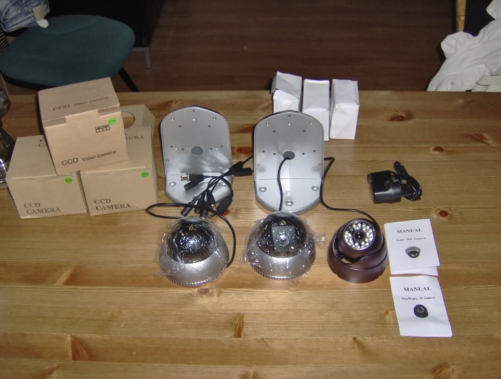

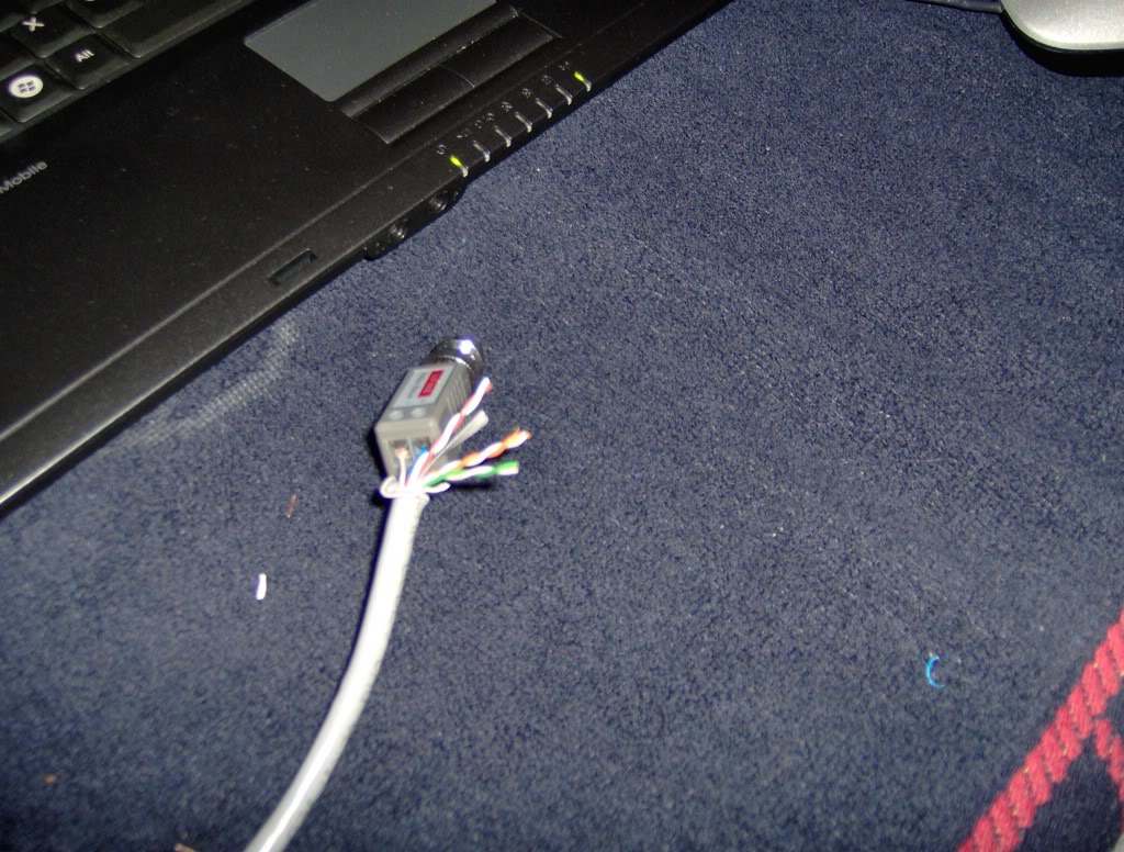

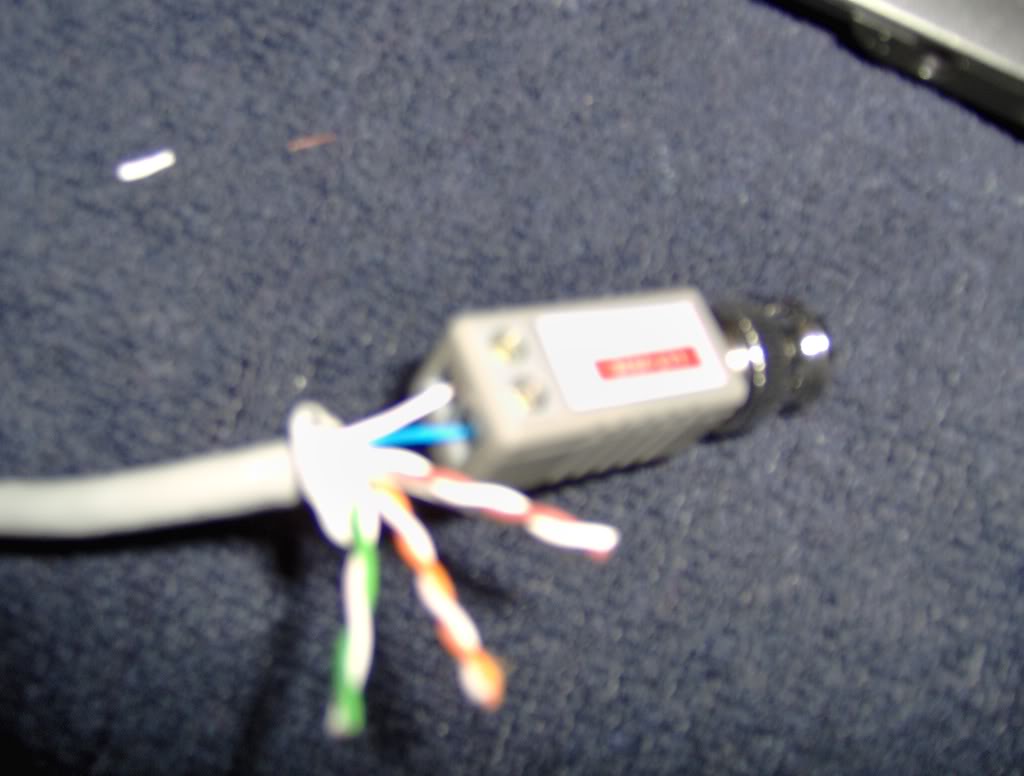

cocacola 0 Posted February 25, 2008 Hi all, I have a view questions about baluns (passive) My situation: I want to hang a fixed camera dome outside, and use cat5 and also run power tru the cat5. Baluns Can the stand cold well? I have some camera's whit 20/30 cm of wire already on them) See picture: Can i just tape them in and hang them outside ? If i want to put the balum inside of the dome (there is space for it) i have to cut the original cables From the Camera come 3 little wires, red, black and yellow. Witch wire di i have to connect to the balum? ( i thing yellow on balun - red on balun + black on just a wire from cat 5?) Share this post Link to post Share on other sites

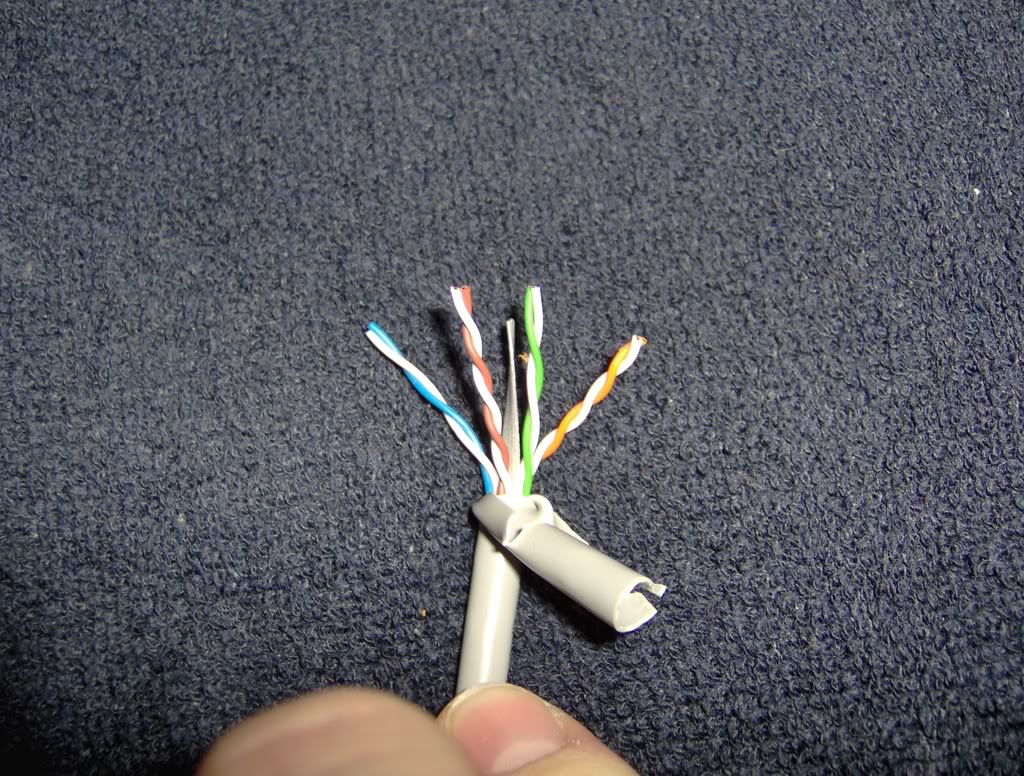

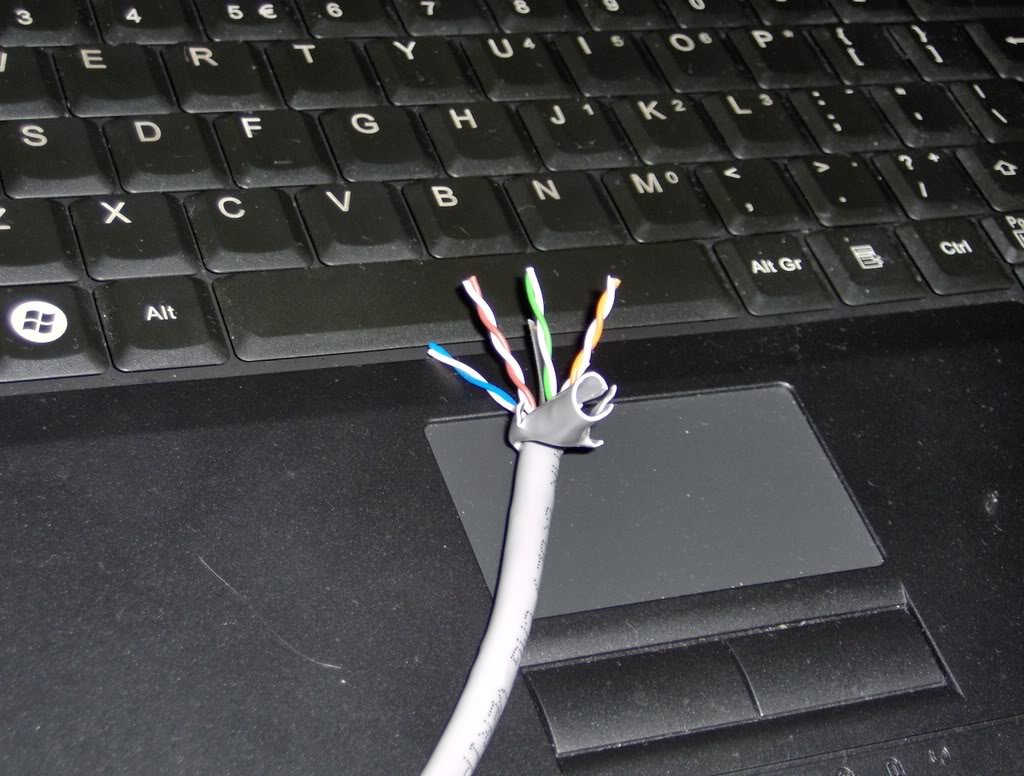

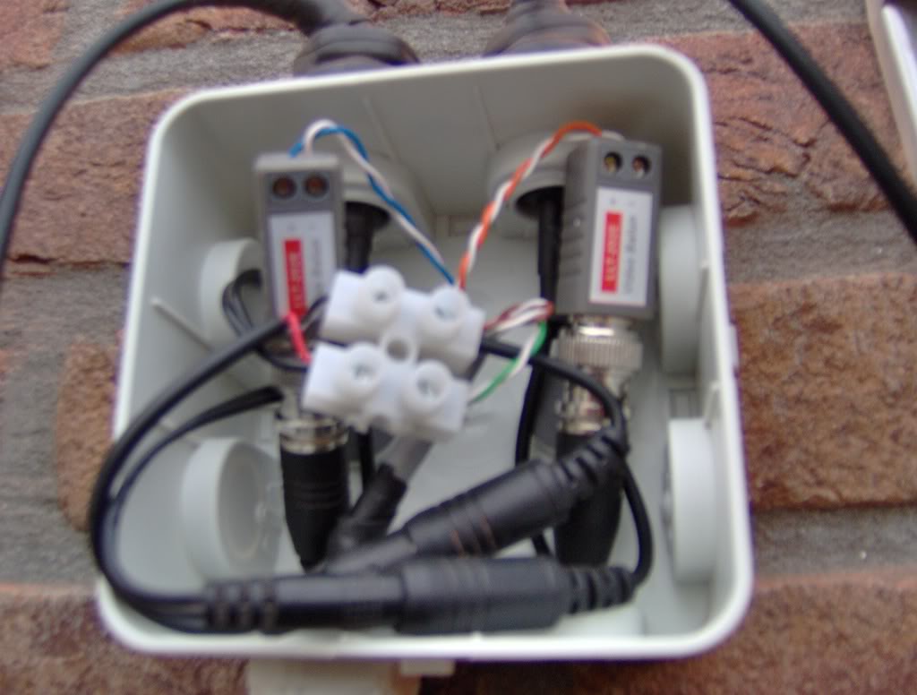

cocacola 0 Posted February 25, 2008 Question: I see the Cat 5 wire has 4 pars of wires: blue/withe brown/withe orange/withe green/withe It seems that: brown/wite and orange/withe are more twisted than blue/withe and green/withe Is that correct? Do i have to use the blue/white? On the balun stands a + and a - Must i put blue on _ and white on -? Can i put 12 volt on the brown/white? pair or i use the white from the blue pair also for negative power? See picture. See the + & - what wire must be on them? Deliverance in twist of the wires. Deliverance in twist of the wires part 2 Connected white on - and blue om + Connected second balum and pun - on white and + on blue. Can i run 12 volt of power on one of the other pairs? orange for example? This are the cams that i want to use outside: 12 volts cams. Share this post Link to post Share on other sites
UMDRanger 0 Posted February 26, 2008 All four pairs are identical for the twist rate, so any of them will carry the video. The company I worked for used blue/white and green/white as our video, and orange/white and brown/white for power respectively. Just be sure the blue is on the positive terminal on both baluns, likewise for negative. Share this post Link to post Share on other sites
Smit9352 0 Posted February 26, 2008 All four pairs are identical for the twist rate, so any of them will carry the video. The company I worked for used blue/white and green/white as our video, and orange/white and brown/white for power respectively. Just be sure the blue is on the positive terminal on both baluns, likewise for negative. This is the same information that was told to him in his previous post concerning the same thing with the same pictures . Maybe he didn't read that post, anyways here goes again. Just like UMD said, you can use any colors you would like for whatever you would like them to be as long as the colors match on the other end. Blue = Video at the camera end then Blue = Video at the DVR end as well. Green = Positive Power at the camera then at your power supply Green = Positive Post This is all you have to worry about. Thanks, John Share this post Link to post Share on other sites
C7 in CA 0 Posted February 26, 2008 I don't think it matters in this application but, Actually there is a difference in twist rate. It is designed to reduce cross talk. My tester shows the length of each pair in the cable and the tighter the twist the longer the pair. But no worries, it is only a matter of inches over the length of a typical run. Share this post Link to post Share on other sites
UMDRanger 0 Posted February 26, 2008 Thank you for the correction. Learn something new everyday. Share this post Link to post Share on other sites
C7 in CA 0 Posted February 27, 2008 Glad I could help. I too learn something everytime I read the forums. Share this post Link to post Share on other sites
cachecreekcctv 0 Posted February 27, 2008 I believe that Category 5 is 5 twists per inch of cable, and Category 6 is 6 twists per inch. Should be same inside cable, regardless of color pairs. Share this post Link to post Share on other sites
C7 in CA 0 Posted February 28, 2008 That number of twists per inch could be right. I've never heard that before. But it must be the minimum number of twists per inch or something. And if you look close at the first picture of twisted pair in this thread you can actually tell that the Orange and Brown pairs are twisted tighter then the Green and Blue pairs. And the Green pair is twisted tighter then the Blue. I don't know a lot about the electrical engineering aspect of twisted pair But as a voice/data guy I've punched down a lot of Cat5 in the last 10 years and as long as I can remember the twist rate has varied. Share this post Link to post Share on other sites

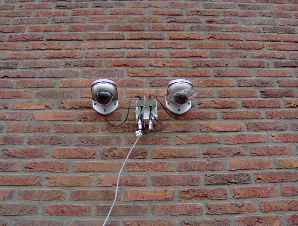

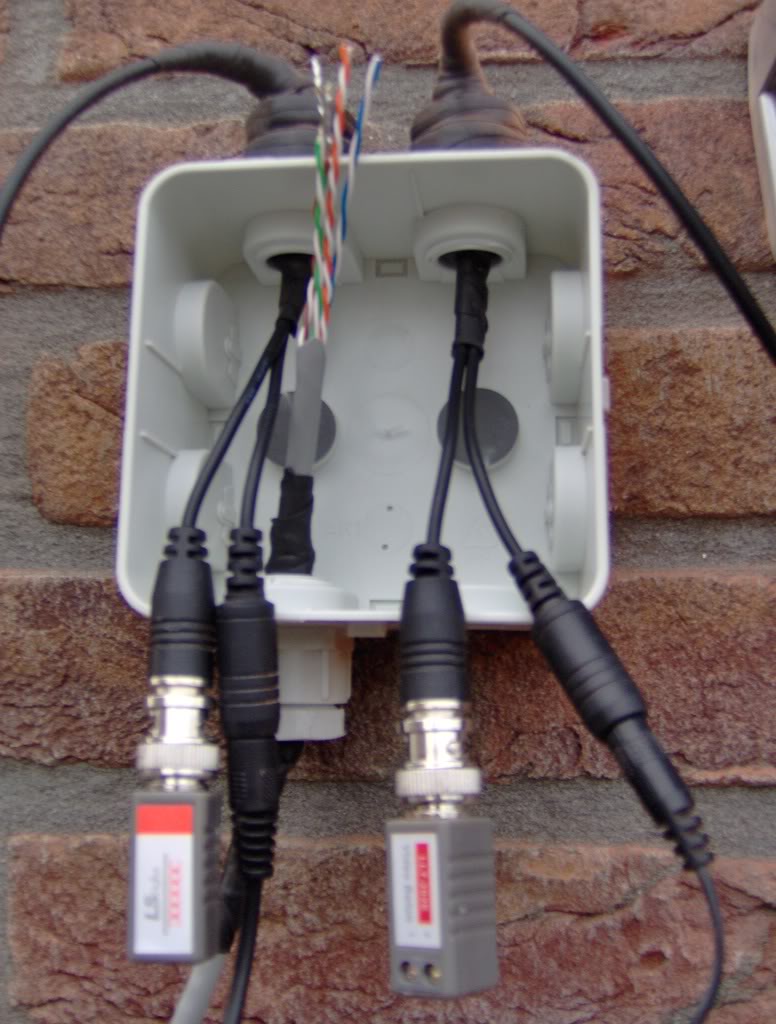

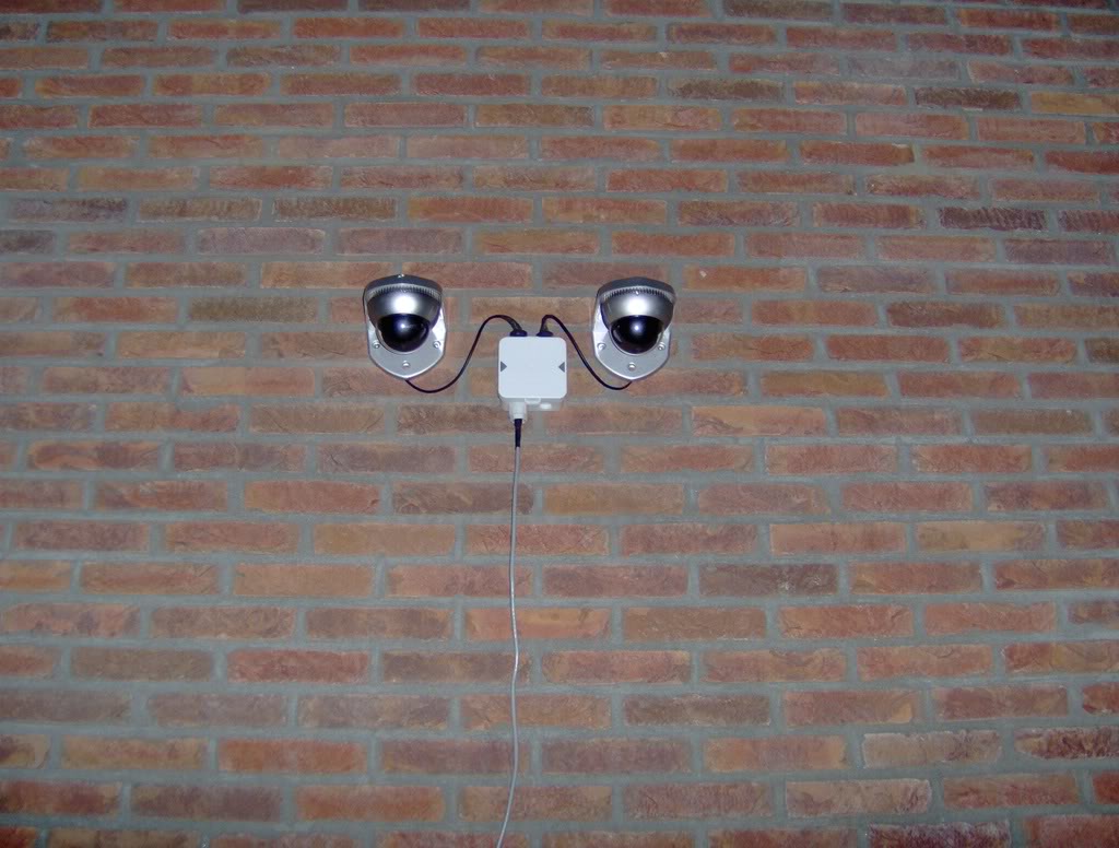

cocacola 0 Posted March 3, 2008 Ok, the Cat 6+baluns works great! Use one cat 6 cable 30 meters or 100 feet, for 2 new mid budget outdoor camera's, and run the power true them to! I specially like that green grass is not brown in the picture and red cars not orange, this camera's give a nice snappy picture, whit tru colors. tomorrow i whil upgrade the dvr whit a nice IR cam using a Siamese cable. I want u use this siamese coax cabel be corse of the power drain i read a lot of people have trouble whit @t cat 5/6 I will put a picture of this tomorrow to. I notice that the AVtech DVR is not that good whit online viewing, bad block picture...so i need a new budget DVR Wire plan for the two cams i installed today: Blue white for video cam 1 Orange white for video cam 2 Brown white twisted to gather for negative - Green white twisted to ether for positive + Now whit a 12 vlot 500mA power suppl. (upgrade it tomorrow to 13.8 v 2000mA power supl.) Great picture! [/b] Share this post Link to post Share on other sites
Lolo Wolf 0 Posted March 3, 2008 Noticed you didnt use outdoor rated Cat...might want to consider running some conduit up to that box as well (unless that is temp)...may want to use gel-filled connector in place of that screw block too, better contact, also good idea to use your side entry knockouts to your cams than the top....form a drip loop .... glad your cameras are working well for you. Share this post Link to post Share on other sites
cocacola 0 Posted March 3, 2008 Noticed you didnt use outdoor rated Cat...might want to consider running some conduit up to that box as well (unless that is temp)...may want to use gel-filled connector in place of that screw block too, better contact, also good idea to use your side entry knockouts to your cams than the top....form a drip loop .... glad your cameras are working well for you. Hi, Yes, a pipe is gonna be installed tomorrow The box is a 220volt outdoor type, but i have the special gel in case is see some "condense" than is will fill it up. Is a box like this ok you think? also good idea to use your side entry knockouts to your cams than the top.... Can you enplane what you meen? I am not that good in Englishes, i just don't get it form a drip loop Got it! Good idee! I Will do this, thanks for the tip! Share this post Link to post Share on other sites
Lolo Wolf 0 Posted March 3, 2008 Hello Cocacola, the box I see has no visible screw or threaded fit for cover...just curious is that cover snap fit? Does it have a gasket? Perhaps a channel or seal on the interior face plate? Any way if its rated outdoor as you say it should be OK. Using the side entry knockouts will keep water from collecting and pooling on top of your cable entry. (interesting.. on the rake of those joints tight to the brick) Regards Share this post Link to post Share on other sites
cocacola 0 Posted March 3, 2008 Hello Cocacola, the box I see has no visible screw or threaded fit for cover...just curious is that cover snap fit? Yes, (rubber gasket inside) Perhaps a channel or seal on the interior face plate? Any way if its rated outdoor as you say it should be OK. Using the side entry knockouts will keep water from collecting and pooling on top of your cable entry. (interesting.. on the rake of those joints tight to the brick) Regards The cable "knockouts" close them selfs whit a rubber ring wen i twisted it, so the cable knockouts seems to be air tight to. I have also special gel in case of... i will see i a week or two if its 100% weather prove. Can the baluns stand high or lower temperatures? like -8 or 50+ in the sun? I can ad a "heating" in the housing...? got a car side mirror heater some were here.. Share this post Link to post Share on other sites
Lolo Wolf 0 Posted March 3, 2008 sounds like you are good to go......wouldnt worry bout a heater for that... get that conduit in there and call it a day....good luck Share this post Link to post Share on other sites
