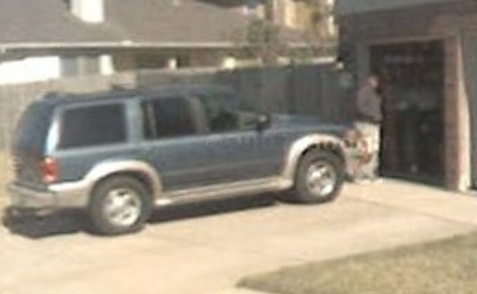

A funny bit of background you might enjoy. Last year I wanted to put in a system but my wife was not very supportive of the expenditure, so I set the notion aside. Last week I was looking on Google Maps Streetview and saw that they captured a picture of a person looking inside our garage, and then going into our garage. We have no idea who this person was and there were not any cars on the street. So needless to say, she is now onboard with having cameras.
Once the system lets me, I will post the picture.

Now that I have 5 posts, here are the pics mentioned above.
Who is this guy?

Also the picture you posted is that the picture you said you got off google? ..

Yes, the very first picture that I posted was from Google.
