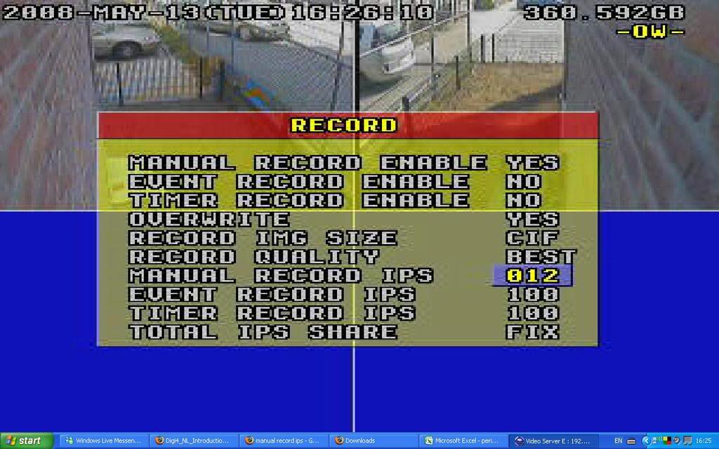

scorpion 0 Posted May 13, 2008 I cannot remember off of the top of my head. That should be the lowest setting. 12 is a PAL setting. Is this correct? I think you should change it to 100 if you want less of a "snapshot" look to your video. If you need to have a long "storage" time then pick a number in the middle range. If will give you less snapshots, and not fill up the hard drive as much. I think you are recording in CIF mode? Is this correct? The highest number for Frame Recording is 25. Would you prefer to use Motion Detection instead of recording 24/7? Share this post Link to post Share on other sites
cocacola 0 Posted May 13, 2008 I cannot remember off of the top of my head. That should be the lowest setting. 12 is a PAL setting. Is this correct? I think you should change it to 100 if you want less of a "snapshot" look to your video. If you need to have a long "storage" time then pick a number in the middle range. If will give you less snapshots, and not fill up the hard drive as much. I think you are recording in CIF mode? Is this correct? The highest number for Frame Recording is 25. Would you prefer to use Motion Detection instead of recording 24/7? Thanks for your awser my cctv friend! So for the best quallity i change cif in frame and put it on his max 25 Or is CIF better, i can put that on 100! Motion Detection... hmmm never try that before.. Share this post Link to post Share on other sites
rory 0 Posted May 13, 2008 CIF is the lowest quality (actually resolution). Change it to D1 or 4 CIF if it doesnt have D1. BEST should be the "best" actual quality setting, but if it goes to ULTRA or SUPER before it goes back to LOW then use one of those instead. Share this post Link to post Share on other sites
scorpion 0 Posted May 13, 2008 Lowest setting is Basic Normal High Best Highest setting Share this post Link to post Share on other sites
si_kungs 0 Posted May 14, 2008 try to change the record image size from "CIF" to "FPS". CIF: (common image format) 352x288 HD1: (2CIF) 720x288 D1: (4CIF) 720x480 i'm not sure which one will be the resolution after changing it but i know it will be a lot better. refer to the post of sir scorpion regarding the levels of record quality Share this post Link to post Share on other sites

scorpion 0 Posted May 14, 2008 (edited) I have my bags packed, and my tool box ready to go!! From Appendix #4 Page 53 of the Manual Record Mode.....Quality.....IPS.........500GB Record......Record day ......................................................Time (Hour)................................. _____________________________________________________________ Frame..............Best.........30................436.9..................18.2................ ......................................15................767.6....................32................. .......................................7.................1398....................58.2............... .......................................3.................2258.6.................94.1............... _____________________________________________________________ ......................High..........30................552.8....................23................. ......................................15................971.8...................40.5............... .......................................7................1768.9..................73.7............... .......................................3................2857.9.................119.1.............. _____________________________________________________________ .....................Normal.......30...............726.2....................30.3............... ......................................15................1276....................53.2............... .......................................7................2323.9..................96.8............... .......................................3................3754.5.................156.4.............. _____________________________________________________________ ......................Basic.........30................1173.5................156.4............... ......................................15................2062.2................. 85.9............... .......................................7.................3755.9................156.5............... .......................................3.................6068.1................252.8............... _____________________________________________________________ _____________________________________________________________ CIF.................Best.........120..............520.8...................21.7................ .......................................60...............915.1...................38.1................ .......................................30..............1666.7..................69.4................ .......................................15..............2692.7.................112.2............... _____________________________________________________________ .....................High...........120..............734.2...................30.6................ .......................................60...............1290....................53.8................ .......................................30..............2349.5..................97.9................ .......................................15..............3795.9.................158.2................ _____________________________________________________________ ...................Normal.........120.............966.2....................40.3................ .......................................60.............1697.6...................70.7................ .......................................30.............3091.8..................128.8............... .......................................15.............4995.2..................208.1............... _____________________________________________________________ ......................Basic..........120...........1338.7...................55.8................ ........................................60............2352.1....................98.................. ........................................30............4283.8..................178.5................ ........................................15.............6921....................288.4................ _____________________________________________________________ Edited May 14, 2008 by Guest Share this post Link to post Share on other sites

scorpion 0 Posted May 14, 2008 (edited) FPS recording qualty is better than CIF. but occupies more space. sir scorpion what do you use CIF of FPS? What do I personally use, or what do I set up for my customers? My customers are an Entry Level Based Clientle. They may not be able to afford a 500 GB Hard Drive. Most Times they want an 80GB HD based on price. I would really recommend a 250GB hard drive. What would I select? That is a hard one. I have to base it on each individual customer's needs. Do they need long term savings of video? Do they need to see good details (based on an entry level DVR). Will they look at the video on some kind of schedule, or when there is only a problem, or God forbid only after a tragedy such as stolen money, or product? I cannot answer your question, but the DVRs are set for CIF for the most part, and set at BEST. also changing this options can affect the internet transmission format? I really do not know! I am interested in this question. I ordered an a Nubix 4BC and I will try that out between some projects. This will be really interesting. My Customers never have asked about this, so I am caught off guard on this one. Edited May 14, 2008 by Guest Share this post Link to post Share on other sites

rory 0 Posted May 14, 2008 So looks like HIGH is the best quality on this DVR? Or they just didnt order them correctly? Share this post Link to post Share on other sites
si_kungs 0 Posted May 14, 2008 sir its best, high, normal, and basic. Share this post Link to post Share on other sites
rory 0 Posted May 14, 2008 sir its best, high, normal, and basic. yeah but mine has basic, normal, best, high ... Share this post Link to post Share on other sites
davec 0 Posted May 14, 2008 I have my avtech avc 760 set to frame rather than cif. The recorded video is 720 x 480 rather than 352 x 200 for cif. The recorded frame rate can only record 30 fps divided by the number of cameras up to the 4. about 7.5 fps. It seems to be plenty good for what I need. Dave Share this post Link to post Share on other sites
