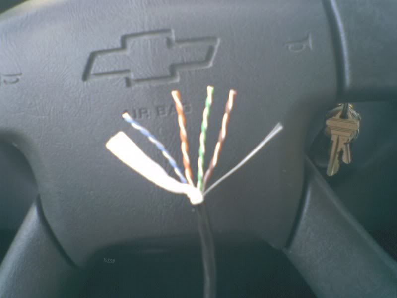

C7 in CA 0 Posted May 22, 2008 Flooded is a good idea. The outdoor CAT5e I'm using has a flat strip of material in the jacket coated in a gritty powder. It doesn't gel until water hits it. That makes it a lot cleaner and faster to terminate. This stuff is Genesis brand. But others may have a similar product. Sorry the picture is blurry. (cellphone picture) But the white blur on the left is the dry gel stuff. When you strip the jacket off this is wrapped around the conductors. In this picture it is pulled to the side and ready to be cut off... Much easier then wiping the gel off. Share this post Link to post Share on other sites
