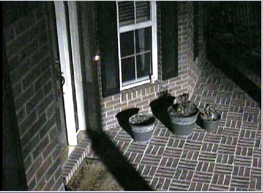

leigh 0 Posted June 13, 2008 The model is HTINTD8. I have seen specotech's ads on the Security Products and suspect their quality of image. Cause they show a quite perfect image in darkness compared with common cameras with IR LEDs. Never use this product before. If anyone have used? Also intersted in your opinions. Share this post Link to post Share on other sites
crirvine 0 Posted June 13, 2008 I am confused I have 30 in the field right now with no problems. My customers are very happy with this product. I tested them in our office for 1 month before putting any in the field. I have no problem seeing the grass in the yard as green in little light (moon light) I see cats walking around the building in real time not delayed or frozen. I am not sure where you bought your cameras from but I do not have the same probems you are listing here. Share this post Link to post Share on other sites
wisp_engineer 0 Posted June 14, 2008 I am confused I have 30 in the field right now with no problems. My customers are very happy with this product. I tested them in our office for 1 month before putting any in the field. I have no problem seeing the grass in the yard as green in little light (moon light) I see cats walking around the building in real time not delayed or frozen. I am not sure where you bought your cameras from but I do not have the same probems you are listing here. Can you post some pics? Perhaps a capture of someone walking in low light? Share this post Link to post Share on other sites
3RDIGLBL 0 Posted June 19, 2008 I am confused I have 30 in the field right now with no problems. My customers are very happy with this product. I tested them in our office for 1 month before putting any in the field. I have no problem seeing the grass in the yard as green in little light (moon light) I see cats walking around the building in real time not delayed or frozen. I am not sure where you bought your cameras from but I do not have the same probems you are listing here. I'd be interested in your setup if you are having a great experience with them. Is your color setting on Auto or set to Color? How about your Sense Up settings X2, X4, X8? AGC? What lense type are you using, I have tried a number of lense but lately have been using Fujinon lenses primarily the D/N lenses with these cameras. Keep in mind I use the CPH4000 model from CCTVImports which is identical to the Speco intensifier model. I have a tough time to get an outstanding image considering it is High Res and I find that these cameras do not handle bright clear sky days to well. If I adjust the camera so it looks good during the day then it will not look good at night so I find the camera to be a catch 22 but if you are having great success maybe I am missing something in the settings to get such a good picture. Thanks Share this post Link to post Share on other sites
