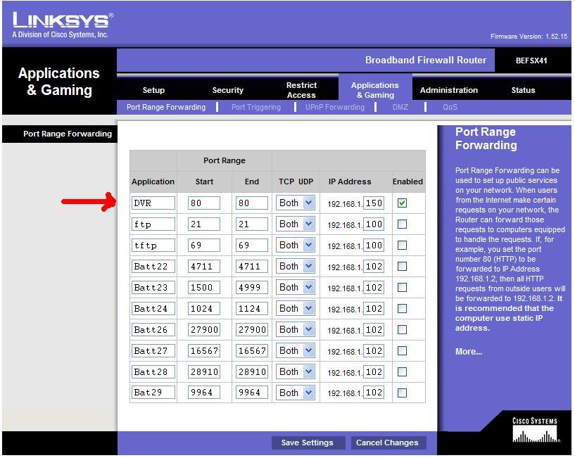

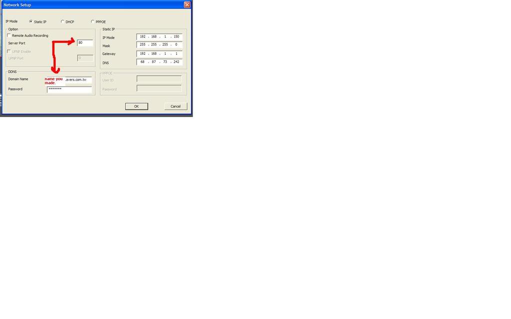

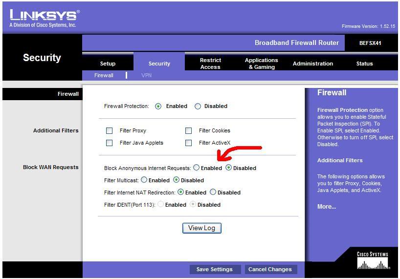

dopalgangr 1 Posted June 15, 2008 Heres what I did to make mine work (NO DMZ NEEDED) oh and by the way I have Vonage for my phone which sat in front of my router then handed off access to my router, I moved it behind my firewall: On the DVR make sure the name you created on the Avers website is in there correctly with the password that you used on the site, not the DVR's password. Small picture but also ensure that the port is 80. The directions say that you have to restart the DVR after you make this change as well. It should look like this: On your router make sure the "Block anonymous internet requests is disabled" this was my problem.. For the forwarding make sure it looks like this and is being forwarded to the static ip address that you assigned to your DVR: Hope this fixes your issue.. Share this post Link to post Share on other sites
