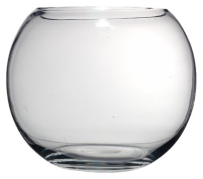

How about using a clear fish bowl or a vase?
Seriously, buy a dome from a cctv supplier, if that's what you want. Why try to reinvent the wheel?
