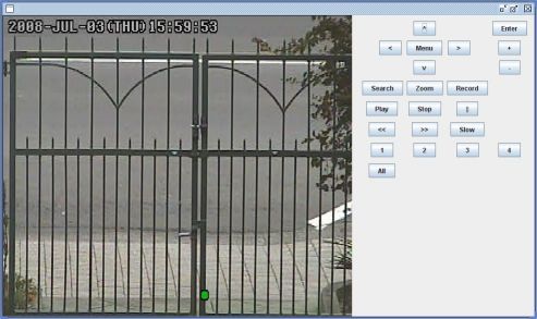

Kiwi 0 Posted July 1, 2008 This app is super-handy for quickly checking live cameras without keeping the old Video Server-E running in the task bar. On a LAN it comes up with working video in less than a second or two of being started. On a PC the aspect ratio comes out slightly wrong. Video Server E gives 1.400 or 641 x 458 while CCTV_JAR shows 1.157 or 641 x 554. Is there a way to correct this? Also, the video quality level appears to be on "medium." Again, can this be easily changed? TIA Share this post Link to post Share on other sites

Steve Evans 0 Posted July 2, 2008 This app is super-handy for quickly checking live cameras without keeping the old Video Server-E running in the task bar. On a LAN it comes up with working video in less than a second or two of being started. On a PC the aspect ratio comes out slightly wrong. Video Server E gives 1.400 or 641 x 458 while CCTV_JAR shows 1.157 or 641 x 554. Is there a way to correct this? Also, the video quality level appears to be on "medium." Again, can this be easily changed? TIA The code wasn't setting the quality so I guess I've been lucky to be getting high, so I've made a change to force this to High, and I'll get this change released soon. As for the aspect ratio I've been very care to use the same 640x552 panel size as in the java applet. I just tried an aspect ratio of 1.4 and it looked like somebody had trodden on my car!!!!! Thanks for the feedback. Steve Share this post Link to post Share on other sites

Steve Evans 0 Posted July 3, 2008 From the shape of the green "live" dot, I can see that the aspect ratio should be wider with your system. This is most odd as with an AVC761 I get round green dots with my application, not horizontally squished ones. The 782 is a model 1 with MPEG4 at frame resolution, whereas the 761 is a model 4 and MJPEG at frame. From the manual: Frame: 720 × 480 pixels〈NTSC〉/ 720 × 576 pixels PAL〉 CIF: 352 × 240 pixels〈NTSC〉/ 352 × 288 pixels〈PAL〉 I'm using a PAL system with a pixel ratio of 1.25:1 Kiwi is, I guess, using NeverTwicetheSameColor with a pixel ratio of 1.5:1 Now, of course I don't expect these pixels to necessarily be square, but this could go some way to explain the differences seen. I'll look into this further. Steve Share this post Link to post Share on other sites
Steve Evans 0 Posted July 3, 2008 Hi Kiwi, Looking at the problem of aspect ratio I've had to dig deeper into the applet code on which this application is based. I've modified it so that the image aspect ratio is determined by that of the received images rather than by the fixed 642x554 ratio previously in use. The images returned by my ACV761 are 640x276 - so much for frame resolution of 720x576. No, the 276 isn't a mistake! This is clearly crude de-interlacing by requiring upscaling to 640x552! PM me with your email address and I'll send you a version to try that will hopefully preserve the aspect ratio. If it works for you I'll post it back for wider use. Cheers, Steve Share this post Link to post Share on other sites
