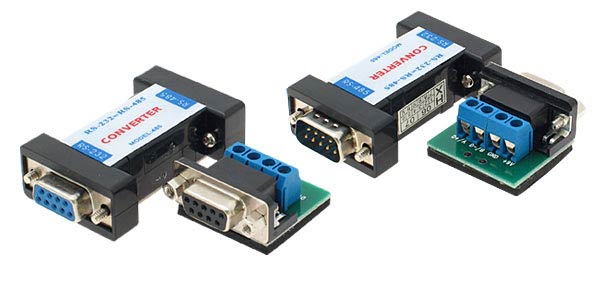

Im wondering if Ive done this wrong.. I bought this adapter. Will it work, or do I need a Geo GV-net card.
If I need a gv-net card wheres a good place to get one cheap.
