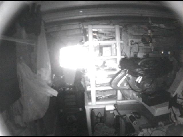

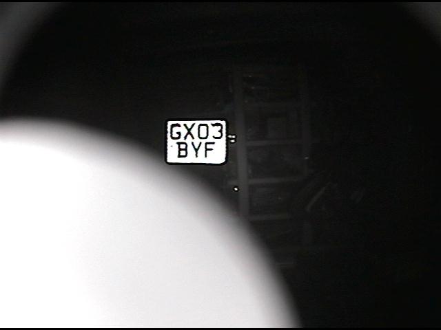

Test using an Sony HAD 1/3 NSTC IR camera and reflective number/licence plate
Picture 1 before,
picture 2 finger just placed over the edge of the lense, unfortunately unable to stand there all night
I'd say that your finger is being seen by the camera as a large bright object, so the camera isn't applying a lot of gain and so the number plate isn't clipped.
In the scene without your finger the number plate is a smaller portion of the scene but the brightest part. The camera applies gain so you see the dark areas but allows the highlights to clip so you can't see the number plate.
Try bringing the number plate closer. It'll probably do the same thing as your finger if you get it close enough.
