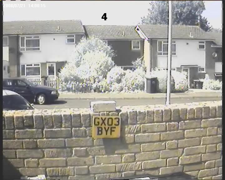

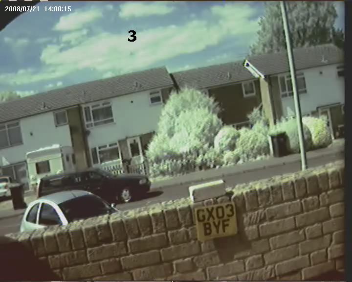

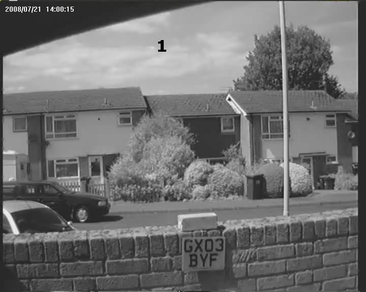

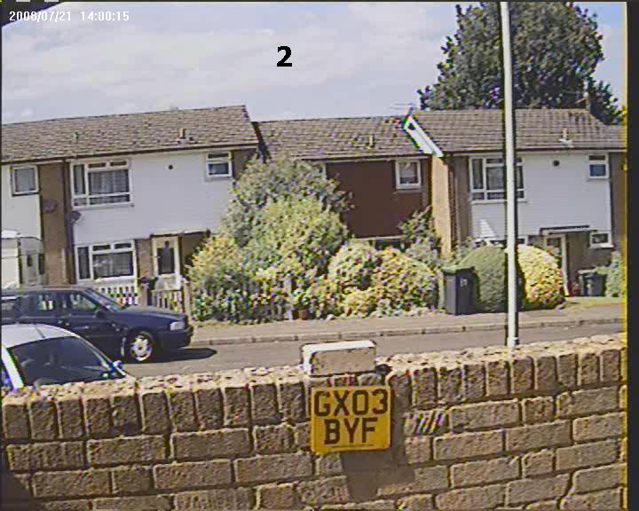

I have many different quality cameras and here are the basic specs of 4
a. 1/3 ccd noname
b. 1/3 ccd sharp
c. 1/3 cmos
d. 1/3 ccd sony exview had
I would value your opinion on which pictures you think are the best quality
i.e. 3, 2, 1, 4
see also if you can tie the picture with the right camera i.e. 4a, 3b etc
1: A, that was 1/3" LG CCD, B/W camera
2:D, 1/3" Sony EX-VIEW
3:C, CMOS
4: B, Sharp, color changed, always sharp and also this was IR camera
2: D, 1/3" Sony EX-VIEW
3: C, CMOS
Well done you are good.
To set a fair comparision, the camera boards were mounted next to each other fitted with a vari focal 4-8mm lens set at about 7mm utilising the same power supply (split) and the same length of cable going to the DVR so a image could be taken on all at the same time (or within 25 FPS).
Picture number 4 seemed to be odd because of the lightness. As mentioned by Kifertech, this would normally be caused by reflected IR, but in this case impossble as only the boards were used and during the day. When removing the vari focal lens I noticed the Inner lens was covered with little white specks which would only come off with methalated spirit, must have occured during the manufacturing process.

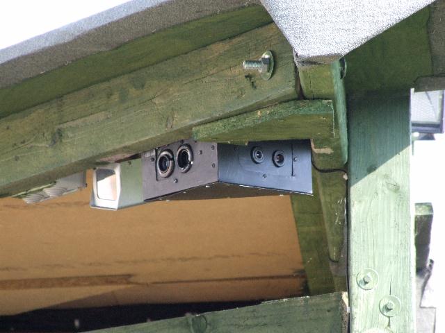

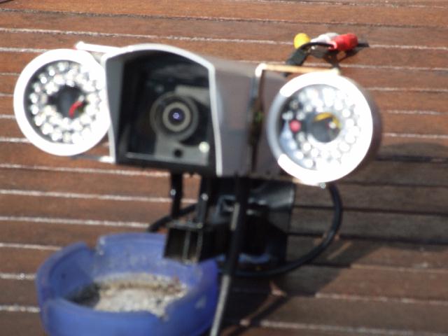

I then make my own style cases to suit my needs keeping the cameras covert (pic 1). I have also brought dummy cameras on Ebay for a few pounds and fitted the lens board with a wireless transmitter inside to make a perfectly good working camera.

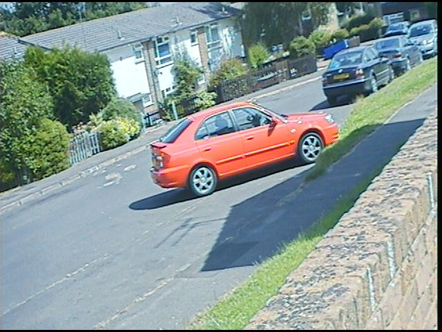

well I am pretty impressed with the Honeywell HCGWD48X Hi Res Wide Dynamic cameras
picture 1 Honeywell
picture 2 Sony Exview
You have many different quality cameras and here all suck
Sorry mate, cam 1 is still the best you got.

What chip is being used on the Honeywell? Pics look good, maybe a little sharper on the focus, and the #2 looks like the iris is a little to open and out of focus, nice info on the board camera's Thanks
Sony CXD3150AR
