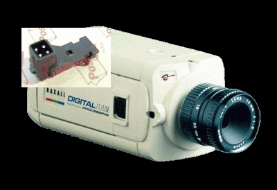

auto iris cable direct drive (DD) socket
Does anyone know where I can get the Direct drive (DD) socket from (fitted on side of camera), or even an auto iris cable extention lead (if they exist). I can get the plug part easily.
I have searched Radio shack, but maybe they are called something different in the states.
Please clarify what you want. Do you want the plug that attaches to the lens cable or the socket that is part of the camera?
Sorry, I can't find it through any of my connections (no pun intended). I suggest contacting a CCTV camera manufacturer for specs.
This connector is known as a Kobicon on Digikey, Mouser, and other industrial electronics suppliers in the US. I've never seen it used for anything other than camera iris control.
