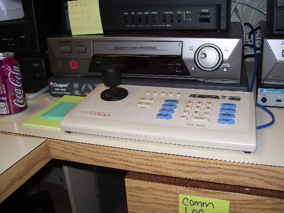

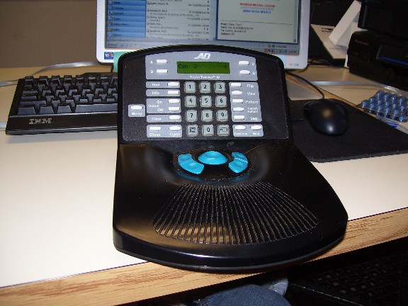

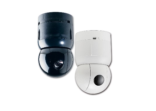

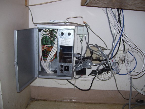

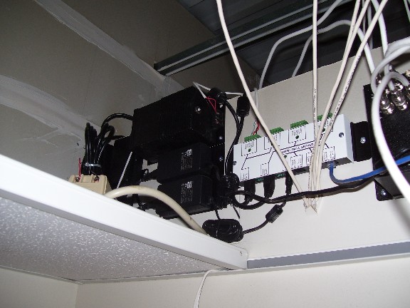

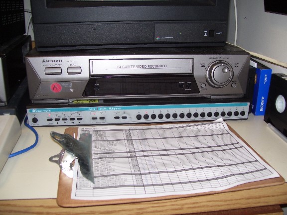

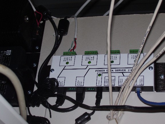

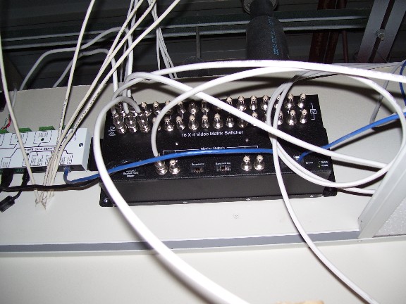

Hey guys, sorry, i've been so busy lately. here is the current list of hardware I have....
Sensormatic MUX (RV2216)
Sensormatic Controller (ADTT16E)
Sensormatic J-Box (unknown model number)
Sensormatic PTZ's x5 (SpeedDome Ultra VII)
Checkpoint Controller (Unknown Model Number)
Checkpoint 16x4 Video Matrix Switcher (Unknown Model Number)
Checkpoint Power Data Server 2x4 (Unknown Model Number)
Checkpoint Power Supplies (Unknown Model numbers)
So thats what I got. Again, was just wondering if the sensormatic PTZ's can be moved to the Checkpoint system and what additional hardware I will need to do so. I think at the very least I will need another PDLE and a few more power supplies.
Again, thanks in advance for the help guys and thank you again Levon for the great assistance thus far!
I hope we are able to get this figured out and that I am able the get this system set up before the new DVR install but that may not happen, I'm a pretty busy guy.
Let me know what you think. Thanks again guys!
Please find some my observations below:
Nothing special here.. standard Sensormatic Mux. From what I see, all it does is takes incoming video signals, multiplexes them and then uses a very good VCR from Mitsibushi... that is all here. I do not think that this Mux is playing any role to control your Sensormatic domes, rather it is the function of the touchtracker.
This is the unit that controls your Sensormatic domes. This touchtracker can control up to sixteen domes and you can have the domes data truncated from one to the next. Again, nothing special..
This looks like Sensormatic six position J-Box.. the probable model is RJ6SN
These domes look like the Ultra VII.. Most likely the connection to them is via S-Net protocol (Since ADTT16E touchtracker works with this protocol unless it has change to RS485, which is very unlikely.
I also can not identify by the picture... Need to talk to Checkpoint
I also can not identify by the picture... Need to talk to Checkpoint... It looks like their smallest size 16 channel matrix switch, but can not put my finger on which model yet.
I also can not identify by the picture... Need to talk to Checkpoint... This is one of their many data distribution boxes.. It would have helped to know which one, as it will tell us which protocol it uses to establish communication with the domes.
I also can not identify by the picture... Need to talk to Checkpoint.. but from what I see, it could be one of their standard dome power supplies capable to handle the power for multiple domes... but can not identify which one.

Also, the photo of the power supplies, there are two (24v I believe), one of them supplies power to two PTZ's, so with the Power/Data server, I think I can connect up to 4 PTZ's. So to connect all 6 PTZ's to checkpoint, I'm sure I will need an additional Power/Data server and also at least one more power supply.
