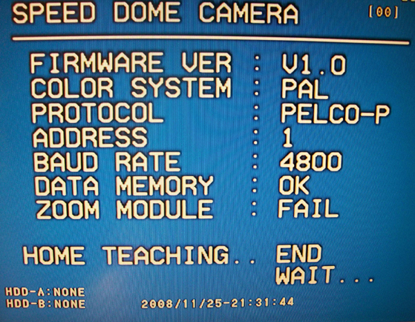

I have been using a 10x Mini Speed dome for the last few days without any problems, I can zoom, pan and tilt using the DVR recorder or the remote control.
Quite impressive pictures also..
Normally when you power the dome on, it first goes through this blue screen of checks which lasts about a minute and finishes with the camera panning around the room to learn its positioning then the lens moves back to the parked position.
But this morning I turned on the system and found that the PTZ power on test screen is showing the "Zoom module" test as FAIL
This had previously been showing as "OK"

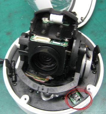

Here is a picture of the camera when opened: (the red circle just shows the resistor for positioning)
My main problem is that once the "Zoom module" is listed as FAIL, the test moves on to the home teaching part, the camera moves around the room and comes back to its resting position then the camera just powers off.
I thought it might be a glitch so I turned on a second dome I had in the shop and to my surprize I found this second camera also fails at the "Zoom Module" check and powers itself off also.
The camera was working, I have not changed anything other than powering it off yesterday same as every other day..
Any ideas how to fix this, i would be most grateful to anyone that may be able to help me out with this..

I dont see a "TX Connection" or "Cam COMM" in the power-on (menu) diagnostic? From your picture I assume that the ZOOM Module is the communication test. Since both cams failed I would start checking your terminations/RS-control at the DVR-controller. Ive used quite a lot of Mini 10x PTZs and avoid turning them on and off unless need to reboot for a diagnostic or power failure. Seems that you may have a comm faut in the hardwire connection did you use the same control method-hardware when you tested the second PTZ? If so I would revisit the connections-wire. Also check that the voltage level is within the spec. sometimes that can cause abnormal cam operation and status. Good Luck- Regards
