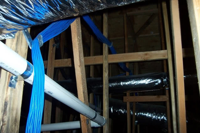

scorpion 0 Posted January 28, 2009 CADDY is great for solving ceiling wire runs. All you do is clamp, and go! Cat Links http://www.erico.com/products/CADDY_CAT_LINKS.asp Cat Links PDF http://www.erico.com/public/library/Fixing/LT1438.pdf Scroll down to CAT 12 Hangers http://www.hometech.com/techwire/wiremgmt.html#SU-66145 Share this post Link to post Share on other sites
3RDIGLBL 0 Posted January 29, 2009 CADDY is great for solving ceiling wire runs. All you do is clamp, and go! Cat Links http://www.erico.com/products/CADDY_CAT_LINKS.asp Cat Links PDF http://www.erico.com/public/library/Fixing/LT1438.pdf Scroll down to CAT 12 Hangers http://www.hometech.com/techwire/wiremgmt.html#SU-66145 Man I could have used this on my last job. The bundle of cable I had going through rafters and such were huge and a real pain in the @$$. Thanks for links for this stuff scorpion. This doesn't really help me for the small single cable or maybe two that I have to run on top of the drop ceiling though. When it's just a small business who doesn't want to pay much for a CCTV install I've just been running the single cable or two directly on top of the drop ceiling. I figure if electricians can run their cables directly on top (YA see this all the time!) then it's ok for me to do it Code says this is a big no no though and definitely a no no with electrical cable.... I assume that this is pretty much the norm with most of you then. Run the Siamese cable directly on top of the drop ceiling, especially for a small job with a few cameras seems to be the norm? Share this post Link to post Share on other sites

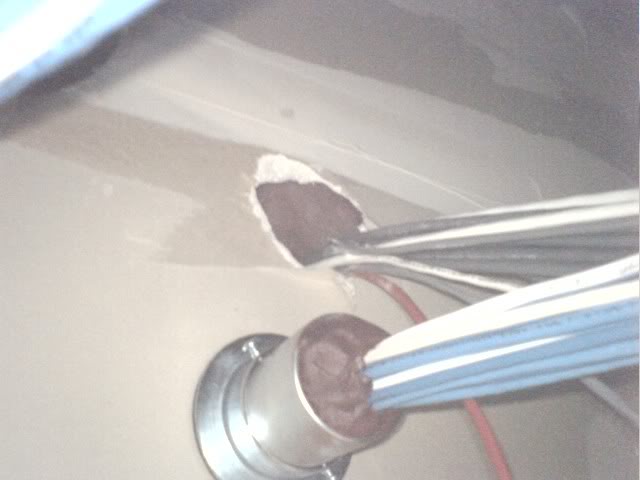

3RDIGLBL 0 Posted January 30, 2009 Have you ever used these? FIRES STOP http://www.uniquefirestop.com/smooth.htm Home Page http://www.uniquefirestop.com/products.htm Intructions: http://www.uniquefirestop.com/smooth3.htm No but I have quoted out a job that was to use these. It was a car dealership where they wanted to have cameras in the service garage bays. I selected these as the device to use in order to get the cables from one side of the firewall to the other. They look to be pretty good and provide a very professional means of getting through the firewall. They look easy to use as well. ------------------- So ya I do know what the code says and I do understand the need for safety. What I am saying is if we were to follow the code all the time (which we should) then the cost of doing install really goes up due to the all the added time following the code. Actually using the wire supports of the drop ceiling grid as support for wires is also against code (thought I'd throw that in). Following the code like this really makes useless all the wire fish rods and such for getting wire across a drop ceiling. One would have to pop each tile in order to support the cable (adding time), also install hardware to support the cable (time and cost)......in the end it could really add up and make or break a deal. If your competitor goes in and bids much lower than you and he doesn't follow code then it's hard to justify to this customer why your cost estimate is much higher....you're doing the right thing and lose work because of it. No wonder so many including the big guys never follow the code, or seldom do anyhow. Share this post Link to post Share on other sites

C7 in CA 0 Posted February 3, 2009 I wouldn't want my cables laying on top of the ceiling grid if it ever came crashing down. Sounds like a pretty big liability to me. I run my cables up high. I don't want anybody walking on them or having to crawl through them. I'm 6'4 and can walk under these cables LoL! look at that fire alarm cable penetrate this firewall. Guess which cables we installed? I put in a fair bid to fix that with a split sleeve penetrator but never heard back... Share this post Link to post Share on other sites
