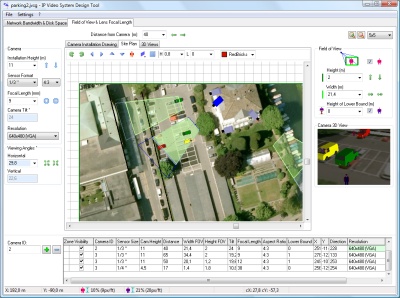

3RDIGLBL 0 Posted May 13, 2009 Answering the first question.To find the optimal quantity of cameras I recommend to use JVSG cctv modeling software. You can draw a site plan, put cameras and find to optimal quantity of cameras and their positions. Have a look on the picture: Software seems to be very useful. A couple questions regarding object size calculation to determine whether identification will be possible. Does it take into account the camera resolution? Using a 3 megapixel camera with a 6mm lens you may be able to get identification from a long distance where a 530TVL analog camera will not. Wondering if this software can help the selling feature of megapixel versus analog. It's in the amount of pixels present in the video which will determine if identification is possible. Don't mean to threadjack, maybe this belongs in another thread but I saw it here so be it Thanks. Share this post Link to post Share on other sites
