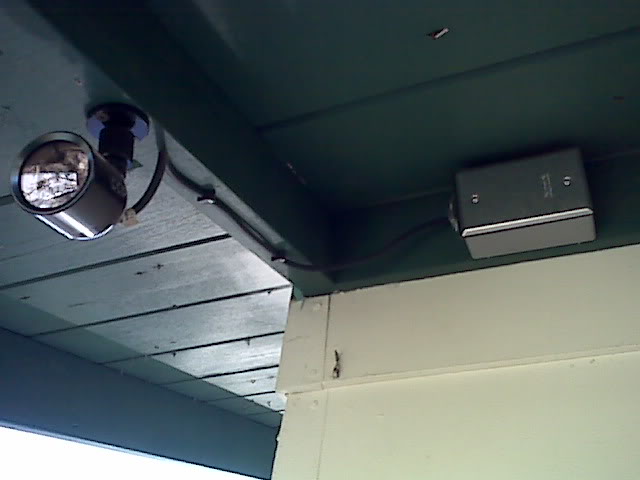

How about being the envy of all your buddies and do it like this :
Foam rod and caulk could work. Usually for holes in wood siding and what not we just use paintable caulk. Be sure it is paintable otherwise the paint won't adhere to it should the homeowner decide to paint it.
Like C7 said though, using an outdoor rated outlet box with a gasketed cover is the way to do it. You can even install a gland nut on the knockout where you run the cable through to make sure it is sealed tight.
