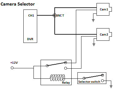

Scruit 0 Posted March 29, 2009 I would like to have two cameras attached to the same channel on my DVR, and I'd like for the system to automatically switch between the two channels. The scenario is the rear-facing camera on my dashcam setup. For the thrid time now, while the car was being worked on at a dealership a tech was examining the camera system that is behind a false panel in my trunk. The rear-facing camera is mounted to the towbar. All I caught was their ankles and they were discussing how the system worked and wondering if I was a hidden camera TV show or something. This got me thinking about if someone breaks into my trunk - the camera system will turn on automatically but I'll only catch their feet from the towbar mounted camera. It'd be great to get a face shot (bearing in mind I still have to deal with dark subject/light background etc). So, I'd like to install a second camera inside the trunk that would see someone who enters the trunk. I'd like the trunk cam and towbar cam to share the same channel on the DVR. Normally I want the towbar cam to be active, but when the trunk opens I want the trunk cam to be active instead. Here's a simple circuit I was thinking of: I know this might make the DVR see a VLOSS as the cam switches over, but I can live with that. So, would this work? Would it blow my DVR up? Share this post Link to post Share on other sites
C7 in CA 0 Posted March 29, 2009 Good idea. The DVR should be ok as long as you only have 1 feed at a time going into the port. I'd be more concerned with sending 1 video feed into another camera. I don't know if it's damaging or not, but it would be better if you could switch the video too. Share this post Link to post Share on other sites

cachecreekcctv 0 Posted April 9, 2009 Hey Scruit, you could do this easily with an "ice cube" relay that has a 12vdc coil. You could use the trunk switch (which normally turns on a light) to also activate the coil of the relay. Just have the positive (+DC) go into the "common" side of one of the contact points. Use the "normally open" set of contacts to fire the trunk cam. When the trunk opens, the relay coil would fire, then close the N.O. set, away from the N.C. set, which would then open . I do this exact same sort of setup, I just have a photocell which controls the "ice cube" relay, in order to switch between B/W and Color cams. Share this post Link to post Share on other sites
zmxtech 0 Posted April 10, 2009 that's a really bad way of switching the cameras -it will work tho. A better way is to have the cameras powered up and switch the video. via a relay etc. [sPST $5 at any electronics store] but remember if they break into your car they might leave the trunk open which will be no good when there in the front. A small microwave motion detector in the trunk would fix this. [hooked to your video switch relay] z Share this post Link to post Share on other sites
Scruit 0 Posted April 11, 2009 I'll give it a shot today. I'm changing the circuit do that the relay switches the center wire of the coax instead of the power. Both cameras would be powered up up all the time and the ground (the outer braiding of the coax) for the two inputs and the one output will be connected together. If this works out then I have a few different places I could use this. Share this post Link to post Share on other sites
Scruit 0 Posted April 21, 2009 Finally got it put together. It's a very simple circuit, just lie the diagram above only it switches the center connector of the coax instead of the + wire of the power. It works great. I'll have to use this in other places too... Maybe my front-port camera can swtich to a close-up face image based upon a motion sensor... Hmmm... Share this post Link to post Share on other sites
