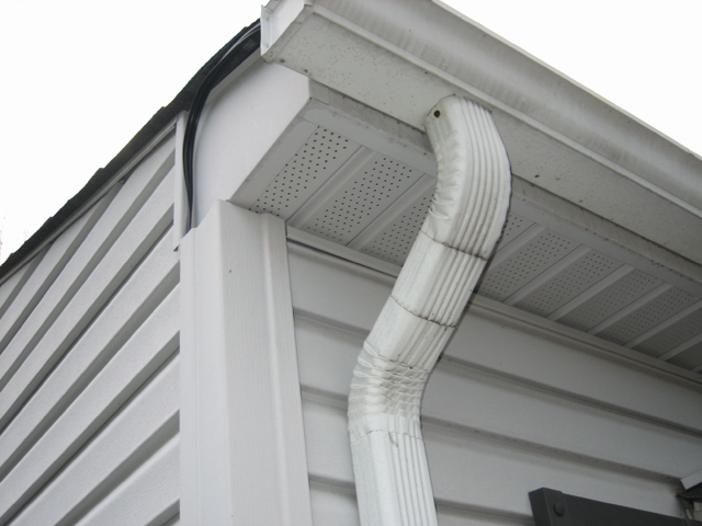

Here is what my eave looks like:
Those panels will pop out, and you can see what is up there.

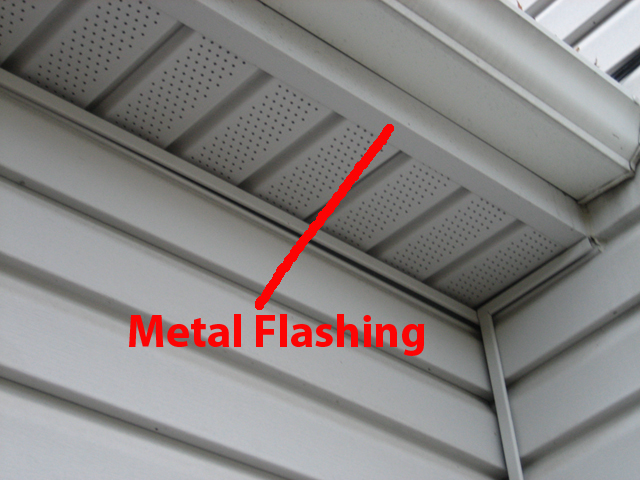

Under your gutter I am going to guess that there is metal flashing that is L shaped, and the soffit sits on top of this, and it may be stapled in to the trusses.
Find some nails on the flashing, and remove them. You will need to go one nail past where you will be working to the left, and to the right.
Take your hands with one with palms up, and one with palms down, and curl your fingers, and then interlock them. This is how the soffits are connected together.
When you have the flashing removed then you can slide the soffit away from the house.
You can also man handle them since they are plastic, and you can force them out.
hey scorpion, you are correct, there is an L shaped metal flashing, but i do not see any nails on it that i can remove. perhaps the fasteners are behind the gutter?
i dont wanna remove my gutter
sometimes they put them in with metal clips above/in the attic and leave one out every 4-6 feet. then only one will pop out and you reach in and take the clip out and take out the next one and so on.
thank you for the suggestion. i will get on my ladder and take a look at that this weekend
On some styles I can just grab the flashing, and bend them towards the ground, and pull the soffit out. It can be a bear trying to get the soffit back in as you have to hold the flashing down while you try to shove the soffit back in.
