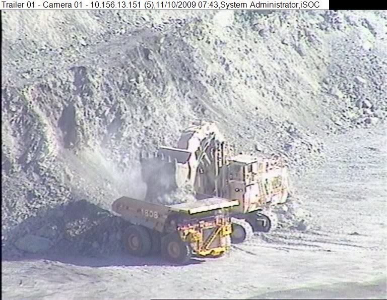

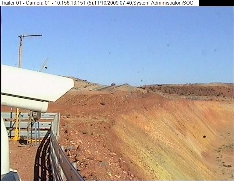

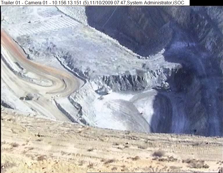

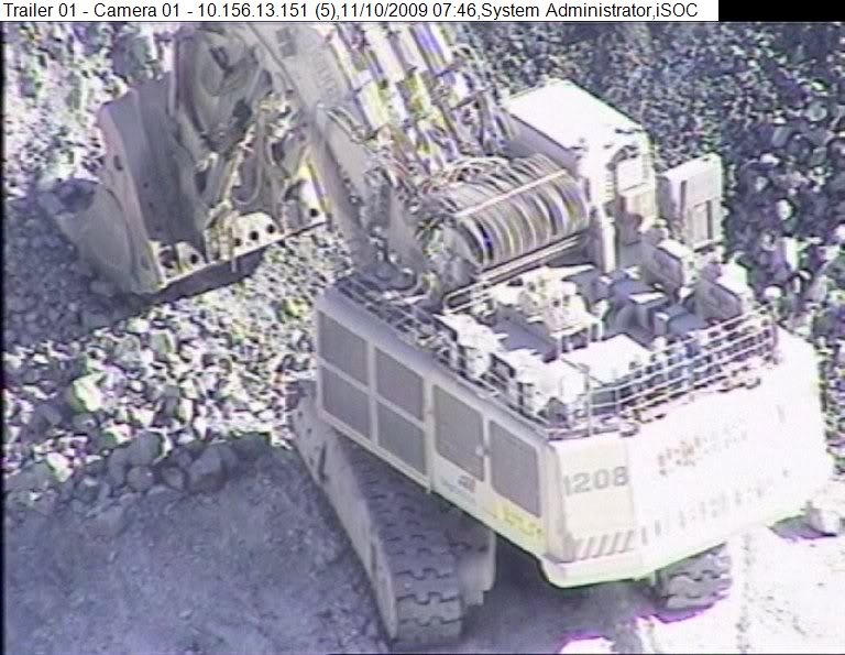

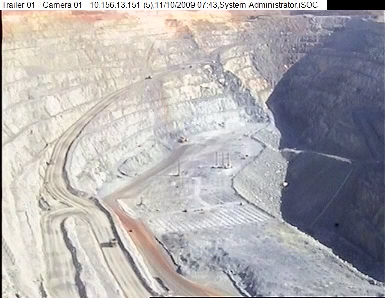

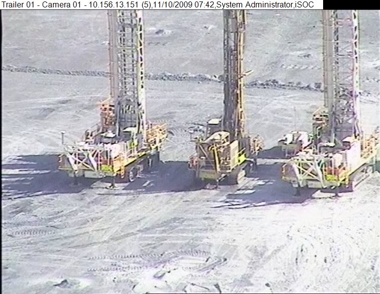

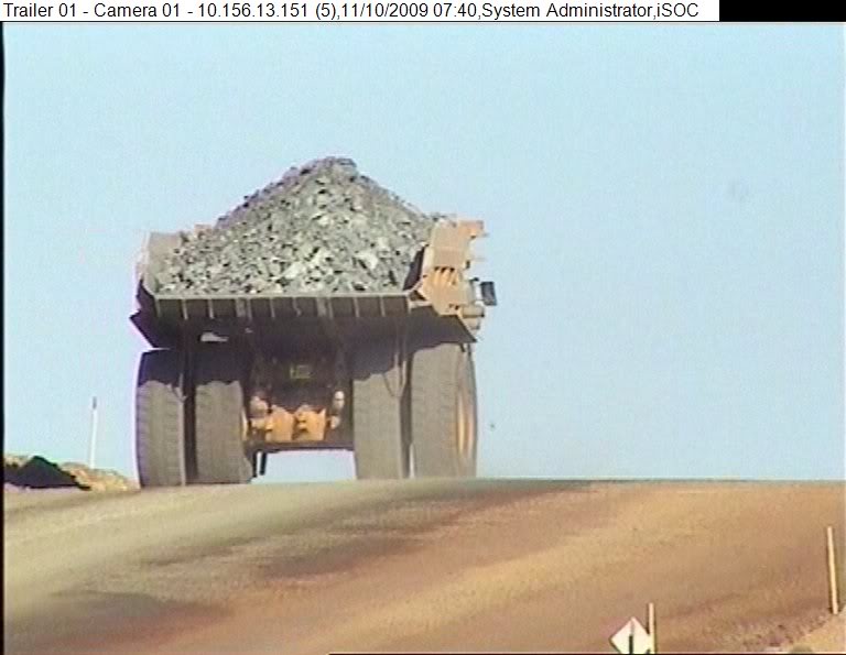

woodyads 0 Posted October 11, 2009 We use the Avenir HZDG 12240P lens, its a 12~240mm lens we typically look at trucks 500 to 2000 meters away. Thanks to zmxtech for the lens calc. According to this at 200ft a 4ft wide view would need a 246mm lens. The Axis 233d has a 119mm lens. I haven't found any all in one cameras that have a lens anything like 200mm. The HZDG 12240P lenses is about $2000 AUD. We just manage to fit one of these lenses into a Pelco Esprite but it is a tight fit. We make some physical mods to the lense and housing. And we are currently modifying an Esprite to support a megapixel IP camera. I will let you know how it goes. Mods to the Esprite include adding a Mil-Spec plug to the bottom to make them plug and play. Convert the power supply to make it solar friendly. Re-route the serial cables so the serial data comes from the camera. And replace the serial interface from the input to support IP to the camera including PoE. Here are some photo's unfortunately I couldn't find anything at 200m worth focusing on apart from piles of dirt so these photos are at least 500m away. Camera res is only 800x600, very dusty environment so all the trucks and equipment are covered in dust and are as dull as the photo's look. It is also very hot and deep so there are laminates of different air temperatures that bend the light coming to the cameras. So here are a bunch of near and far shots with a 240mm lens In the first two photo's the truck is 616m away, I have live feedback of GPS of all the equipment so I can accurately calculate the distance to the meter In these 3 photos the shove is 1364m away and 285m deep. The drills are 858m at 285m deep. The last shovel is only 510m away and 285m deep. The closeup is a bit blured as the capture snapped between two frames. Share this post Link to post Share on other sites

woodyads 0 Posted October 11, 2009 Ikegami ICD-808P they are 4 years old. These use the HZCG 12240 lens. We pipe them into 7501EXT DVTel encoders at the source. We are moving to the DVTel DVT9580A camera. It uses the HZDC12240 direct drive version of the lense. It should be a lot better as its direct digital to IP. Removes the need for an encoder and is 1280 x 1024. We have bench tested the camera and lense, done a proof of concept on converting the Esprite to IP but are yet to field test the final package. I did ask my distributer to look for a better lense but he couldn't come back with anything that would fit in a housing. Since then I have come up with some bigger housings to fit the Esprite but the modification is pretty heavy. At the end of the day my image quality will always be hamstrung by distance. The further away the more atmospheric disturbance and the more dust. So moving the cameras closer to the action is the solution I have now solved with mobile comms trailers Link to photo's of comms trailers http://www.cctvforum.com/viewtopic.php?t=17803&highlight= Share this post Link to post Share on other sites

woodyads 0 Posted October 11, 2009 I don't care too much about frames, I am not watching a movie. Most of the time when we play things back its at fast motion anyway. We use it for replaying safety incidences. Understandable that you would care if you were in a casio and you where watching for slight of hand. What we want is to be able to see the number on the truck. We currently run with a throttle of 1000KB/s which is about 5 frames per second. This give us 12 days of recording and keeps bandwith low. DVTel had a very good NVR security model that let me share out to many uses in different groups and group my cameras and control PTZ access to different groups. Its security model now isn't that crash hot, but since the system I put in 4 years ago has done well I will stick to it until I change the whole setup. Share this post Link to post Share on other sites

woodyads 0 Posted October 11, 2009 Its a not too much of a problem. Every now and then you can face them up during a storm but we go 6 months without rain. So you just wear the dirt and clean them once ot twice a year. Now we tend to mount them on the hand rails of trailers with working platforms or on ground based frames so they are easy to service. We are yet to stick one on the telescopic masts and they were bought with that in mind as an option. We have three 15m air powered telescopic masts that can handle a head weight of 45kg. However we worked out that it is important to hold the camera as still as possible when looking long distances. Masts cost about $17k each. I guess the vehicles we are looking at are dirty in the first place so it hides it pretty well. All the stills were taken from the same camera and only on one is it obvious the PTZ cover has lots of dirt on it. Still it would be nice to clean them a bit more often Share this post Link to post Share on other sites
