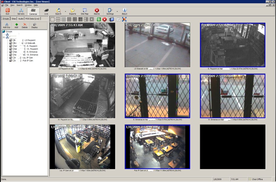

Soundy 1 Posted May 9, 2009 Vigil and Video Insight both have remote client software that will show multiple clients in one window. I can't say much about VI's because the last time I worked with it, it was intended strictly for LAN/intranet use and really didn't work well over an internet connection, but they may have improved on that by now. Vigil's remote client works great for multiple sites, though, and even lets you create "group" views of cameras from different sites. Here's an example, three sites for one client: Share this post Link to post Share on other sites
