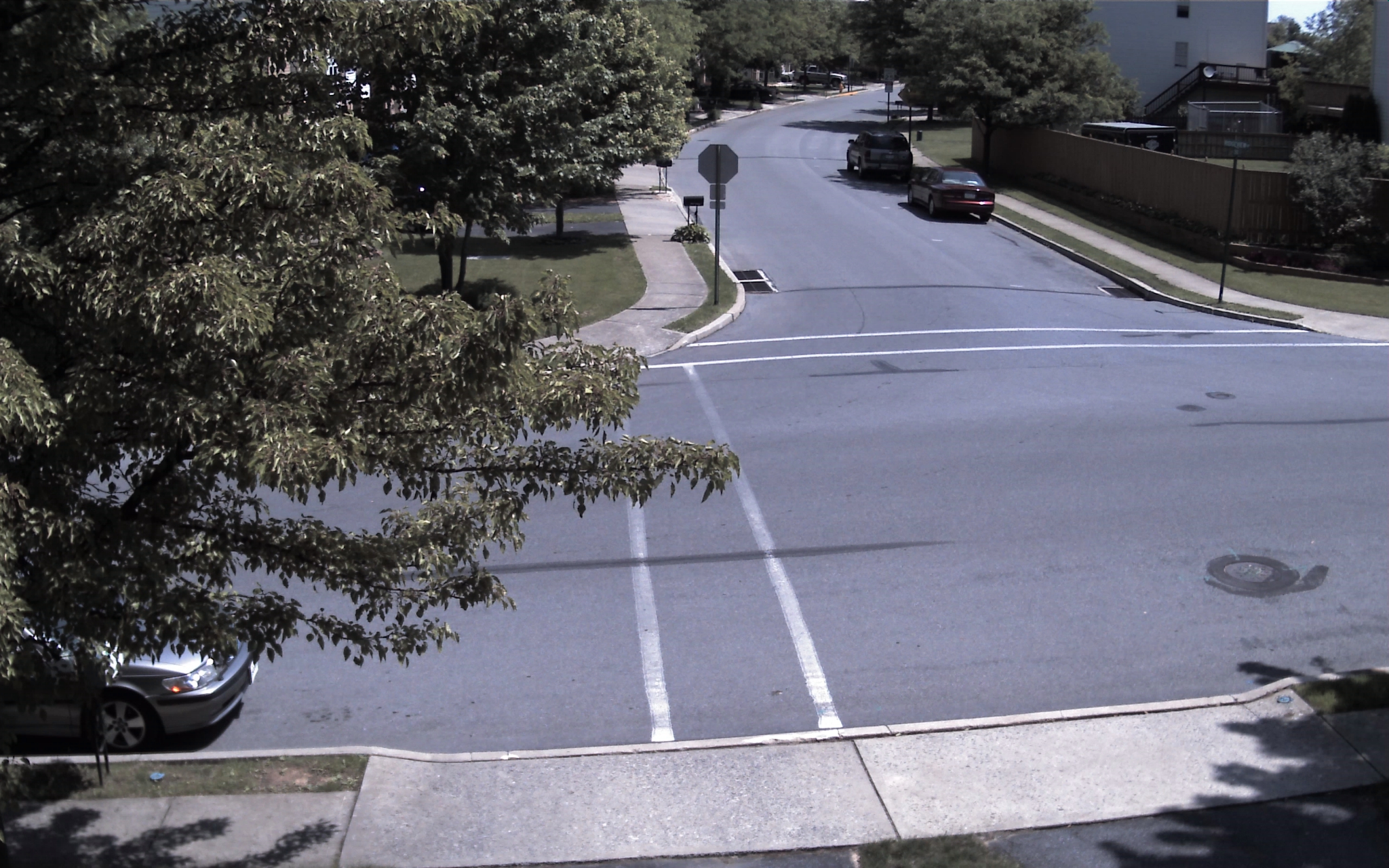

Day Time shot with Arecont 4mm lens.... The Computar H3Z4518CS-MPIR 4.5-13mm lens comes Monday.

That shot was taken using the Snapshot setting in the NUUO MiniNVR as far as I know Arecont doesn't have a "save image" built into the camera like Axis does.

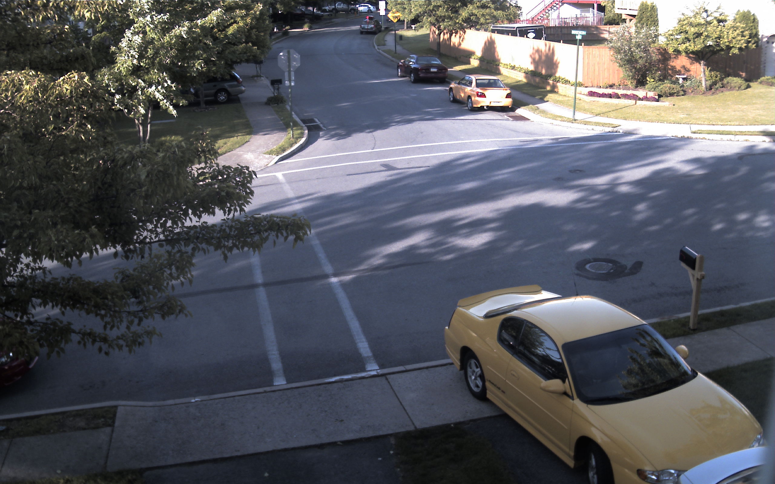

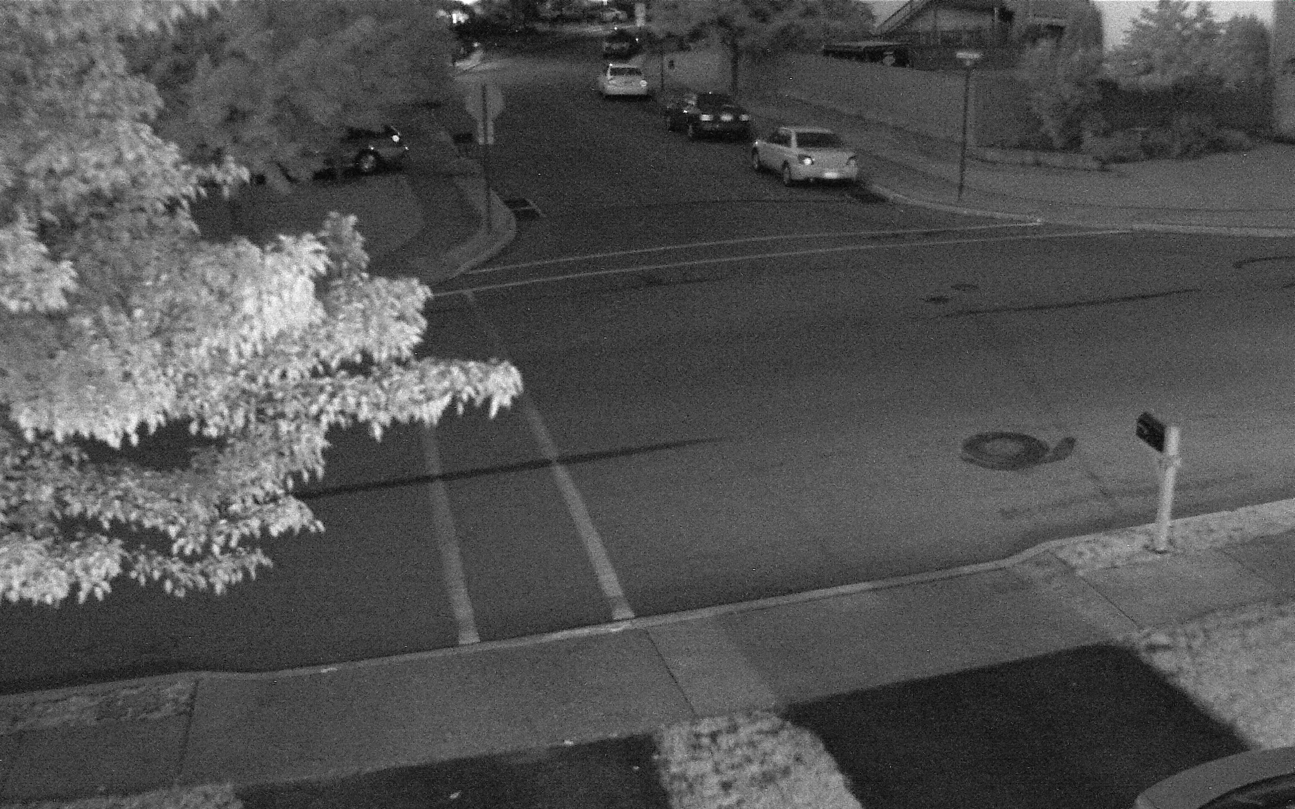

Learn something new everyday.... that worked great
Almost Full Res Day - Imageshack will not host anything bigger then this
Almost Full Res Night - Imageshack will not host anything bigger then this
Edited by Guest
Full Res Day
Full Res Night
quote]
Are u happy with image quality ?
Full Res Day
Full Res Night
quote]
It is very impressive for the crappy Arecont 4mm lens. I can wait to see the difference when the Computar lens arrives. Also one thing to keep in mind bandwidth during the day isn't bad but the night images can get out of hand very quick. I wish Arecont had bandwidth controls like AXIS and ACTI cameras do.

I dont understand how low light bandwidth is higher then daytime
that strange to me
image quality control by Arecont soft will give some control over bandwidth

H.264 compression............ if I set it to MJPEG the bandwidth would be constant

At night the "noise" in the image is being seen as motion, with some I and P frame compressions at 80% or more motion within the scene it goes to full images, hence the higher bandwidths at night
