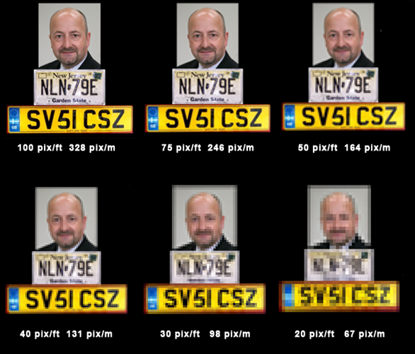

megapixel man 0 Posted May 27, 2009 Excatly. But whats average for number plate and face recognition? The average to get both lic plates and faces is 50pix/ft or 164pix/m. You can start getting facial rec from around 125pix/m and lic plates from 130pix/m if you have a lossless compression. Compression levels really do matter for what or looking at, you may be able to use a higher compression level for faces (Soft edges) whereas you would want low compression on lic plates (hard edges). Share this post Link to post Share on other sites

megapixel man 0 Posted May 29, 2009 Forget ANPR, it is a different science with OCR "optical character recognition" Facial rec and lic plate rec is often refered to in CCTV standards in EU and AUST and I am assuming this is what Robert is refering to. The following chart gives a guide to pixels on target. Share this post Link to post Share on other sites

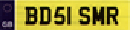

@cctvgeek 0 Posted May 23, 2011 Thanks for the compilation of six images. Interesting to peruse. I've created for myself an image of a UK number plate at 164px/m. This is 85px wide (164 x 0.52m) and the end result looks much more like your image labelled 98px/m than it does the one labelled 164. Thoughts welcome. Share this post Link to post Share on other sites
