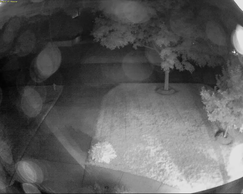

vito 0 Posted July 25, 2009 Sawbone Do you know the settings on you camera? I'm using a 1231 and have a good dusk picture but at night I can see orbs from the LEDs Thanks, Vito Share this post Link to post Share on other sites
Sawbones 0 Posted July 25, 2009 Orbs? Are you getting halos or something from the LEDs? Share this post Link to post Share on other sites
vito 0 Posted July 27, 2009 Yes Sir ...halos would be a better descirption Share this post Link to post Share on other sites

Sawbones 0 Posted July 27, 2009 Something's wrong... you've either got something on the lens, or you've had condensation inside the camera. I see what you're talking about... looks like water droplets. I'll post the pic myself... hang on. OK... got it. Share this post Link to post Share on other sites
vito 0 Posted July 27, 2009 I've only had this camera for five days and its always had this problem....Maybe fingerprints but I doubt it looks like the reflection of the IR LED's Share this post Link to post Share on other sites
DoorMan 0 Posted July 27, 2009 You might want to try removieng the front glass to see if they go away. Might be relections from LEDs on it. It should help to make sure there is a rubber tube surrounding the lens and touching the glass to stop the relection on the lens. Had this happen on an IR bullet once.. Share this post Link to post Share on other sites

vito 0 Posted July 28, 2009 I removed the lense cover and their were spots on the outside of the lense cover. Cleaned the spots and the picture improved greatly. Do outdoor cams require routine maintance, this cam has only been outside for around one week and I'm pretty sure it ws shipped with the spots? Thanks for everyones helpful posts in helping me resolve this issue. Sawbones maybe you can help post an after pic since I still cannot post pics or links....I will PM you thanks for the help.... Share this post Link to post Share on other sites
