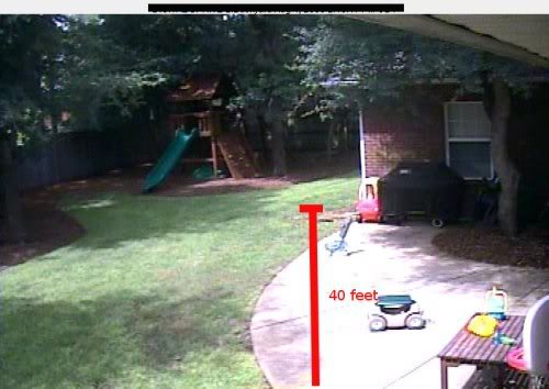

I've used that particular camera, and I'd use something else... let me show you why.
Here is a daylight scene, from a VERY similar model camera to the one you linked (IIRC, mine is a 430TVL model). It doesn't look too bad, right?

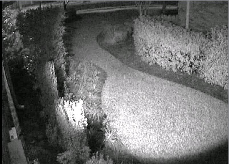

Well... here it is at night... and imagine it without the IR that's spilling out from around that corner (that's another IR source). That's supposed to be a 100' IR camera, and it's barely making 40'. When it comes to useful IR distances, you can pretty much cut the advertised range in half.
101654_1.jpg[/img]
The IR beam from that camera is also pretty tight, so if you're thinking of simply mounting it closer in order to make the IR work better... don't. You can't really mount it closer to the object, or you get the "spotlight" effect, like so: (this is the same camera as the previous two pictures).
A whole lot of bloom in the center of the picture, and the rest of it is completely washed out.
If you're going to use IR, use separate illuminators, and plan to illuminate the entire area.

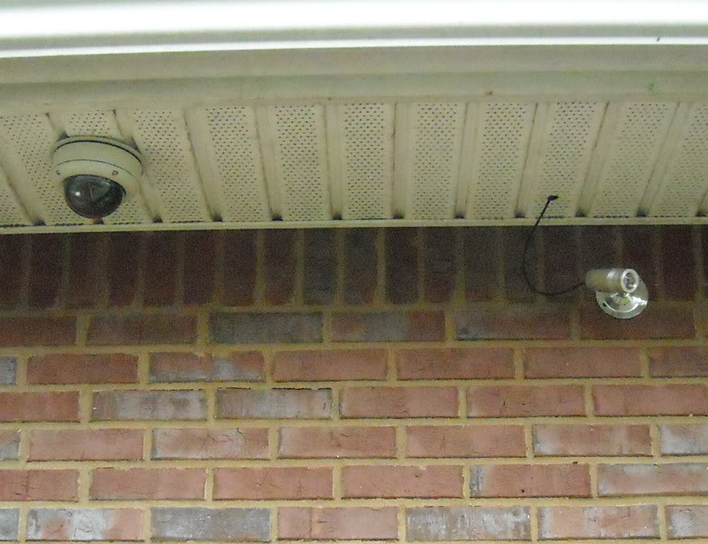

Let me give another example to further illustrate the point that separate-IR-Illuminator=better.
This is a Honeywell day/night dome mounted with a separate illuminator (an Ebay special that happens to work pretty well).
The illuminator is mounted about three feet away from the dome itself (A Honeywell HD4x vandal-resistant dome), and runs off of the same 12V power supply. This provides IR illumination, and the bugs that are attracted to the IR aren't flying right into the lens of the camera. This has the benefit of not tripping your motion detection. Also, if your IR burns out, or you don't like the pattern/spread provided by that specific illuminator, you don't have to trash the camera... you simply replace the illuminator.

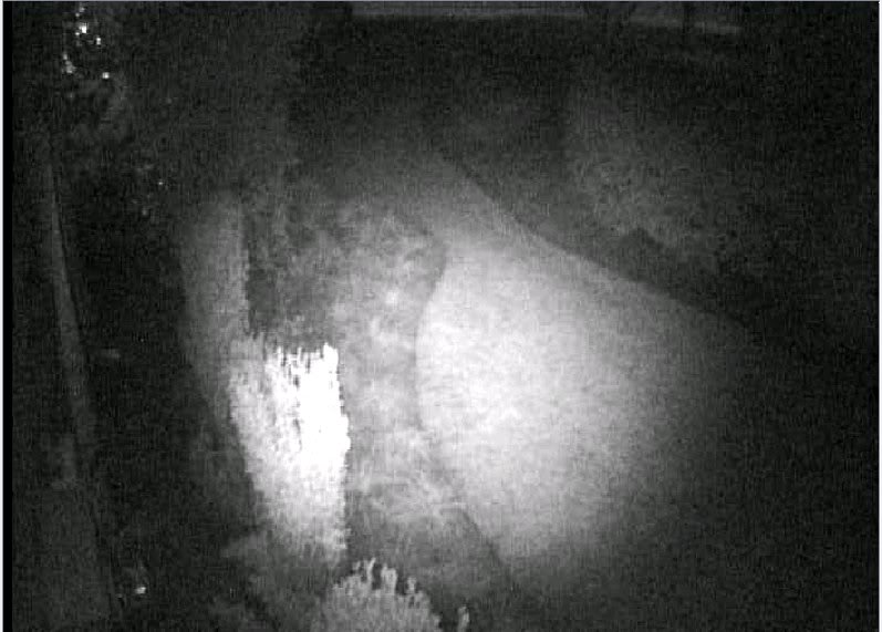

Here is what the view looks like through that setup:
Now compare that to the IR-integrated dome that is the subject of this thread... remember the "spotlight" effect?
No comparison... I know which view I'd rather have on my DVR. Adequate illumination that's even and not overly bright is very important when it comes to getting the most out of your day/night cameras. Integrated IR by itself is rarely adequate in my experience

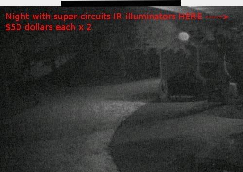

You theoretically could put up an IR-integrated dome, AND add additional illuminators to it.
Here is the picture with only the camera-integrated IR:
Here is the picture with two of the super-circuits puck illuminators.
They are soffit-mounted to the upper-right of the picture, just out of view. With the additional IR light, the picture improves.
More IR is clearly better in this instance. The downside is that bugs will still be attracted to the IR being emitted from the camera, and it will still draw the eye of anybody creeping around.
