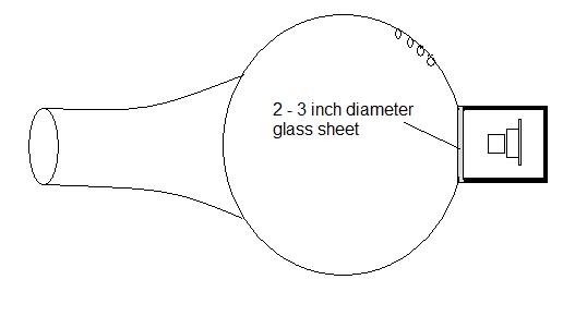

FarmerCharlie 0 Posted June 18, 2009 can you write a message inside the gourd instructing the birds to lick it clean each day ? I'm sure my birds can read just fine, but I'm not sure a bird's tongue would be very good for licking. can you put a sheet of glass where the camera is now , and then mount the camera inside a box behind that glass ? That is exactly what I plan to do next year. This year I did not have the time to find tubes with the correct threads and diameters, so I mounted the camera directly on the screw-on access cover that came with the gourd. I also want to find some sort of diffuser film to cover the LEDs. Something that would work a little better than the NexCare adhesive tape, which kept coming off in this humid environment. Share this post Link to post Share on other sites
