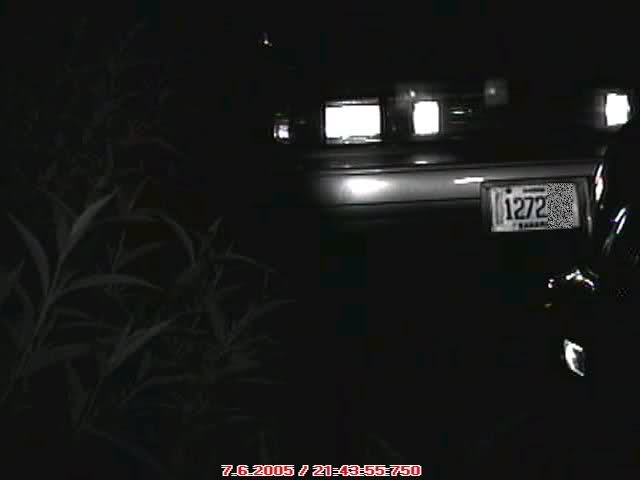

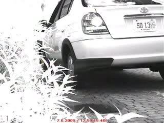

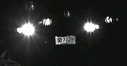

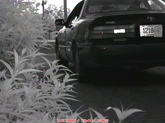

rory 0 Posted June 29, 2009 some example shots from REG-L. Cant remember the model off hand but it was the basic one used for gate entrances. I cant find extreme's website anymore, looks like bosch messed it up and i have no patience to go searching through their website. Share this post Link to post Share on other sites
Tyler_dsi 0 Posted July 8, 2009 wow those are really nice pictures but how far from the vehicles was that camera? just curious Share this post Link to post Share on other sites

rory 0 Posted July 12, 2009 wow those are really nice pictures but how far from the vehicles was that camera? just curious that camera was mounted on a post right where you see it, give or take a couple feet for the lens. Its the basic REG-L camera with their standard lens of like 4mm. Cars stop at the gate so there was no need for anything more. Extreme has other REG cameras with longer IR and longer zoom lenses. On a side note, Lighting fried this camera and its replacement, not sure what they have there now as it wasnt my client to begin with, I just helped with the initial install. Share this post Link to post Share on other sites
