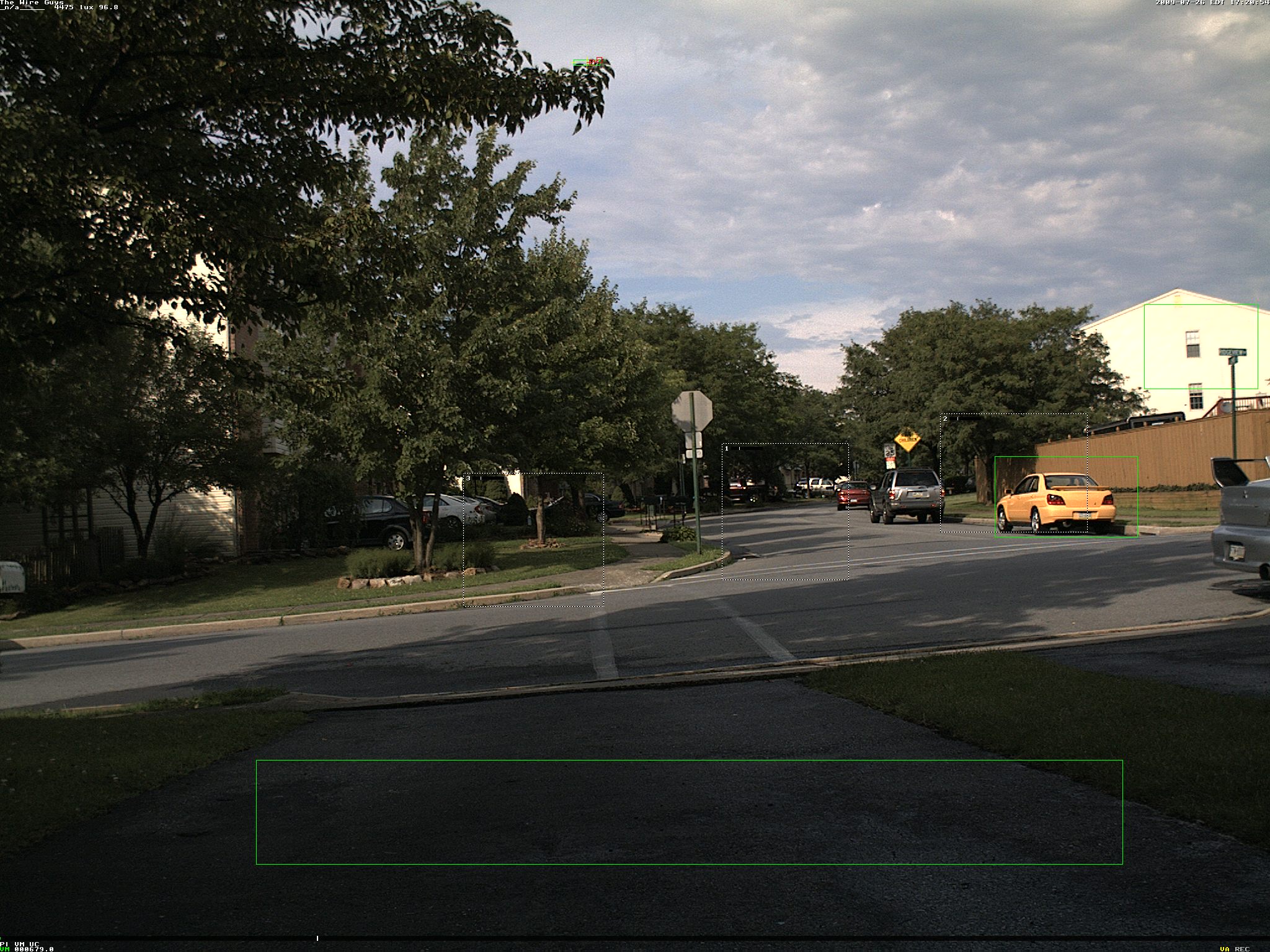

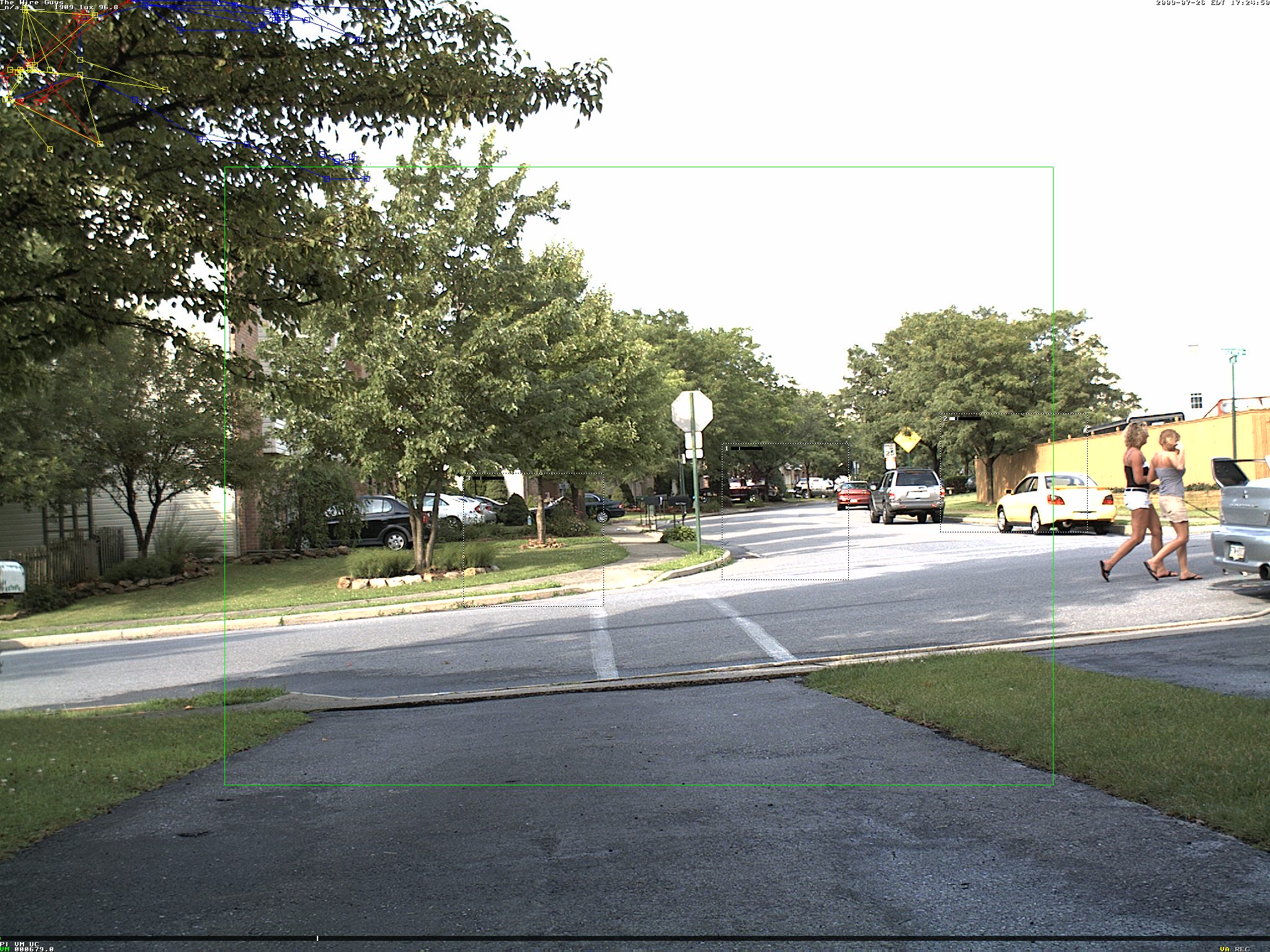

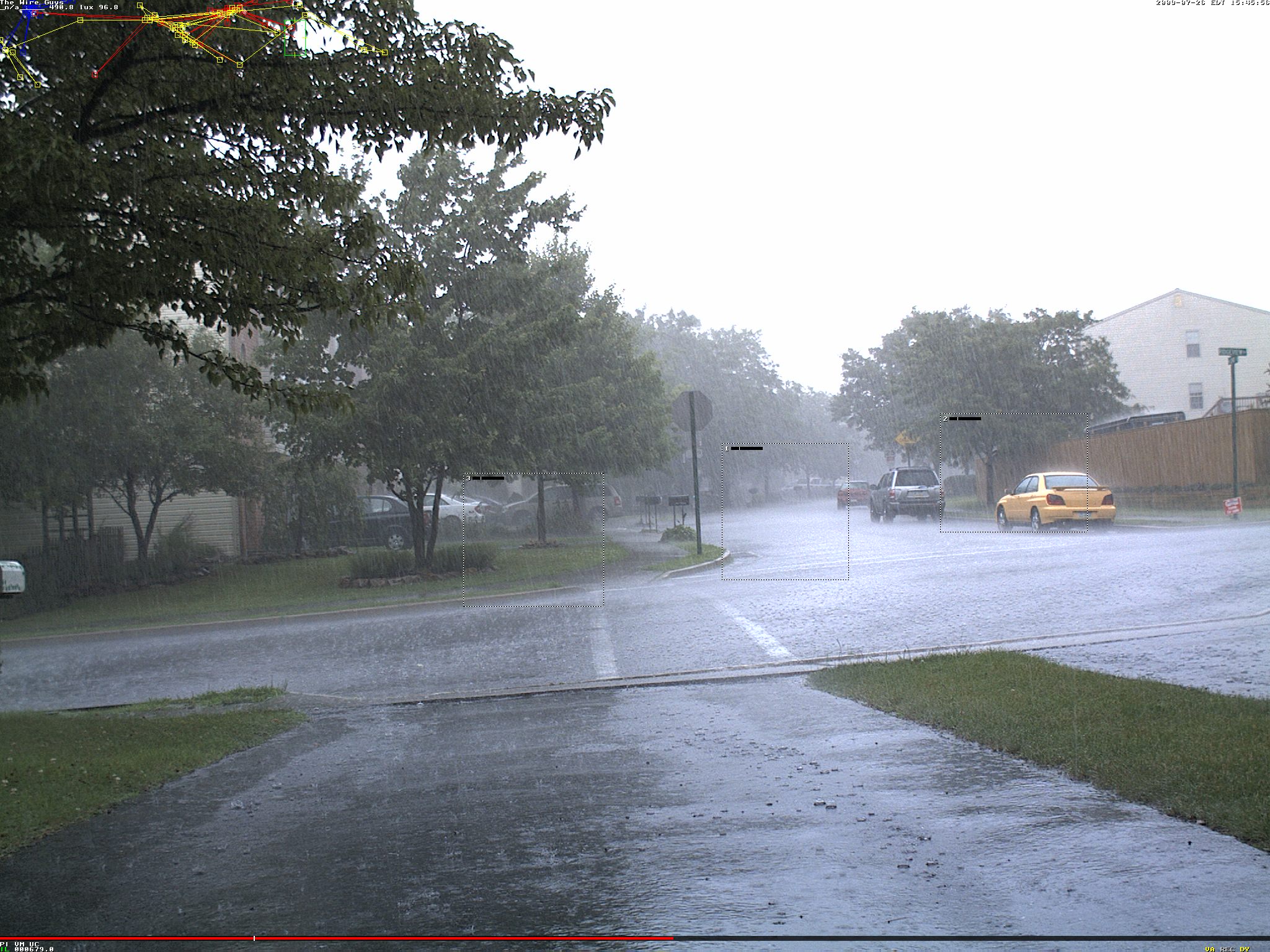

Sooo... allow me to ask our august assembly a question:
If you had to choose between a dual-night Mobotix (3MP day and 1MP night) and an Arecont H.264 AV3155, which would you choose?
Note: Residential application, for day/night purposes. Replacing the camera providing this view:
You're about 18 yards from that street, and covering about 75 feet of frontage.
I have not seen night images from the newer Arecont cameras, so I don't know how to judge their effectiveness versus the Mobotix (which are widely regarded as excellent at night).
