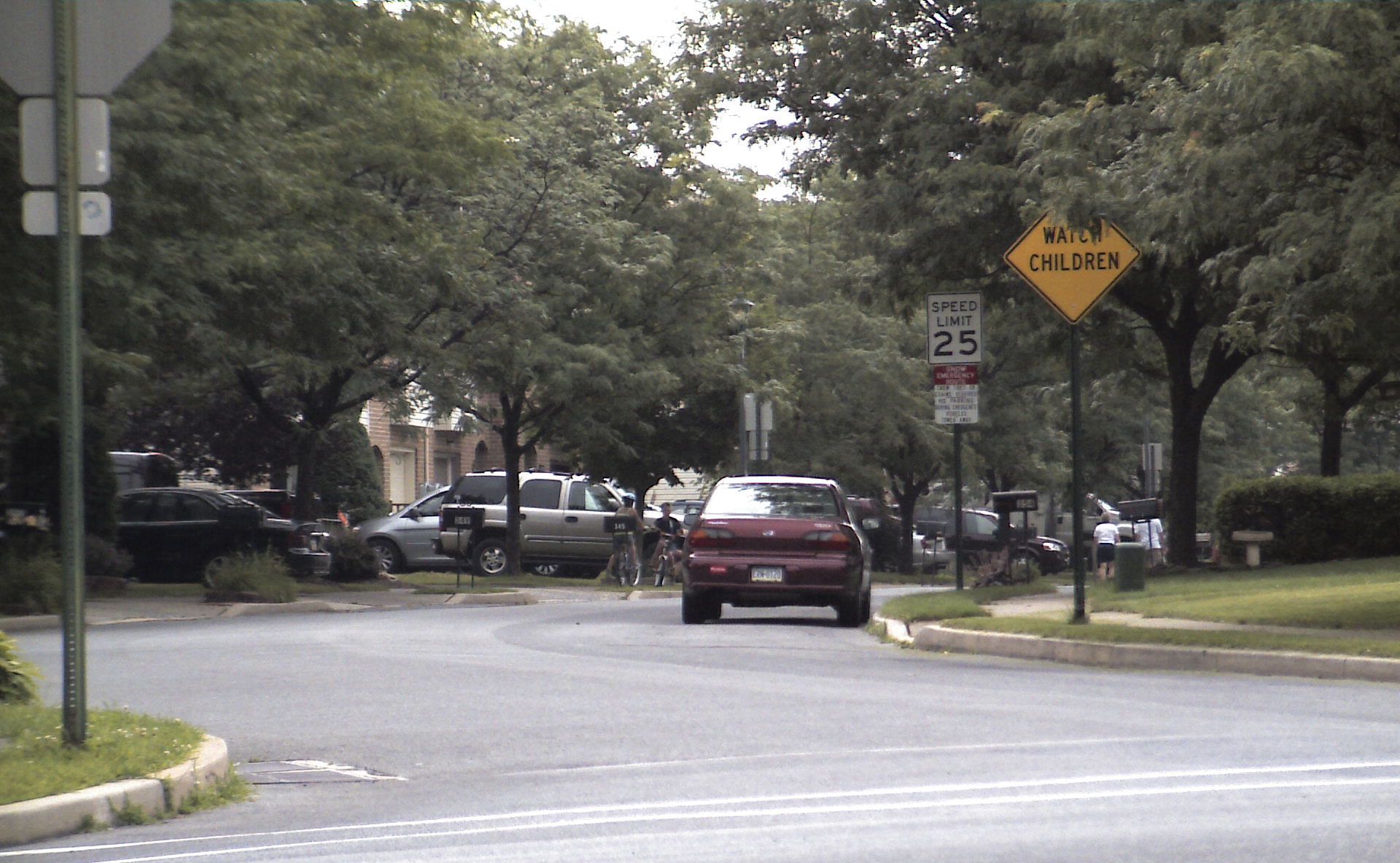

thewireguys 3 Posted July 23, 2009 out of the box images Share this post Link to post Share on other sites
griffonsystems 0 Posted July 24, 2009 i have been using mobotix cameras for over a year and still haven't scratched the surface on everything the camera is possible of doing...and just like going to hd on your tv, you won't want to go back to analog 480rez after you have messed around with megapixel Share this post Link to post Share on other sites
DoorMan 0 Posted July 24, 2009 TWG, what is the distance to the yellow sign for future refference? That's alot of pages to comb through! Never been a fan of manuals more of an automatic guy myself... Share this post Link to post Share on other sites
ak357 0 Posted July 24, 2009 TWG, what is the distance to the yellow sign for future refference? That's alot of pages to comb through! Never been a fan of manuals more of an automatic guy myself... I would suggest to ask about Horizontal distances of given object ( from left side to right side of the whole pix) for example his first pix of yellow sign is about 42 pix H second pix about 22 pix H and u can clearly see the difference just my opinion Share this post Link to post Share on other sites
thewireguys 3 Posted July 24, 2009 TWG, what is the distance to the yellow sign for future refference? That's alot of pages to comb through! Never been a fan of manuals more of an automatic guy myself... I would suggest to ask about Horizontal distances of given object ( from left side to right side of the whole pix) for example his first pix of yellow sign is about 42 pix H second pix about 22 pix H and u can clearly see the difference just my opinion First image is 3megs second image is 1.3 megs. And the children sign is about 50 yards away. The lens in the L43 Share this post Link to post Share on other sites

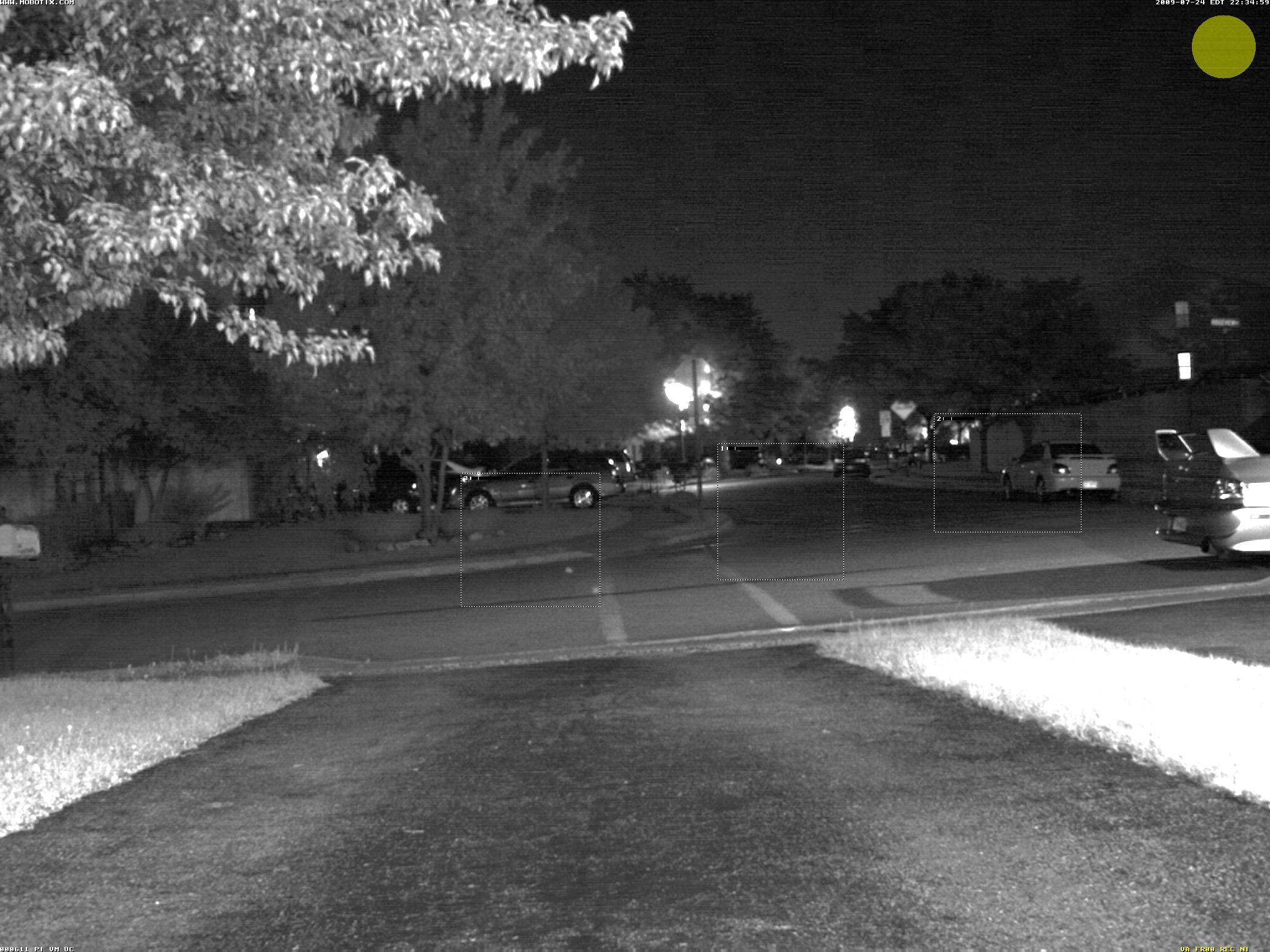

thewireguys 3 Posted July 24, 2009 Arecont 3105 to compare Share this post Link to post Share on other sites
ak357 0 Posted July 25, 2009 Arecont 3105 to compare Thx for pix would be nice to have the same FOV on all shots in future Share this post Link to post Share on other sites

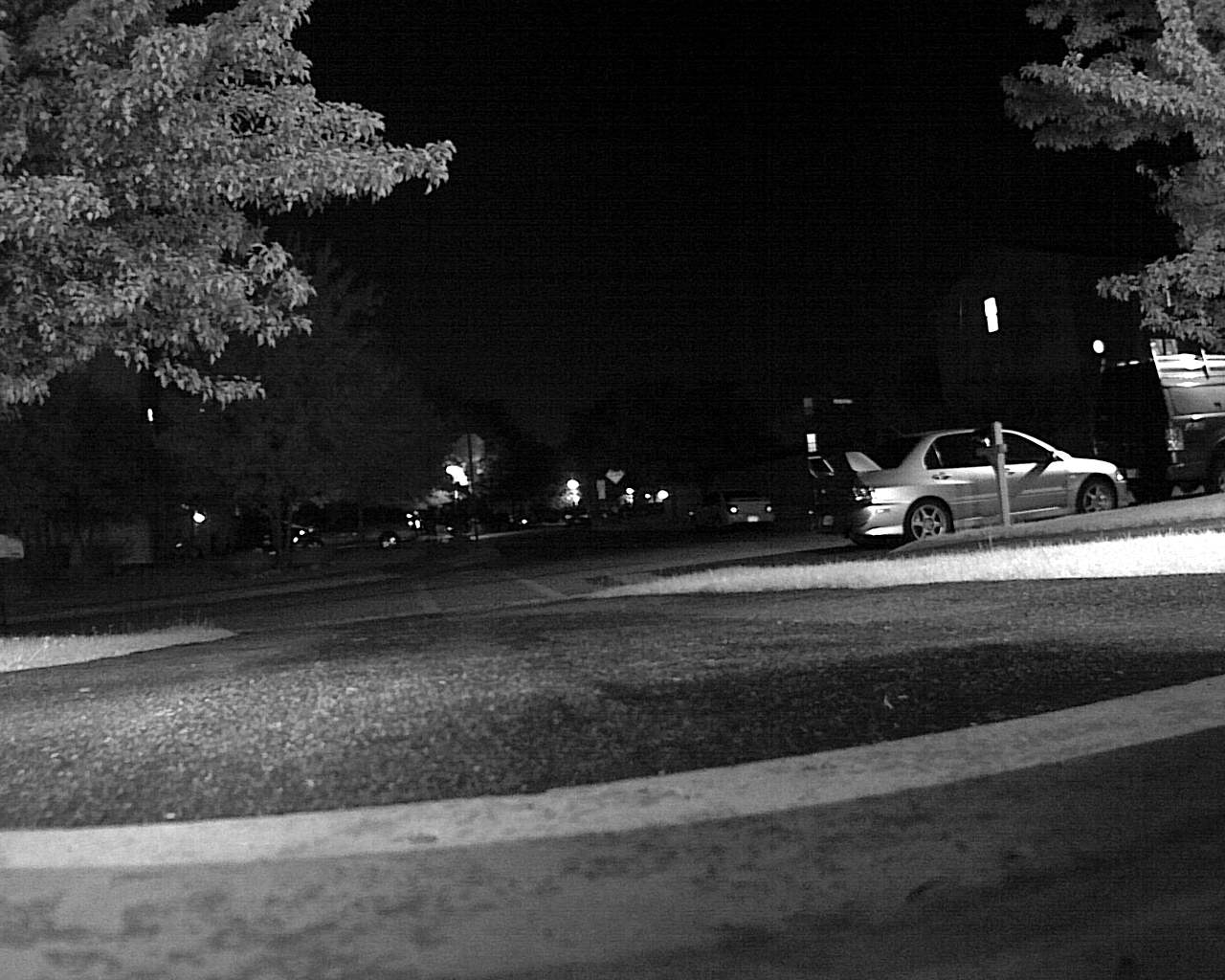

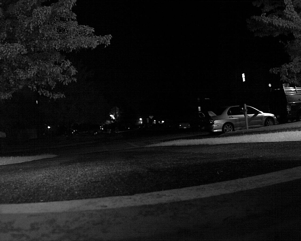

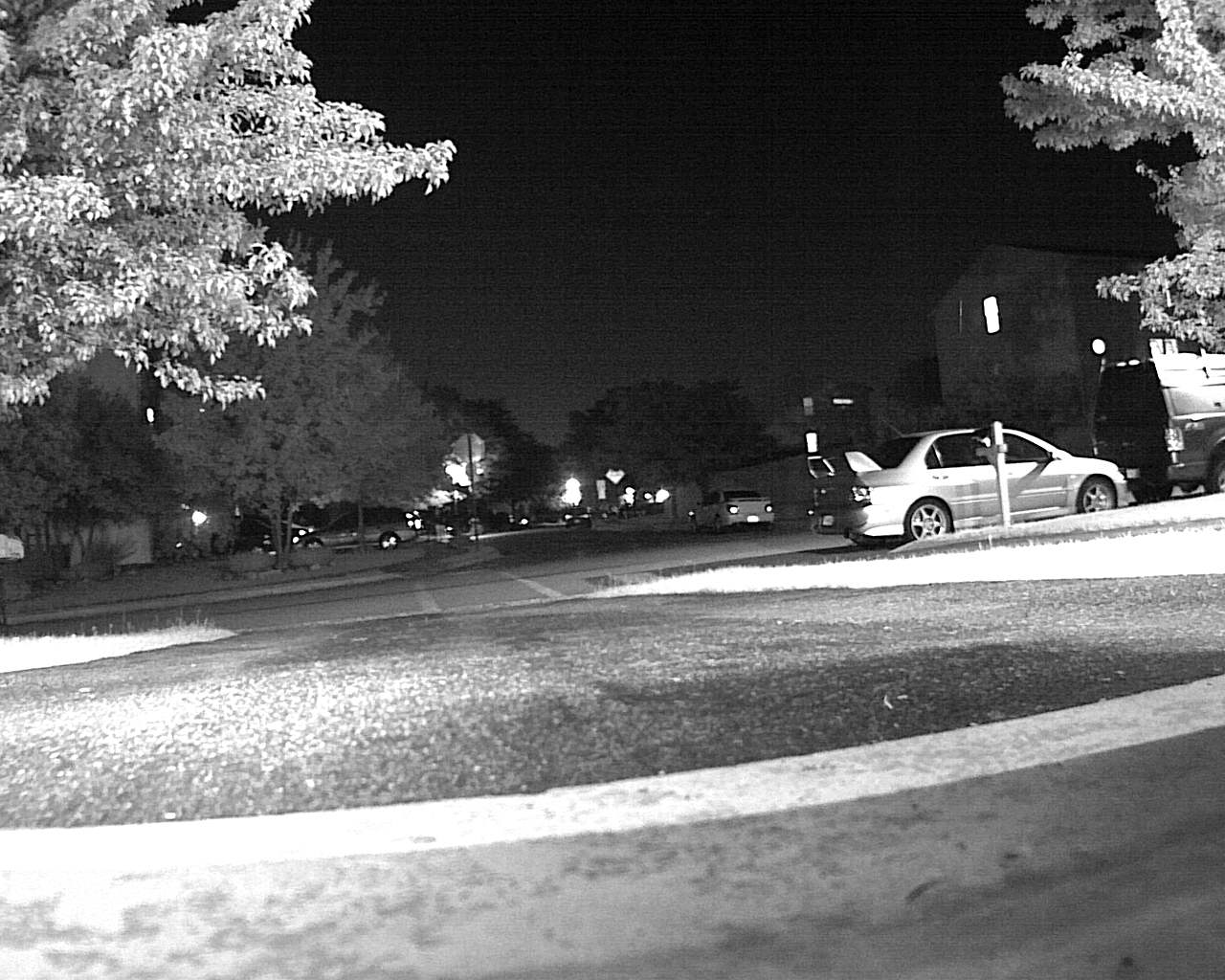

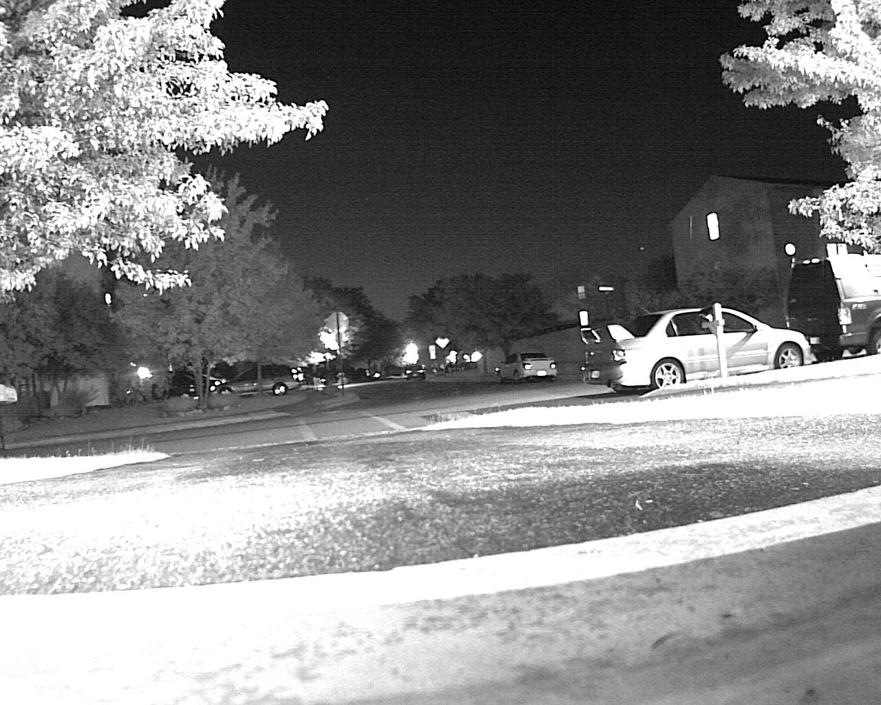

thewireguys 3 Posted July 25, 2009 3130 1.3mega night shot (moonlight) (Quality) setting (Balanced) setting (Speed) (high speed 30) M12 1.3mega night (default setting) Share this post Link to post Share on other sites
