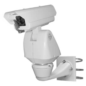

I've dealt with one PTZ that mounts on top of something rather than needing to hang from it, and that's a Pelco Esprit. Probably a little big for a "desktop" though...

down_under has the right idea, I think - this is the aforementioned Esprit, which is along those lines:
Not all hanging PTZ's are limited to this......due to design needed for Airports etc (you need to see above the horizon for planes coming in etc) you can now find PTZ's that do this......but I have not seen a lot that go past horizontal...I think the new Bosch one comes close......I think the website is http://www.autodome.com but I Imagine it might not quite cut it, a smaller version of what is pictured above would work, most pan tilt heads can run on Pelco Protocol so no real issue.
