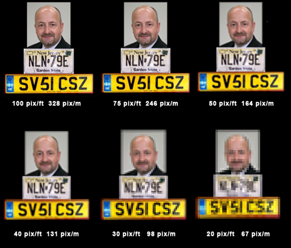

hardwired 0 Posted August 22, 2009 ..And at a 352 pixel width, at a 90 degree angle, that yields about 7 Pixels per foot, which is not exactly what I'd call "Crystal Clear"... Katie, Francisconet, Etc. (you know who you are) Please stop spamming our boards. You are an insult to those of us here that attempt to provide helpful information to people, without attempting to sell something to each of them. somi97, if you can provide more details on what you are trying to achieve with this system, we can try to provide more information back to you. Just for reference, though, a professionally installed system with eight cameras would typically run at least 4-6 times your original budget, or more, depending on what you are trying to achieve. Share this post Link to post Share on other sites

Sawbones 0 Posted August 22, 2009 hardwired said: ..And at a 352 pixel width, at a 90 degree angle, that yields about 7 Pixels per foot, which is not exactly what I'd call "Crystal Clear"... Katie, Francisconet, Etc. (you know who you are) Please stop spamming our boards. You are an insult to those of us here that attempt to provide helpful information to people, without attempting to sell something to each of them. somi97, if you can provide more details on what you are trying to achieve with this system, we can try to provide more information back to you. Just for reference, though, a professionally installed system with eight cameras would typically run at least 4-6 times your original budget, or more, depending on what you are trying to achieve. Listen to this man. You're not going to get anything identifiable out of that budget system... not at that range/resolution ****** edit ****** This is a handy set of examples that somebody posted here one day. I don't know who the actual author of it is, or I'd credit them: Image how poor 7 pixels per foot will be... Share this post Link to post Share on other sites
FranciscoNET 0 Posted August 23, 2009 Hi, Well, I am the manufacturer of the system that I specified and as the manufacturer I think I get to set MSRP for the products that I manufacture. I was only trying to design a product that completely matches the budjet of the original poster. I know its a 352x288 resolution per channel, but with properly placed cameras you can get positive identifications under that kind of configuration. Such as to begin with, placing one camera in the center of the entrance door in a manner than when a person walks in you get to capture a great deal of his face in around 70% of the viewable area of that channel and at 352 lines you will know and see that face clearly. Now as the other cameras, EVEN if that same person does something wrong, and even if you got to see that person doing something wrong at 7 pixels because that person was so far away from that other cameras, at least you will get to know what's the color of the person, the color of the shirt and jeans/pants and then you get to compare that visual information with camera#1 (the main entrance camera) to ID him/her. That way I was able to solve many cases locally within my neighborhood, even cases that got recorded on a DVR that we didn't install and that recorded on a slightly lower resolution (320x240 QVGA) than the DVR that I proposed here that records at 352x288 CIF for 20~50 extra pixels at least. Its all about strategic camera placements, dont expect to get positive identifications on ALL cameras, this wont even happen on D1 systems. To solve a case, you need cooperation from most, if not all of your cameras recordings, thats my stragegy, specially if $1,200 is the most you can afford to spend for a surveillance system. If for some reasons it must be at D1 720x480, I can also design D1 systems, but not at the $1,200 max budget, that system falls on a totally different pricing bracket. Share this post Link to post Share on other sites
