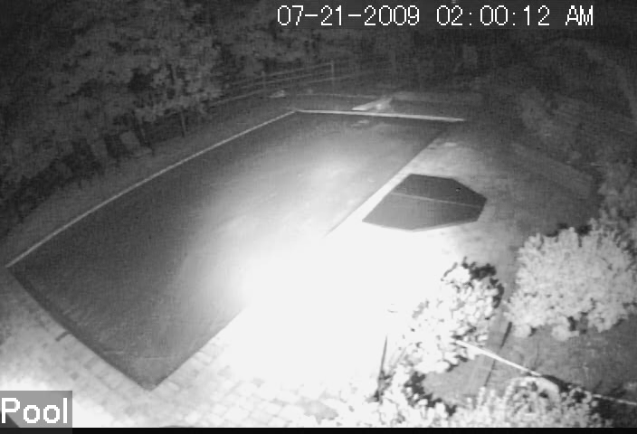

vtphilk 0 Posted July 21, 2009 PS. Grabbed some snapshots from the cameras last night. Under moonlight the Pool camera is not visible at all. However, if the outdoor flood lights are turned on (Which are not directly on the areas) I get pretty good pictures: http://www.speedyconnex.com/cctvpics/cam-1-wfloods.bmp http://www.speedyconnex.com/cctvpics/cam-2-wfloods.bmp http://www.speedyconnex.com/cctvpics/cam1-2-sidebyside.bmp So I suggested the client get a motion detector on the flood lights and he agreed. (So another revenue source ) So I'll be looking for one of those X10 flood light/motion detectors lights which allows you to put the motion trigger in after install. I figure...IR or not...best thing I can do for a nighttime picture is give it legit real light I'm also surprised of the hot spot on the WDR B/W camera. I would have thought the WDR is suppose to block stuff like this out. Share this post Link to post Share on other sites
rory 0 Posted July 21, 2009 vtphilk said: PS. Grabbed some snapshots from the cameras last night. Under moonlight the Pool camera is not visible at all. However, if the outdoor flood lights are turned on (Which are not directly on the areas) I get pretty good pictures: http://www.speedyconnex.com/cctvpics/cam-1-wfloods.bmp http://www.speedyconnex.com/cctvpics/cam-2-wfloods.bmp http://www.speedyconnex.com/cctvpics/cam1-2-sidebyside.bmp So I suggested the client get a motion detector on the flood lights and he agreed. (So another revenue source ) So I'll be looking for one of those X10 flood light/motion detectors lights which allows you to put the motion trigger in after install. I figure...IR or not...best thing I can do for a nighttime picture is give it legit real light I'm also surprised of the hot spot on the WDR B/W camera. I would have thought the WDR is suppose to block stuff like this out. Once again, any CCTV pro with experience in night applications looking at those 2 images can tell the camera on the left is a MUCH better camera for a day night app, its much higher sensitivity in BW mode then the cheaper Color/IR camera on the right, and real colors in color mode. As for the spotlight, it would need adjusting to get rid of the spot, or turn the IR down some. I dont know either camera and have no specs, so Im only going by the images i have seen thus far. Only way to be 100% sure is to put the cameras side by side at the same location and FOV. Also, all day/night apps need to also be setup at night, in the dark. Ignore the whole WDR thing though, your only concern with that location is that it is day night with IR, and also the WDR might not even be enabled by default on that camera, disable it if it is. Granted if you are concerned with heavy light changes (non existent in your application) and the IR cut filter going crazy all night long (I had only one go bad in almost 10 years and even then I fixed it myself), then perhaps you need to look at a dual day night camera setup such as an Ex82. If you cant afford either then ofcourse a Color/IR camera would be the lower cost choice. Share this post Link to post Share on other sites
vtphilk 0 Posted July 21, 2009 I think I might make one more trip back to the site to try and get the camera focus on the right one as it is a tad out of focus I think. Those stupid little thumb screws are a pain to focus also it did not have a monitor output on the front so it was tough getting it focused. I also will try testing turning off WDR and see if it helps with night on the camera on the left spot effect. There is no IR but there is normal spot lights back there. One thing nice about the ICR camera (Left) is it is settings controllable thru the PTZ wire. Now if I only knew which settings to tweak )) Thanks again. Share this post Link to post Share on other sites
rory 0 Posted July 21, 2009 those are spotlights and not IR? what type of camera is it, just a day night without IR? Not a bullet then? Box, Dome or PTZ? Well now that you say its not IR then I am having second thoughts about it being a really good camera but again I dont know it or its specs .. either way move the spotlight up higher, either on the pool itself or up higher towards the bush in the distance near the top of the image. I still prefer it to switch to higher sensitive BW mode at night, cant stand DSS, and no color is better than thinking its blue when its really green. It still looks like a better all around image to me though, but not having IR makes it worth less (not worthless!), guess thats where the WDR made the cost go up LOL. You dont need a WDR camera at either of those locations by the way. No matter which OEM brand you get, one of them should have a True Day Night IR Bullet, without DSS (or with, just disable it) and with a switching IR Cutfilter, thats the one you want next time. And stay away from WDR unless you are trying to get plates at a gas station or faces at an entrance .. things like that, less they can afford Pano's WDR cameras. Share this post Link to post Share on other sites
vtphilk 0 Posted July 22, 2009 Sorry..I should have been clearer. It is a dome, vandalproof with NO IR leds however does have mechanical IR cut filter: http://www.icrealtime.com/solutions/cameras.asp?cameraid=EL430PIXIM Actually, the original install was suppose to be two of the USAG cameras (Color one with IR LEDs at the FirePit on right). However, had some 'problems' with one of the cameras and ended up needing something to fill the gap quick because I had a customer in 'rich jerk mode'.... I had that WDR in the truck and sold him on it thinking well maybe the WDR will help with reflection of sunlight on the pool when it is open. He (Customer) also liked the idea of the dome as it 'looked' neat ...haha Anyhow, it's a learning experience and thanks so much for the tips . One thing I can say is USAG has been very helpfull with tech support etc... and much more responsive then some 'other' companies I was/am dealing with. Share this post Link to post Share on other sites
