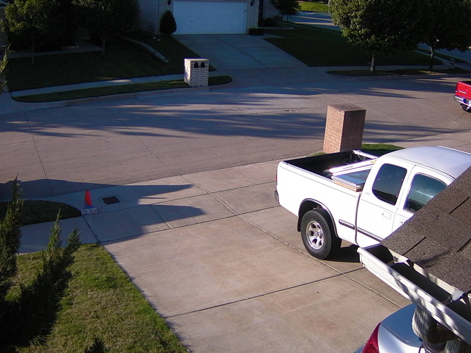

thewireguys 3 Posted May 17, 2010 (edited) Thats becasue you don't use a good analog DVR. Please post some images from a "good analog DVR" and lets compare Show them a 600TVL camera with D1 image compression (they will not be so quick to change) As I have done this at trade shows with seasoned professionals not end users and they will 85% of the time opt for analog over IP MP. The same trade shows that I attend and everyone is checking out MP cameras. Again show them a 600TVL camera at d resolution recorded on a hardware compressed DVR and you will notice very little difference between that and a 2MP camera. D1(720x480)< 2MP(1600x1200) besides more then twice the resolution. But like most people who tout IP im sure you are comparing 2005 analog to 2010 IP technology. So a new SCC-B5369 with a Axis encoder compared to a new Mobotix, Sanyo, Arecont, Axis, Avigilon. If you have an entrance with perfect lighting and a dedicated network then MP is a great solution. Not true MP cameras are based on CMOS rather then CCD which have a number of disadvantages compared to CCD, such as low light, noise and have poorer color reduction (though they are smaller and cheaper making them most widely used) CMOS is used in cellphones CCD is used by NASA and high end medical applications as the amount of noise produced by CMOS. Yes MP is the future but it an immature technology that is not fully developed and should be used in specific applications not main stream, give it 4 years and will be good. Im not arguing its not the future im saying its not the present. Just so you know MP cameras represent less then 2% of the total market due to price to performance. so to make the case IP has advantages over analog camera based on MP cameras is ridiculous. Every install we do is megapixel where it is need needed MP cameras also offer very poor remote connection and are very expensive when it comes to storage and most applications I sell to want at least 3 months of storage not to mention networks need to be upgraded pr replaced to accommodate multiple MP cameras. Storage is cheap my friend IP has a larger file size and lower image quality when recorded at the same resolution not to mention the lag and latency. Since this topic is about remote connectivity and PTZ control it does not make sense to do IP as it will cost more and give lower performance due to the lag and latency that is inherit on IP based systems. An im not even mentioning the reliability and cost factor. We do 4 camera megapixel system installs for about the same price your selling your " good 2010 analog systems" and if you know what your doing reliability is not a issue. Show me a 2010 600TVL analog image that looks as good as this and I will eat my words. Edited May 18, 2010 by Guest Share this post Link to post Share on other sites
