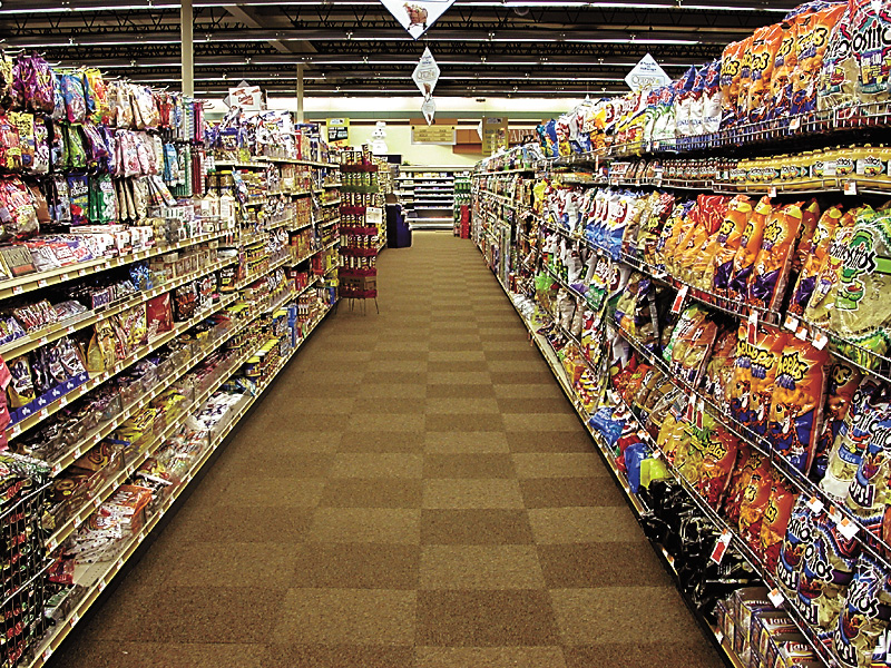

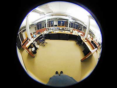

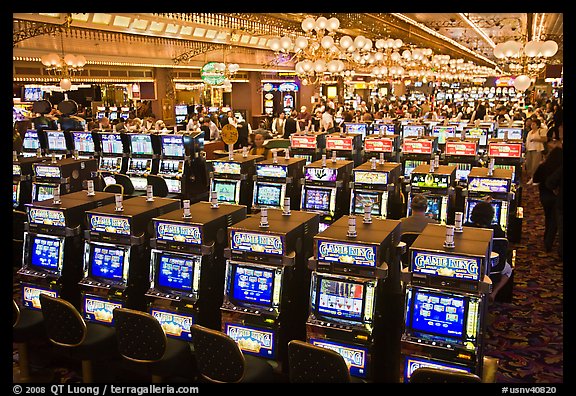

survtech 0 Posted August 19, 2009 I think in most cases, I'd find a 5MP (2560x1920) resolution at 10fps (IQEye 700-series) more useful than 1920x1080 at 30fps... Why? Would a 5MP camera be able to see the shoplifter in the next aisle? Or the customers playing at the third row of slot machines? Or have a wider field-of-view? Or see better in low light? Share this post Link to post Share on other sites
Soundy 1 Posted August 19, 2009 I think in most cases, I'd find a 5MP (2560x1920) resolution at 10fps (IQEye 700-series) more useful than 1920x1080 at 30fps... Why? Would a 5MP camera be able to see the shoplifter in the next aisle? No... can these HD cams see THROUGH bags of chips? Or the customers playing at the third row of slot machines? Same question - is x-ray vision a feature of HDcctv? Or have a wider field-of-view? Kinda depends on the lens, doesn't it? Or see better in low light? Kinda depends on the specific camera as well. None of these questions are relevant to the comparison. Twice the resolution is still twice the resolution, isn't it? Share this post Link to post Share on other sites
