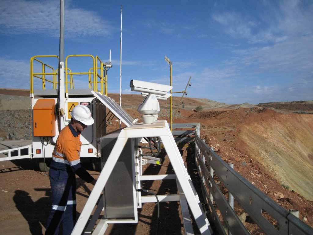

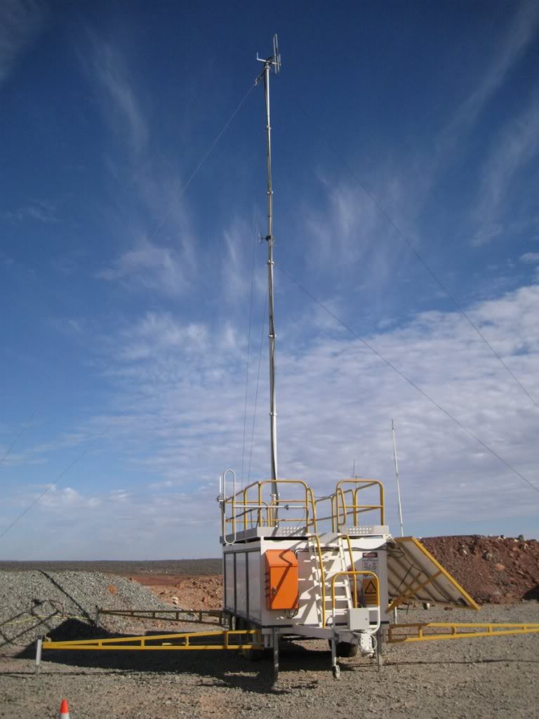

Soundy 1 Posted September 6, 2009 Large comms trailer. 5.5kw solar power over 4 redundant circuits, 4.6 tonne with 1.6tonne batteries, 15m air powered mast. Network 3 x fibre links, 2 x 5.8 Ghz, 3 x 2.4 Ghz, 2 mesh, 3 backhaul, Supports Cameras, 2 -Way radios, FM repeats, 3 meshes, 2 wireless bridges, 4 slope radars, Serial, Modbus, I Phones, Laptops, Digital IO, 120 heavy duty vehicles all over IP. Got 3 of these to move around when necessary. Cost about $200k each That is some SEXY $#!+ right there! Wow! Share this post Link to post Share on other sites

rory 0 Posted September 6, 2009 That is some SEXY $#!+ right there! Wow! I just want to know why they spend so much money to look at dirt and rocks (wonder if they can see anything at night) Share this post Link to post Share on other sites
woodyads 0 Posted September 6, 2009 Hahahahahh, yep as I said synergies. We have 4 slope radars which are a wicked technology that scan the walls and set off alarms if they are going to come down. Typically we get about a months warning, so they set up critical monitoring, about 2 weeks to go they will bund off the area to catch rocks and divert traffic. 2 days to go they will close off that area. 2 hours they will stand on the edge and watch it go. 6 hours later they give the all clear, they cost about $1m each. Then we have Modular which is the Fleet Management system running off mesh at a cost of $4m. So its easy to justify $600k on comms trailers. Sticking cameras on them is just a bonus, but in saying that the site love the camera system. Unlike most security systems we get everyone using them, Trainers, Geo's, Geotechs, Dispatches, Managers and supervisors. We also use it to audit the Fleet management system and check the data comming from the vehicles matches the data collected by the system. Shovel dig rates, Clean up times, kick off times etc. Funnily enough we need those big trailers to supply enough power to make the cameras cost effective. My first attempt at a small trailer only had enough power for 2 cameras and was very inefficent. cost for the infrustucture was $25k per camera, not including the camera or NVR system, just comms and power. Now I have it down to around $5k per camera. plus got some wicked trailers out of them. As for why look at dirt, it cost around $300m per year to dig that hole. Save 1% and we pay for all my systems in 3 years. Our group save around 10% of mining costs. Share this post Link to post Share on other sites
