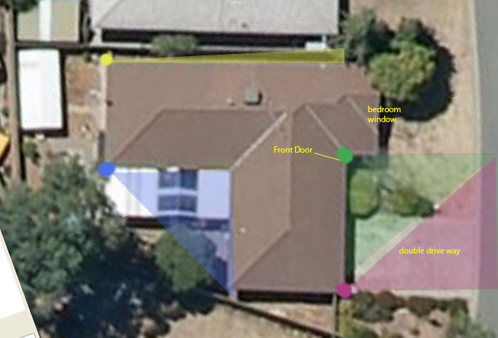

i am setting up a 4 channel cctv system for my house and need some help in placing cameras.
i am thinking about putting a narrow angle lens, in yellow, down the side of the house where all the bedroom windows are and a walk way.
green area is the front door with 90 degree lens recording the front side of house windows and front yard
red part is recording drive way with 45 degree lens
blue part is recording back part of house with carport under main roof and verandah and back windows with 45 degree lens
this leaves the bedroom out the front not recorded.
can you help me improve this setup??
Edited by Guest
With four cameras, that looks about the best you can do to me. You could perhaps cover the front bedroom window by changing the position of the yellow camera to the other end with a 45 degree view encompassing the bedroom window and the side of the house. The trees/bush foliage might make that a bad idea though, it's hard to say from a top down view.
Having said that, the purple/red camera should provide some coverage of the bedroom window area.
