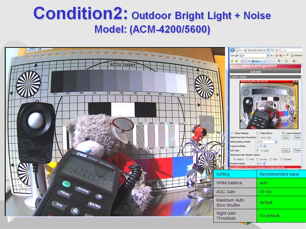

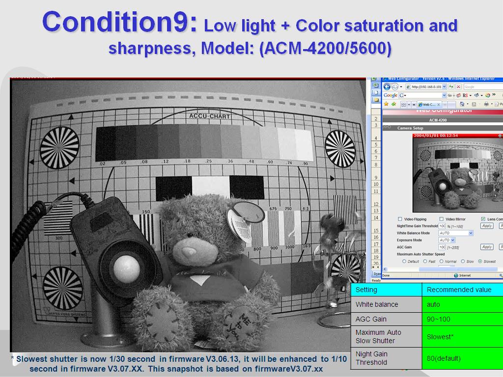

I just downloaded a PP presentation on how to setup ACTI cameras for the best image quality in different lighting conditions.....
I have a big ACTi camera install tomorrow.....er today so I will try this out
Edited by Guest
This is a day time only $300 megapixel camera and you can see there is some motion blur in low light but the color pic is very good..... this is just one of 58 slides all with different lighting conditions with different cameras
I'm not impressed with the ACM-4200 although I know it is a low cost megapixel and I can see why.
I connect directly to mine and it is still slow. If I use a lower quality level it speeds things up but the picture quality drastically goes down hill. I could nver find a happy medium with this camera so I never show it and it sits on my shelf.
Thanks for sharing the settings but if one were to want this camera in a low light as well as a day light environment they would have to go into the settings and make the configuration change everyday? Is there just one setting where the customer could be happy with this camera? I mean wave a hand in front of this thing and go grab dinner and by the time you get back you will see it in the monitor! Well I exagerate a little but you know what I mean LOL
