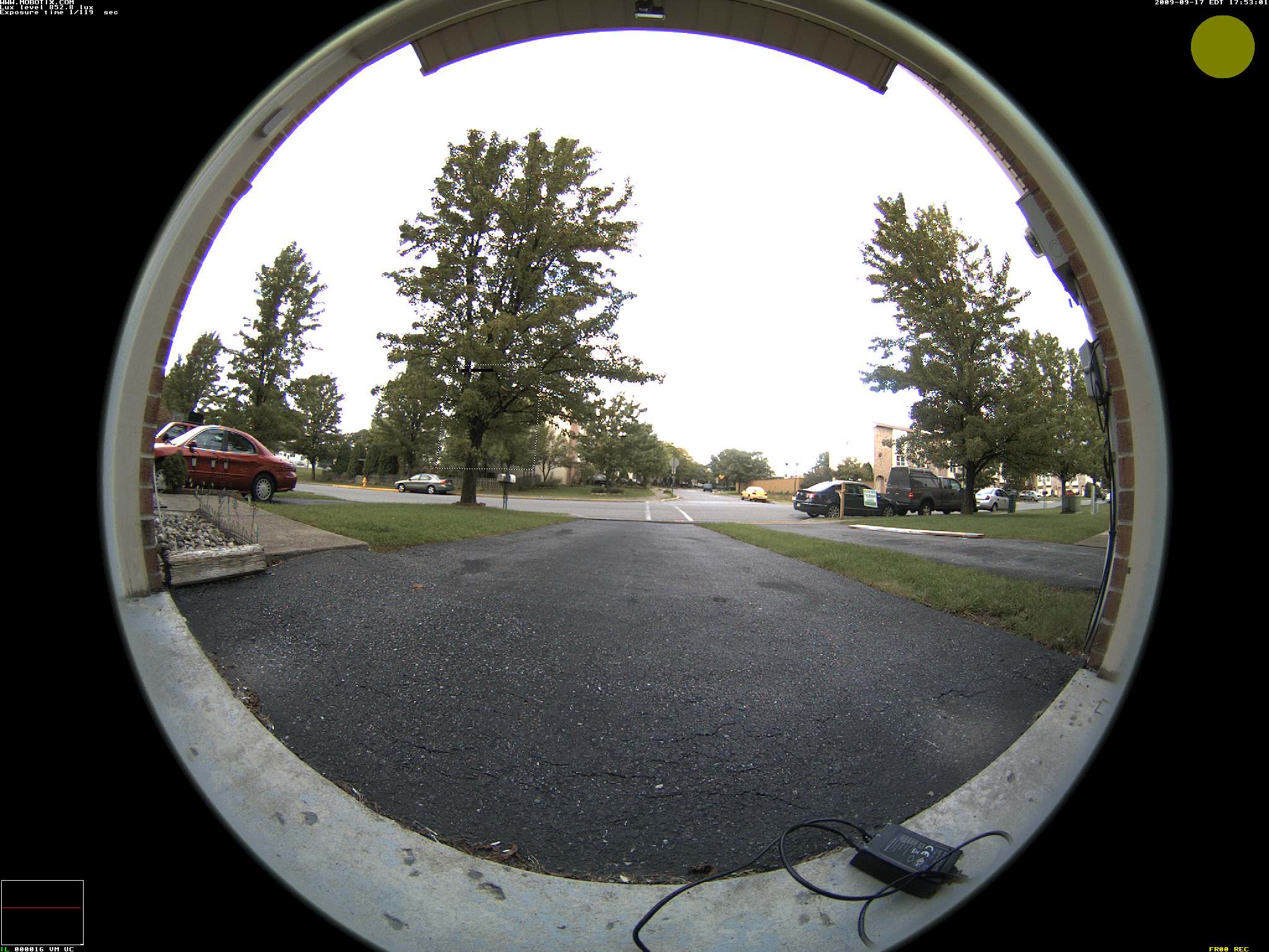

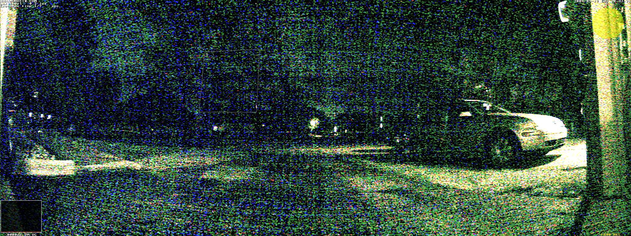

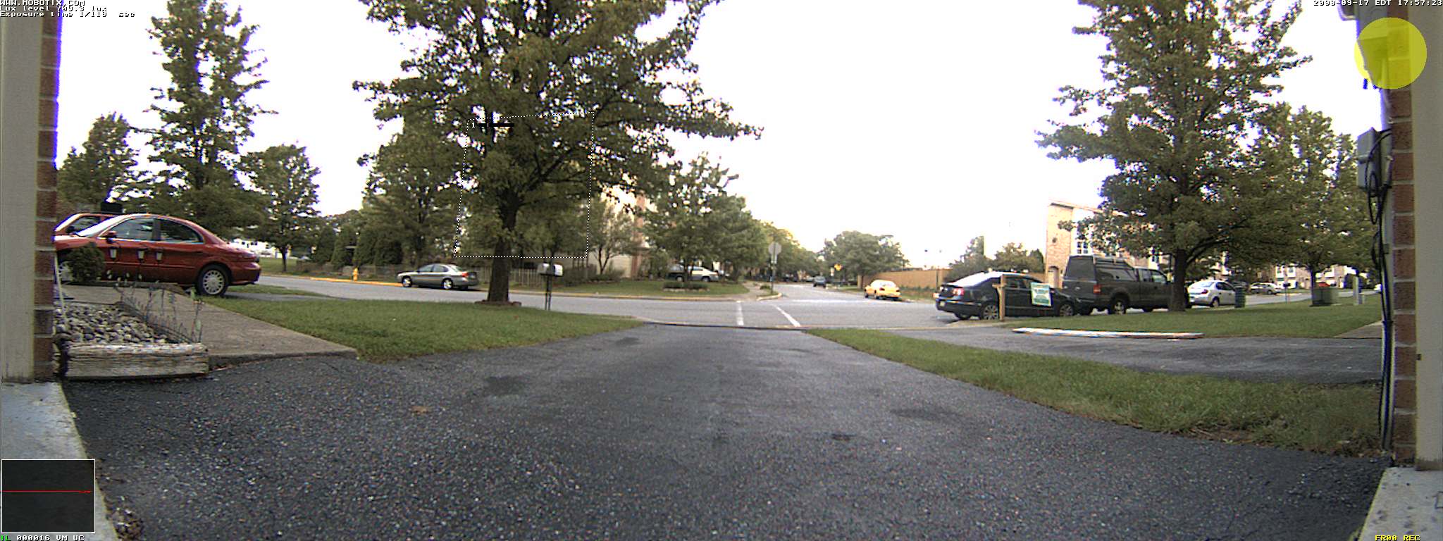

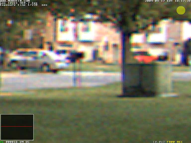

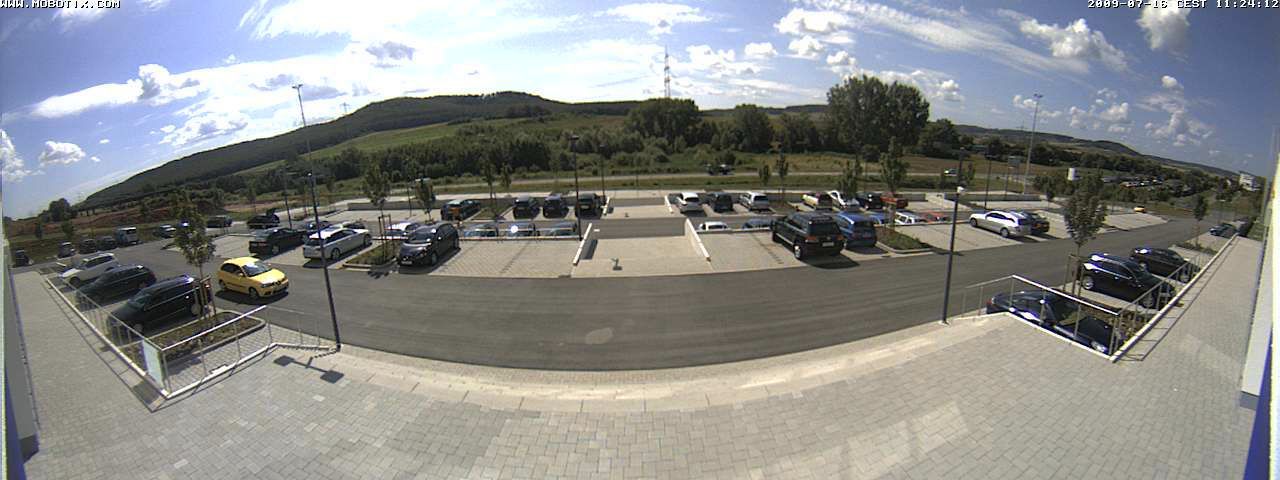

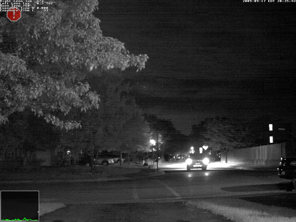

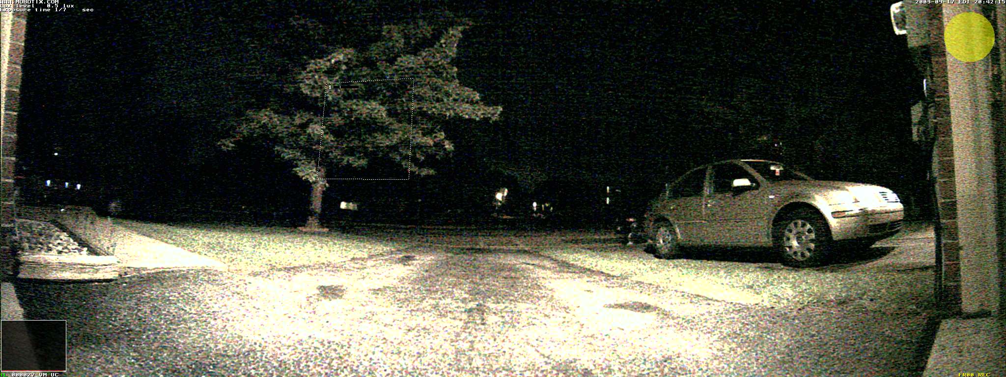

thewireguys 3 Posted September 17, 2009 (edited) The lux level and exposure time is in the top left of the image. Full uncorrected image Panorama image 8x time zoom to the right Night time .5 lux Night time .2 lux M12 night Edited September 18, 2009 by Guest Share this post Link to post Share on other sites
rory 0 Posted September 17, 2009 thanks .. now you know what i want to see pst. night time video Share this post Link to post Share on other sites
thewireguys 3 Posted September 17, 2009 thanks .. now you know what i want to see pst. night time video This is not a night time camera...... One of the best features about this camera is it doesn't look like a camera and it can go out doors. Share this post Link to post Share on other sites
rory 0 Posted September 17, 2009 This is not a night time camera...... One of the best features about this camera is it doesn't look like a camera and it can go out doors. but then its useless for outdoors if it cant see in low light. why not just slap a logitech webcam in a housing then, save plenty $$ Share this post Link to post Share on other sites
thewireguys 3 Posted September 18, 2009 This is not a night time camera...... One of the best features about this camera is it doesn't look like a camera and it can go out doors. but then its useless for outdoors if it cant see in low light. why not just slap a logitech webcam in a housing then, save plenty $$ Like I said it is not a night time camera. Share this post Link to post Share on other sites

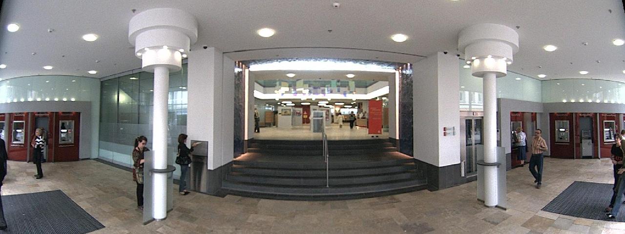

griffonsystems 0 Posted September 18, 2009 i had success with the q24 in a lobby that was shaped like a cross, it covered all areas with one camera instead of two or more i have installed over a hundred mobotix cameras in the past year and am very happy with what they have currently and what will be coming in their next release late this year the m12 is the camera i use for outside because of the dual lens - color and black and white Share this post Link to post Share on other sites

rory 0 Posted September 18, 2009 Am I the only guys diggin the Mobotix products? Give me some input and feed back guys? All my applications need to see in low light to pitch dark. Not to mention I dont know of anyone willing to spend that kind of money right now in this international depression. Share this post Link to post Share on other sites
CCTVguru1 0 Posted September 19, 2009 I saw one of these at the ASIAL last month. Considering how bright the hall was, the camera was producing a noise image as if there was not enough light. It was on Mobotix own stad and they had their tech guy there so I am sure it was setup correctly Share this post Link to post Share on other sites
thewireguys 3 Posted September 19, 2009 It's no secret that the Q24 needs light to give a good image. As you can see the outside full image is 850lux late on a cloudy and the camera gives a great image. Share this post Link to post Share on other sites
thewireguys 3 Posted September 23, 2009 finally got the camera mounted to the ceiling and set up a quad view. I must say this camera when with enough light say 10-15 lux and up is amazing. everything is built into the camera and on the screen it looks like you have 4 cameras. One camera can truly cover one room very impressive. Share this post Link to post Share on other sites
