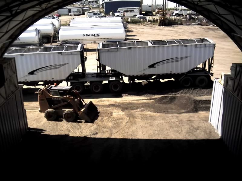

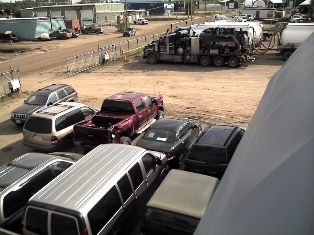

ak357 0 Posted October 4, 2009 zmxtech said: ps: that yard should have an overveiw camera and one close to the gate to get plates and ID`s This "yard" has lot more MP cameras Share this post Link to post Share on other sites
