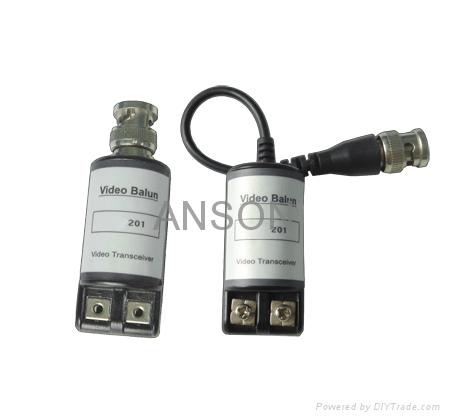

3) use cat5e cables and use passive baluns? with passive baluns, I don't need direct power at the cameras? Can I just use the baluns to feed power to the cctv via cat5e cabling?

Also, if you do go Cat5e, you don't need baluns to be able to run power over it. Or more to the point, you don't need baluns that INCLUDE power support. You DO need baluns to run video *cleanly* over UTP. Some *include* power connectors, but again, that's just for convenience - those kind of baluns generally cost more, so we generally just use the type that are video-only, and then split off two pairs of the Cat5 and connect them to power ourselves.

With the passive baluns, I can connect the output of the camera into it and the output is the cat5e. and on the DVR end, it's the way around to convert it back to coaxial?
Correct. Video only requires one pair of wire; you have four pairs available in Cat5e, so you can actually run up to four video feeds over on cable.

Some baluns simply have a pair of screw or punch-down terminals for video connections...
In this case, you'd split off the power pairs yourself.
Some have RJ45 jacks on them and split out the power connections internally to a pair of pigtail wires; this is functionally no different from splitting out the power connections yourself, it's just done for convenience and a clean install. It does mean that you have to terminate your runs with RJ45 plugs or jacks, however.
