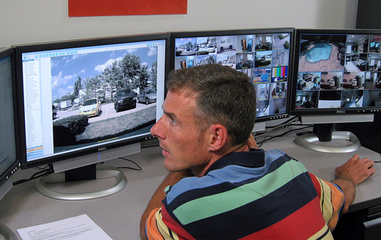

Jorel 0 Posted October 19, 2009 Problem is I think Hikvision cards are usually encrypted and do not have WDM drivers which expose a DirectShow interface. I haven't used it, but i did come across this DVR software which looks like it can do multiple monitors well. http://www.exacq.com/products/vms_photos.html Youtube Demo: FAQ: http://www.exacq.com/faq/index.php?action=artikel&cat=6&id=43&artlang=en&highlight=ptz Share this post Link to post Share on other sites
koolmer 0 Posted October 19, 2009 @securicorp Thanks! I will try this out. @JD Yes I am talking about screen resolution. I don't think it would make any sense to record an analogue camera in 1080p @Jorel The Exacq Software is awesome, but only for IP cameras. Exacq has their own servers with analogue video capture cards, but they are really expensive. Share this post Link to post Share on other sites
