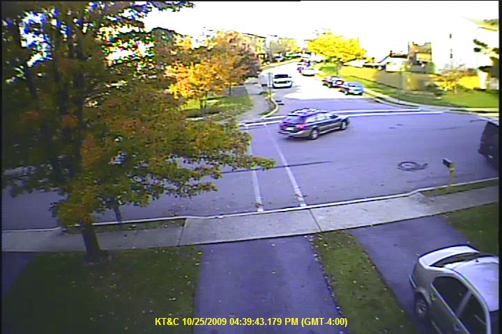

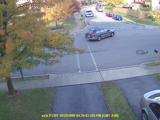

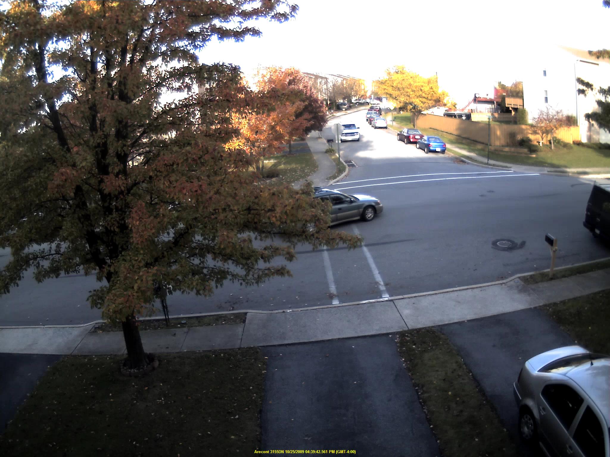

images......
Arecont AV3155DN 3MP Arecont 4-10lens

Axis P3301
KT&C analog color high res built camera with a Axis Q4701 encoder.
Thanks for posting these images. The purple fringing in the Arecont image is horrific, but for a security camera, it's not critical. It does suggest, however, that these images could be further improved with refinements to the firmware.

Where do you see purple in the Arecont? That is not the best lens I have for the Arecont but it is the only one I have so all cameras will have close to the same FOV
Check the leaves near the top of the image. If this were a digicam, you could not give them away. Of course, it's a security cam and low light performance is far more important.

I see but my point is comparing megapixel to analog.

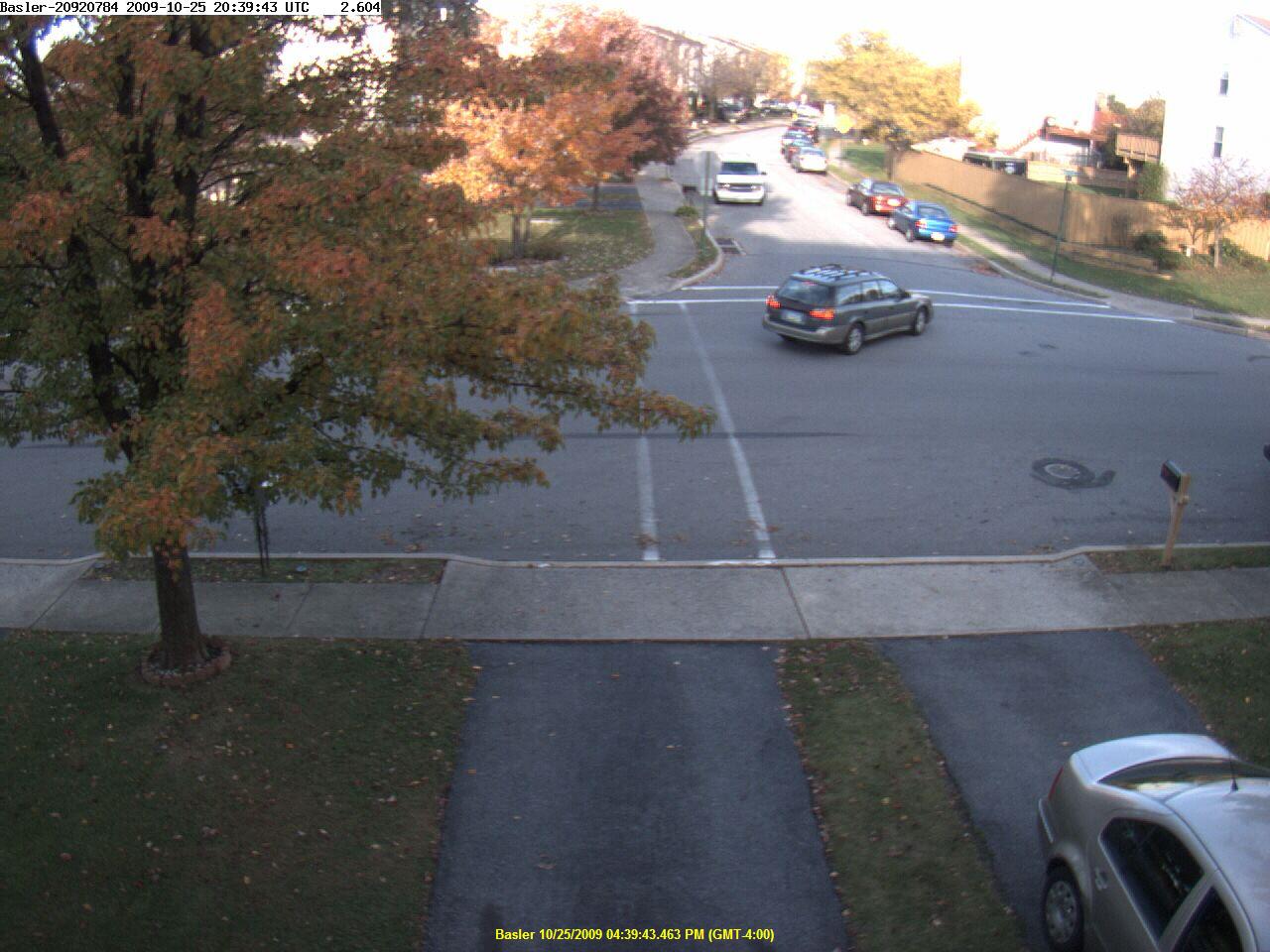

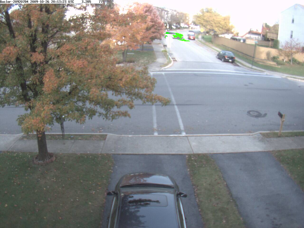

This camera is interesting and I will be honest and tell you this is the first CCD megapixel camera I have played with with auto iris.
This is an image with the default factory settings. The camera tries to lower the exposure time to 1/1 and auto adjust the gain.
This image the exposure time is 1/100 and gain is 0.
But the image just doesn't look sharp and the colors are dull.

I don't think the Arecont looks bad for a security camera, and in fact, the Arecont was the best of the group by a wide margin. The Basler is a bit pixelated, but still quite good for day use. Would be curious to see the same comparisons at night. I expect the Arecont would kick butt.
It does lack some contrast, which could be the lens, or it could be the firmware or some setting does not correctly adjust the contrast. It also appears to be soft, which again could be the lens or possible the focus.
That said, my Axis 223M is about the same wrt contrast and focus. I could probably play with the focus a bit more, but it's a pain to adjust, particularly at night with IR.

I checked the Basler image in Photoshop. As I expected, the exposure is off quite a bit. There are no pixel values between 0 - 40 in the darker regions, and the sky is blown. If the shutter had been increased by one full stop, I expect the contrast in the image would look much better (though it would still be soft).

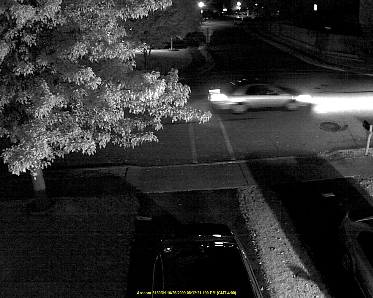

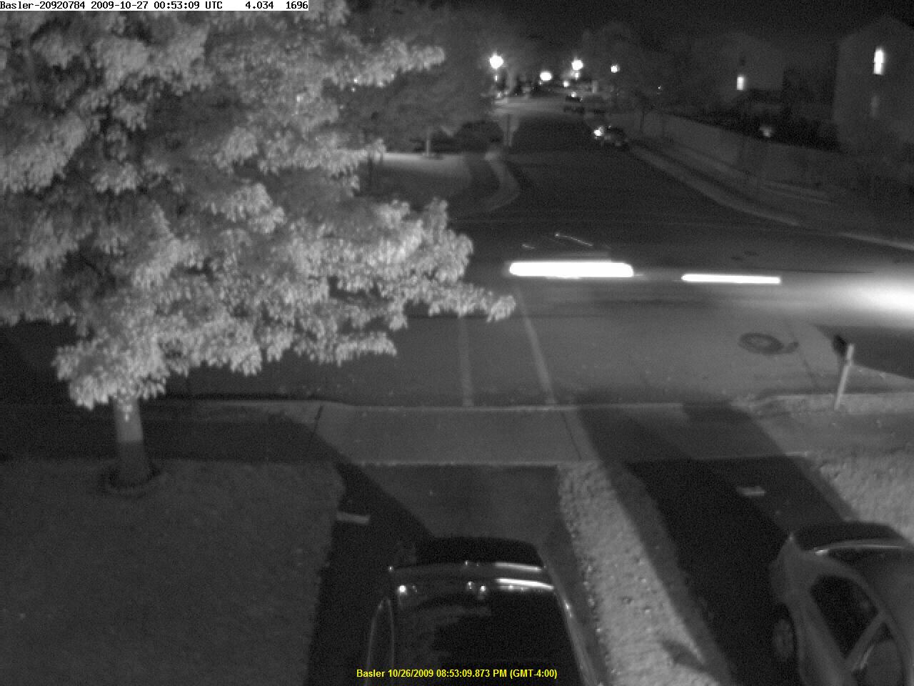

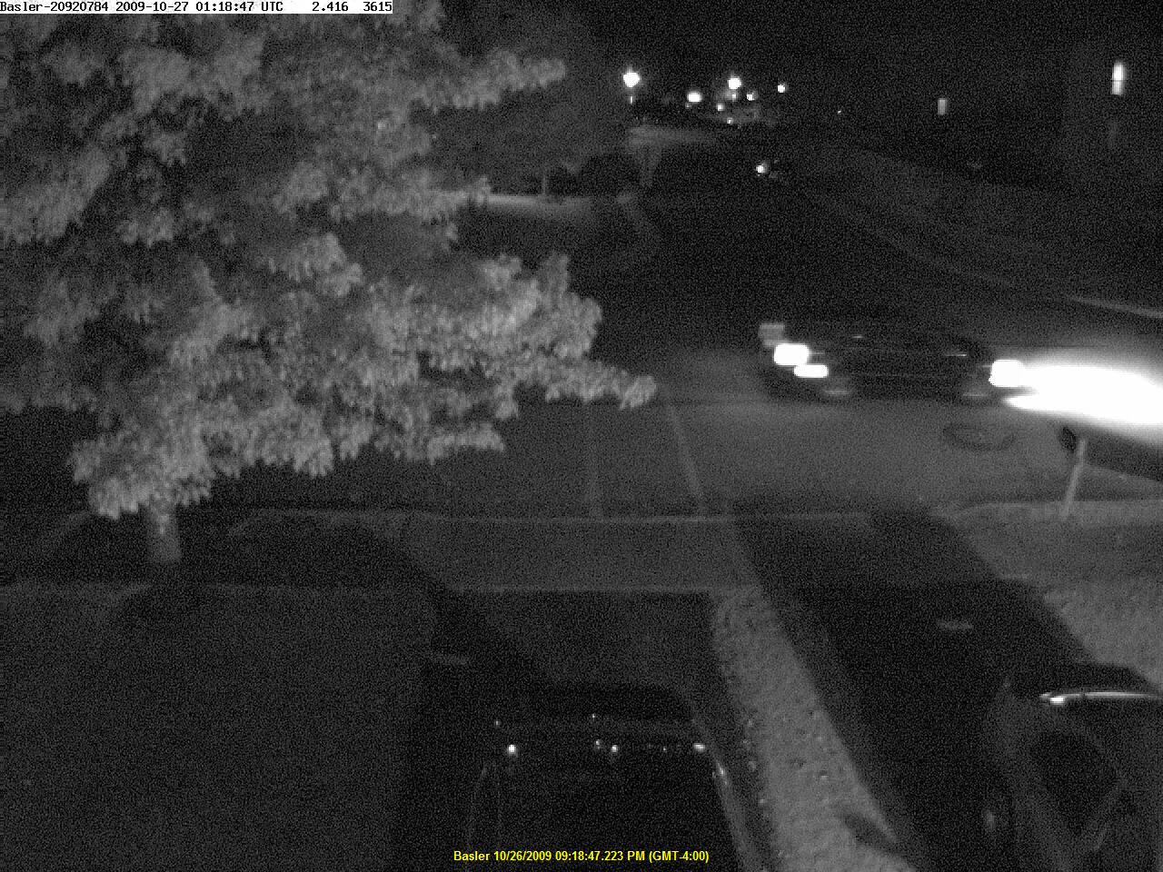

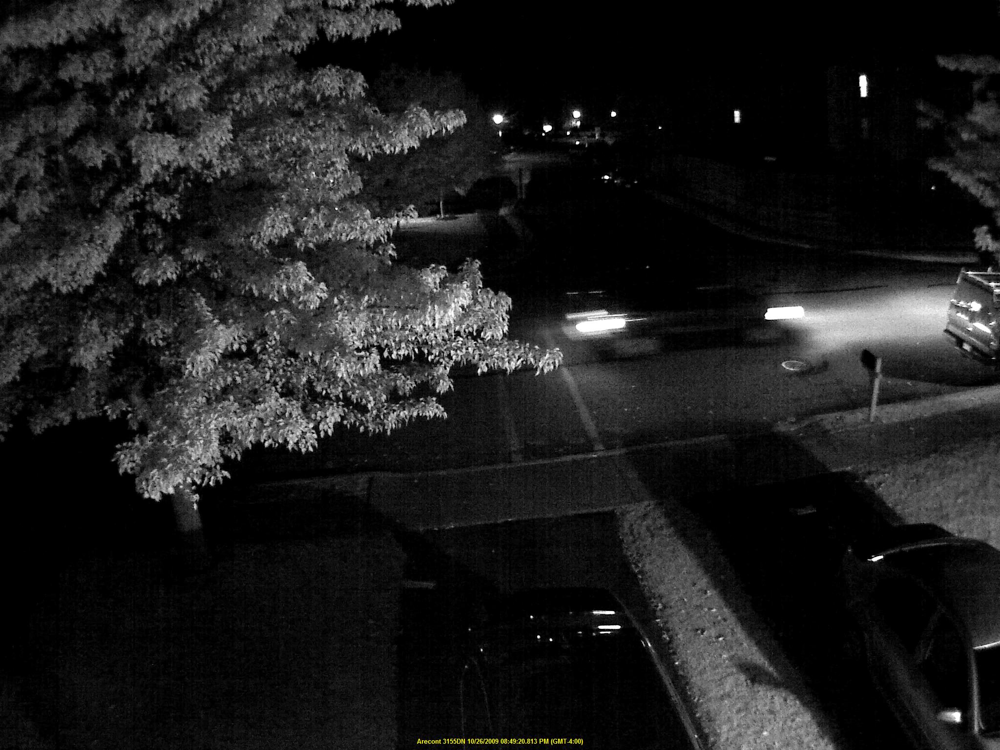

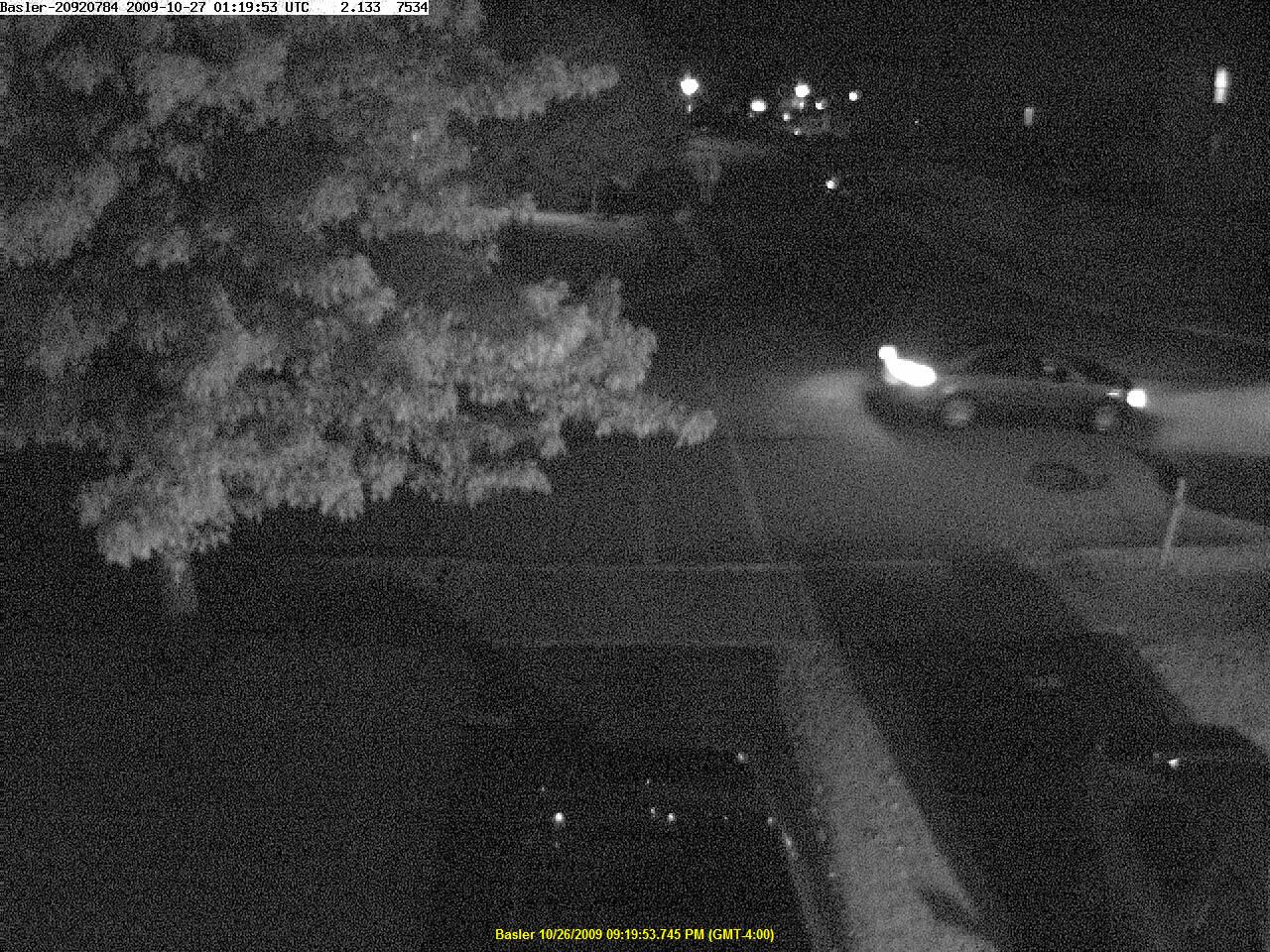

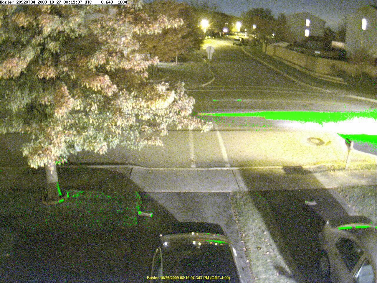

now for the money shots
These are all default settings
Basler with a 1/1.3 exposure setting and gain at 26db (This is what the auto setting came up with)
There is a car going by
Basler again ( exposure offset to -56 switched the auto day/night to night and i limited the gain to 6dband set it to "prioritize framerate" also I refocused the camera for night
Arecont 3155DN (default)
Arecont 3130DN (default)

What are the shutter speeds on the Arecont cameras?
Best,
Christopher
Let me check I was trying to get a good image from the Basler then I was going to work on the Areconts.
And the lens on the Basler is a Tamron 2.8-12 with a F1.4
