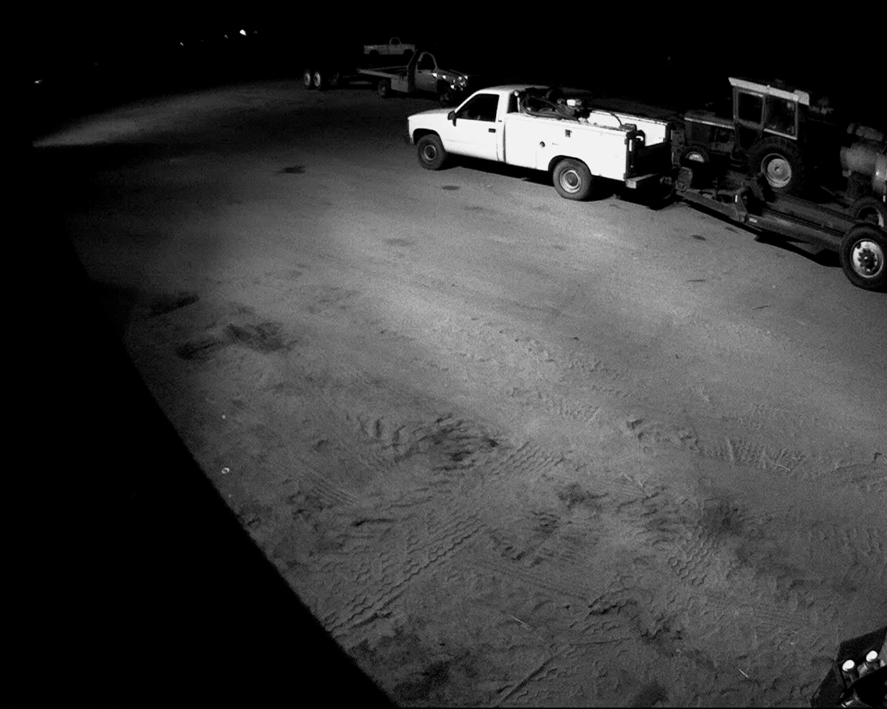

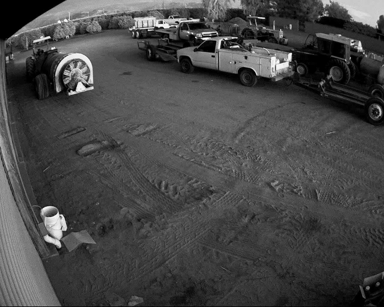

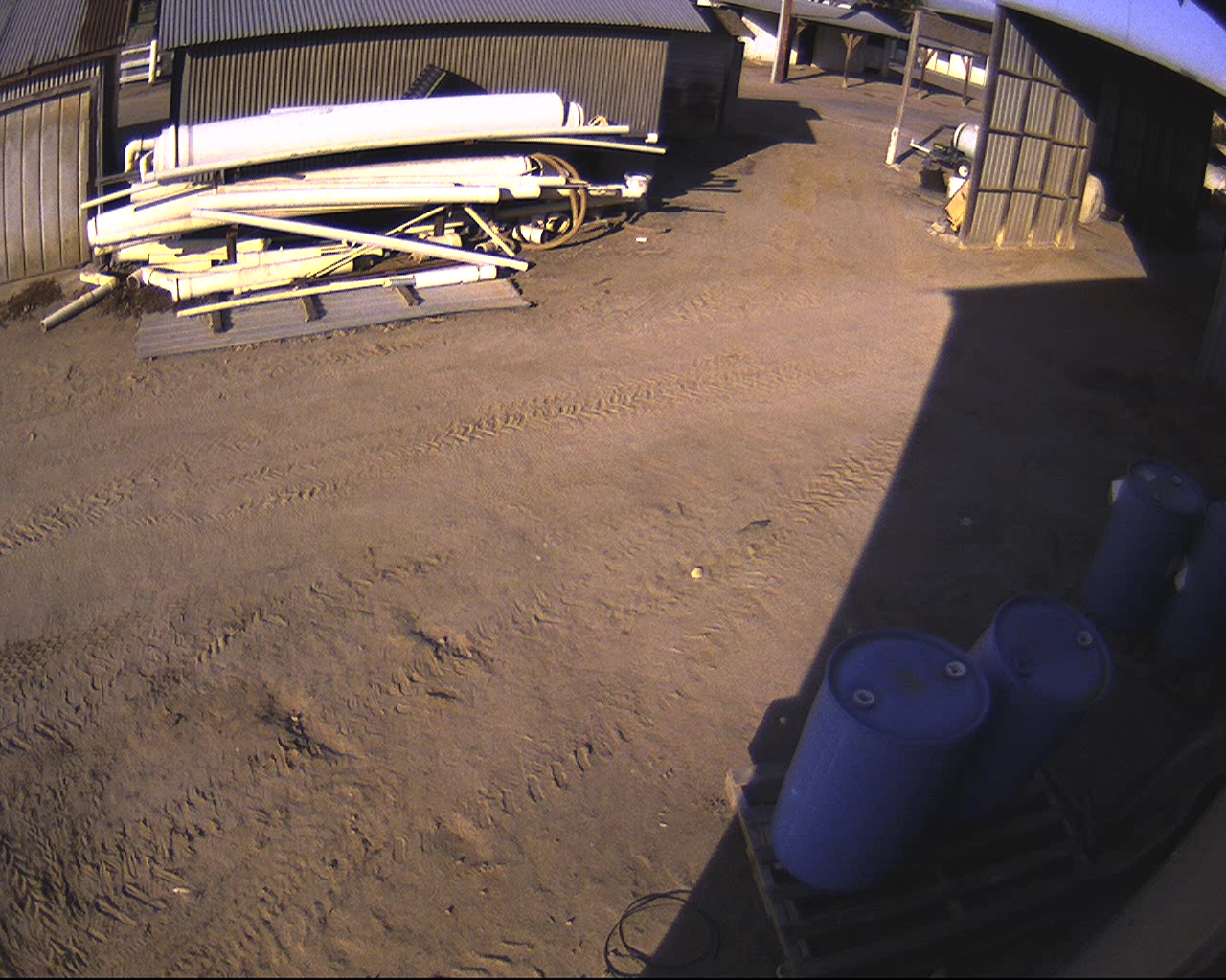

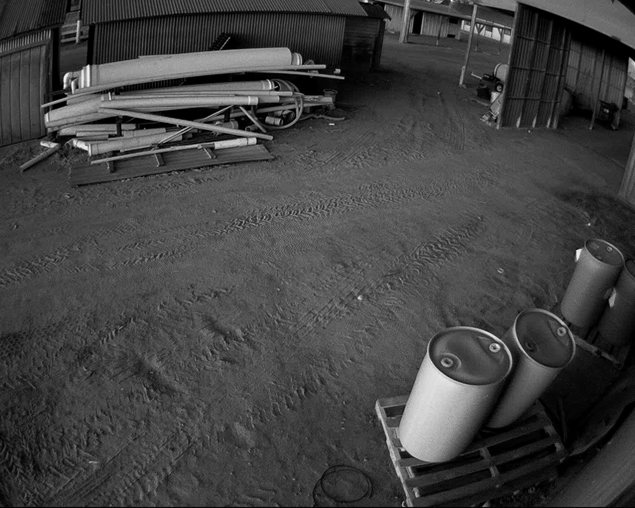

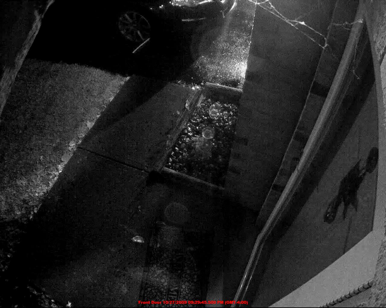

hardwired 0 Posted October 29, 2009 Actually, the 7411 does have a cutfilter... here are some day, dusk, night samples. I've been pretty happy with them, overall. Share this post Link to post Share on other sites
3RDIGLBL 0 Posted October 30, 2009 WOW! These are great example pictures. Thanks so very much hardwired. I just ordered 14 of the ACM-7411 today with wall brackets. I feel a little better now that I've seen pictures. Customer has street lights all over the place but the lights of course create lots of shadows and dark areas. It will be a bit of a challenge to do this one but these cameras appear to work fine for the price. THANKS AGAIN! Share this post Link to post Share on other sites
rory 0 Posted October 30, 2009 Looks like it is terrible for night. Those night shots look just like color minus the chroma, least it works with light though. I like the second to last picture, can i get that in all of them please, thanks Share this post Link to post Share on other sites

zmxtech 0 Posted October 30, 2009 yes the jump is way to $big$ on a 7411 being triple the price. I have been holding off buying them due to this night problem. looks like multiple shadows in that last night shot, and there quite long so the lights must be close and low also ? In these pic's the shutter speed must the real slow, like \25 lets see a car drive past and catch the plate or a person try to sneak past. I get the feeling that Acti is on the verge of adding better night capability to there cameras... they just need to fix sensor noise and more cut filters. Would not hurt to throw in a built in illuminator in there. I think anyone can build an IP camera for the day but night sorts em out... Share this post Link to post Share on other sites

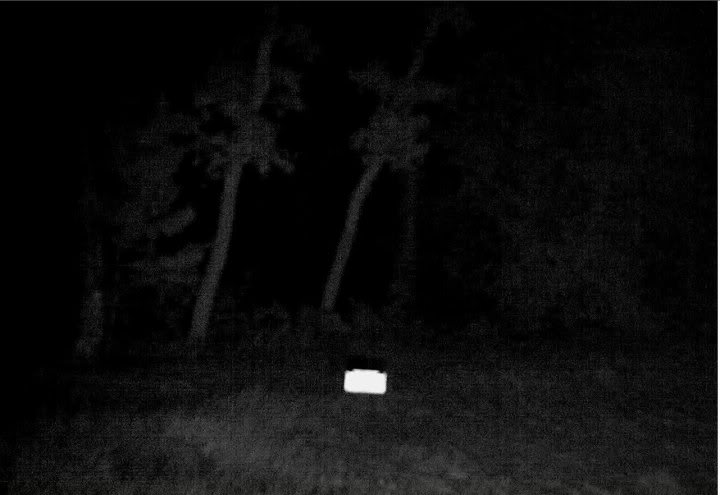

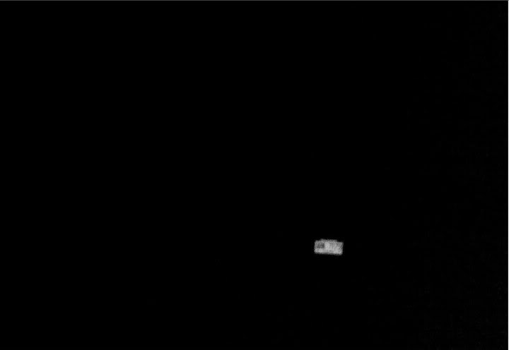

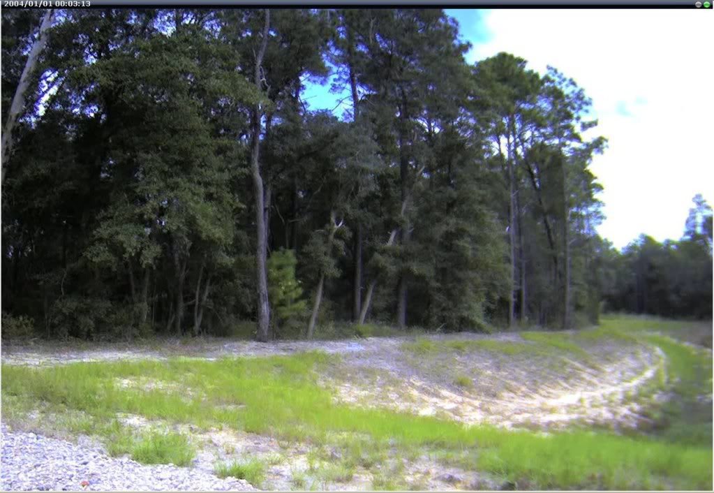

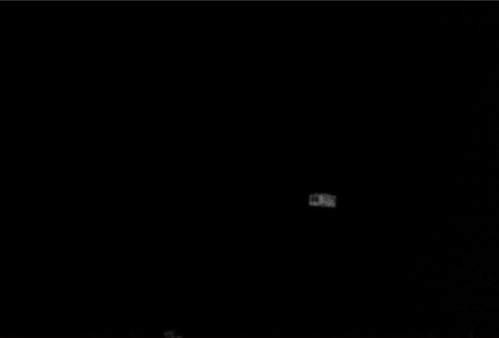

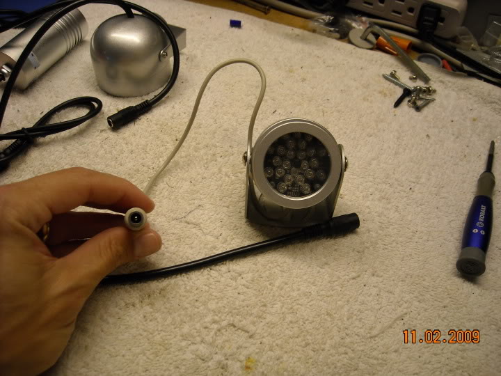

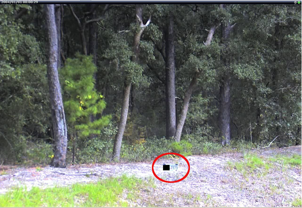

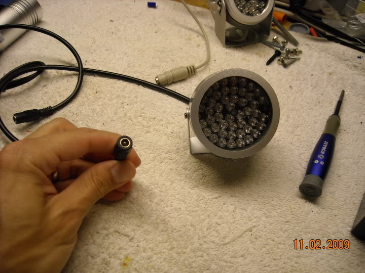

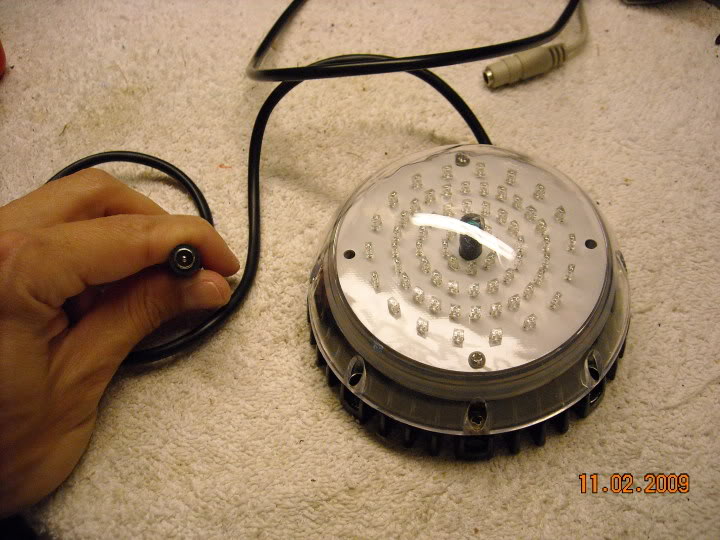

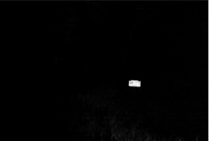

Sawbones 0 Posted November 3, 2009 I'm going to post a bunch of pictures here, gentlemen... and I hope you're going to tell me I've done something wrong, because the 7411 I'm testing has very weak night performance. Not "marginal"... I'm talking about genuinely disappointing. Here's the daytime scene, with a license plate as the point-of-interest (about 50 feet away, and partially blacked-out). The first picture is with the view pulled all the way back with the included lens. The second is zoomed in on the same scene, again using the integrated lens. All pictures were taken with shutter speed on "normal" instead of "slowest" (I'm not interested in Speco Intensifier-esque blurry pictures). Here are the night-shots, including the IR illuminators used to generate them. These were taken last night... the moon was also practically full. Gentlemen, somebody tell me what I'm doing wrong here,... because unless I"m doing something wrong, the IR sensitivity of this camera is truly dismal. These are all near-IR illuminators (not 940nm)That last illuminator in particular is a 60W military-grade IR emitter that pulls 5A at 13.3V off a dedicated power supply. It turns night into day for virtually any day/night camera... except, apparently, this Acti model. Somebody put me some knowledge in here. Share this post Link to post Share on other sites
ronster 0 Posted November 3, 2009 It says it has mechanical ir cut filter. Shouldnt it look better? Share this post Link to post Share on other sites
Sawbones 0 Posted November 3, 2009 It says it has mechanical ir cut filter. Shouldnt it look better? My feeling exactly. Perhaps I'm spoiled, since most of the day/night cameras I've installed were the Panasonic domes (484S series)... but I frankly expected much better pictures. I'm probably going to go out there another night and see if they look equally bad... something's got to be wrong, but I don't know what it is. The camera is brand-new, so I can't imagine it's got a bad ICR (and the images I did get are in B&W) Share this post Link to post Share on other sites
rory 0 Posted November 3, 2009 Looks like the Iris is closed too much. Also check power and the lens. Share this post Link to post Share on other sites

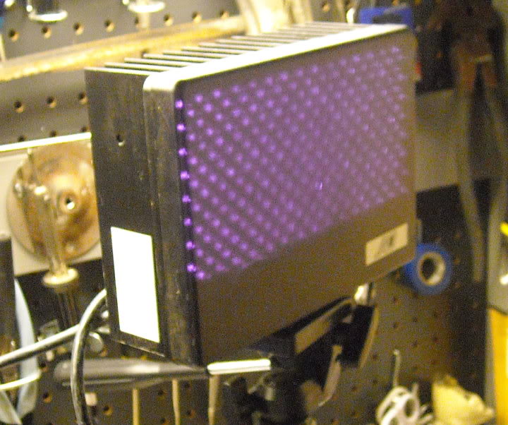

zmxtech 0 Posted November 3, 2009 I dont think they have a manual Iris ? Anyway looks like the camera has switched to night mode but the cut filter is still there. it has not moved -you should be able to hear it move ? The First two illuminators are Ebay toys 1st one might do 10m the other a wide angle for ceilings etc the other "military" should produce a nice crisp BW picture. z Share this post Link to post Share on other sites
hardwired 0 Posted November 4, 2009 Try refocusing at night, under IR. It looks like you have enough focus shift at night to make it fairly fuzzy, and with the iris fully open, it's more critical. The image during the day will have the iris closed down enough that (hopefully) it will not be a problem. Also, my images were with some frame integration... But not anywhere the slowest, motion blur doesn't seem to be a problem there. I'm not a big fan of slow shutter, but in a lot of instances, 1/15th (2 frames) or so isn't a big problem. Share this post Link to post Share on other sites
Sawbones 0 Posted November 4, 2009 I'm pretty sure that Acti cam is auto-iris. I'm going to try it again... I ran it today from several different PoE sources, and it behaved appropriately. I have tried running it today in a completely dark room, and it sees very well with IR. We must have had an ICR malfunction last evening. It's one thing to have a bad picture in a non-IR-reflective environment (vegetation, for instance, doesn't tend to reflect IR very well)... quite another to get no picture in an area that's absolutely saturated with illumination of the appropriate wavelength. That military IR emitter should have been the tip-off... it's powerful enough when energized, that it's not even eye-safe within about five feet of the radiating surface. When I get more pictures, I'll post them. Share this post Link to post Share on other sites
megapixel man 0 Posted November 4, 2009 Try refocusing at night, under IR. It looks like you have enough focus shift at night to make it fairly fuzzy, and with the iris fully open, it's more critical. The image during the day will have the iris closed down enough that (hopefully) it will not be a problem. Also, my images were with some frame integration... But not anywhere the slowest, motion blur doesn't seem to be a problem there. I'm not a big fan of slow shutter, but in a lot of instances, 1/15th (2 frames) or so isn't a big problem. True, is the lens your using IR corrected? Share this post Link to post Share on other sites
Sawbones 0 Posted November 4, 2009 Try refocusing at night, under IR. It looks like you have enough focus shift at night to make it fairly fuzzy, and with the iris fully open, it's more critical. The image during the day will have the iris closed down enough that (hopefully) it will not be a problem. Also, my images were with some frame integration... But not anywhere the slowest, motion blur doesn't seem to be a problem there. I'm not a big fan of slow shutter, but in a lot of instances, 1/15th (2 frames) or so isn't a big problem. True, is the lens your using IR corrected? Good question... I'll have to check the spec sheet. It's an integrated lens, so there's no changing it out, unless one of you knows a trick. ************** Edit **************** It doesn't say if it's an IR corrected lens. Share this post Link to post Share on other sites
