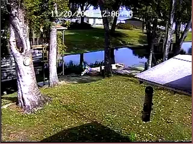

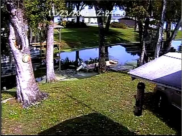

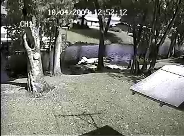

There was an unanticipated delay in getting and installing the CAT5 baluns for the SIR-4160 camera but they are now installed. I cannot see any difference whatsoever in the picture quality after the baluns were added. The original cat5 run between the QSD9004 dvr and the SIR-4160 camera was about 20-25 ft. When the baluns were installed it was shortened to about 15 ft. Below, I will try to make accessible screenshots I made of the original LTCMRH3508 camera (no IR cut filter, no baluns), the new Samsung SIR-4160 w/o baluns, and the 4160 with baluns. There is only the one camera on this system right now. I'm thinking the H.264 compression of the 9004 is limiting the potential picture quality ot the 4160 and I'd appreciate comments from experts regarding this, especially ones that would quantify possible improvement that might be expected by going to a higher quality mepeg4 dvr.
Were the screen shots made through an internet browser view window, or directly from the dvr? My pictures posted were made through an internet browser window and the quality is quite a bit better directly from the dvr, but I cannot seem to find an easy way to create a snapshot on the Avermedia 1304 other than through a browser window. Usually a browser internet connection window results in poorer quality compared to the actual recording on the dvr. I was expecting to see better results from the 4160's compared to my pictures from my inexpensive domes(for sale now in the classified section). Your DVR would be a suspect, as the 1304 is pretty high quality in recording (get one!).
All three of those screenshots were made with an Internet browser. Not that it matters but they were captured with FastStone Image Viewer which is one of the best image handling programs I have ever seen. Thanks for the tip on the AverMedia 1304. From my short looking around it seems those tend to be available mostly overseas and not so much in the USA. Where did you find yours? re video quality: I think it makes more sense to use less compression and more hdd.
