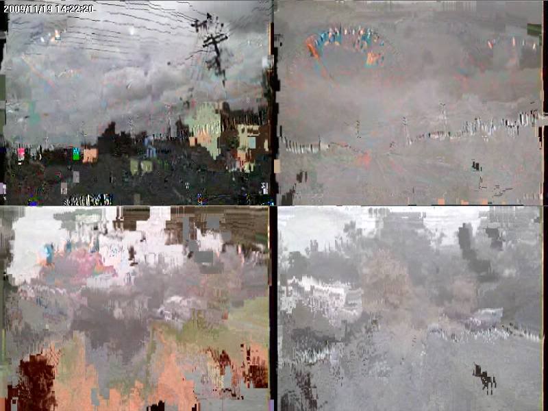

been having a few problems with my DVR.
it seams to randomly stop recording, gets cameras mixed up, times mixed up, some video is missing, some is mixed in with video of another day.
whats going on with this thing?
changed hardrive to spare one but that seams to be doing the same. old hardrive tests out fine.

edit: i only have 3 cameras. the right hand bottom pic in the quad is not normally there as the input is turned off.
i wonder if what i thought was faulty camera is actually a recorder issue.
any ideas?
Dunno about your first pic - that looks more like a cam issue. The second pic with the pixellated/blocky pictures is an image I'm WELL familiar with... I have the same issue on my EB1304MOB, roughly every 6 months. New hard drive fixes it every time. The hard drive always tests fine in my PC afterwards.

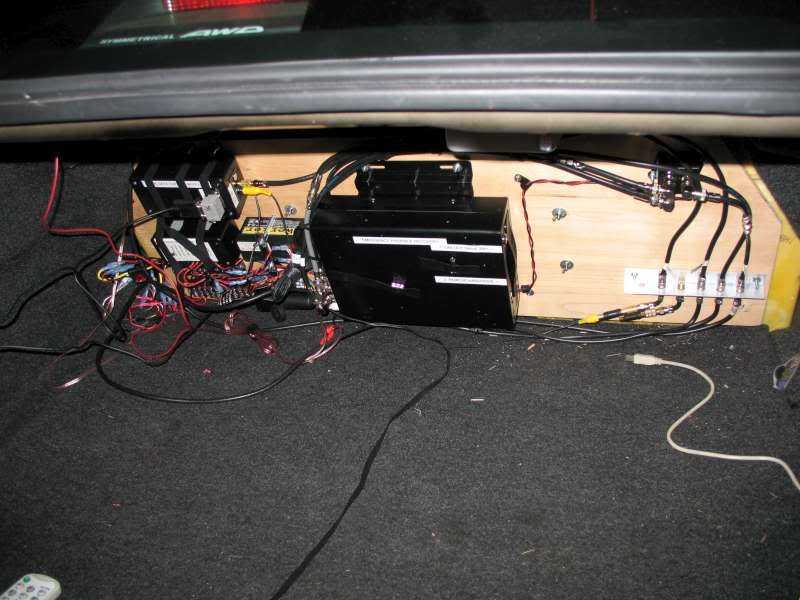

How do you have the DVR mounted? Aver says it must be horizontal/flat. I have mine bolted to the back of the back seat of my car so it's about 20deg from vertical. Aver says this is a no-no as the vibration damping doesn't work at this angle.
I modified the drive tray to allow the vibration damping to work at this angle by cutting away some surplus metal that the rubber-bumper-mounted inner tray was bashing into on bumps. Fingers crossed I get more than 6mo this time

This is what mine looks like once the HD gives up the ghost... (and I only ever figure out the HD is bad when I need to play back some video!!)
thanks for that. looks like the same issue then.
the problem here is i have absolutely no where to fit it flat.

i have modified mounts. i will have to improve them some more. bit tricky as this unit is different sized to my old one.

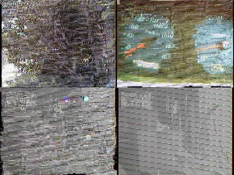

the pics i put up, one has no bumps on the road, the other is with vehicle stationary.
