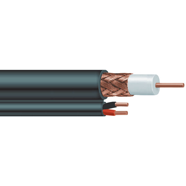

UL warns of communication cable with unauthorized UL Marks
Northbrook, Ill., USA -- November 5, 2009 -- Underwriters Laboratories (UL) is notifying consumers, manufacturers, regulatory agencies and authorities having jurisdiction that the Communication Cable, identified below, bears an unauthorized UL Mark for the United States and Canada. This product has not been evaluated by UL to the appropriate standards for safety for the United States and Canada, and is not authorized to bear the UL Mark. It is unknown if this product complies with the United States or Canadian safety requirements.
Name of product: Siamese CCTY Coax Cable - CM 2/18 AWG + RG59/U
