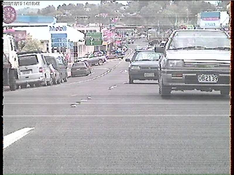

tweak'e 0 Posted December 15, 2009 any ideas what would cause this? i hope its not yet another faulty camera. its only on one of the cameras. Share this post Link to post Share on other sites
Soundy 1 Posted December 15, 2009 Looks like a photo of a failing CRT. Share this post Link to post Share on other sites
tsd 0 Posted December 28, 2009 Swap the camera with working one and you will find the problem most of the time it's either Camera or Power Supply Share this post Link to post Share on other sites
tweak'e 0 Posted December 28, 2009 sorry, forgot to post that it was fixed. lead to monitor which was split off the camera line was intermittently shorting from shield to centre. installed a proper active splitter which kept it isolated so it only effected the screen. just had to custom make a cable for the screen. Share this post Link to post Share on other sites
