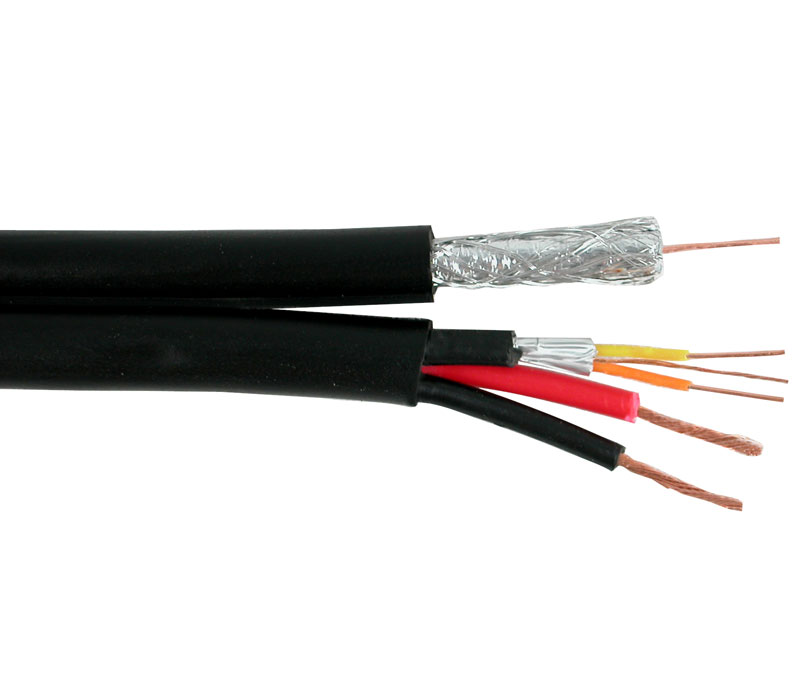

tomcctv 190 Posted January 3, 2010 Hi everyone, What type of cable should be use for PTZ cameras? Can we use RG59? Thanks! RG59 is fine with power. but you will also need data. so also use cat5. alongside your RG59. or you can use composite cable. http://product-image.tradeindia.com/00311787/b/0/CCTV-Cable-.jpg Share this post Link to post Share on other sites
missmimi 0 Posted January 3, 2010 Hi everyone, What type of cable should be use for PTZ cameras? Can we use RG59? Thanks! RG59 is fine with power. but you will also need data. so also use cat5. alongside your RG59. or you can use composite cable. http://product-image.tradeindia.com/00311787/b/0/CCTV-Cable-.jpg Thanks tomcctv! The link shows composite cable? What is a composite cable? Sorry, I'm still a newbie in this industry... Share this post Link to post Share on other sites
