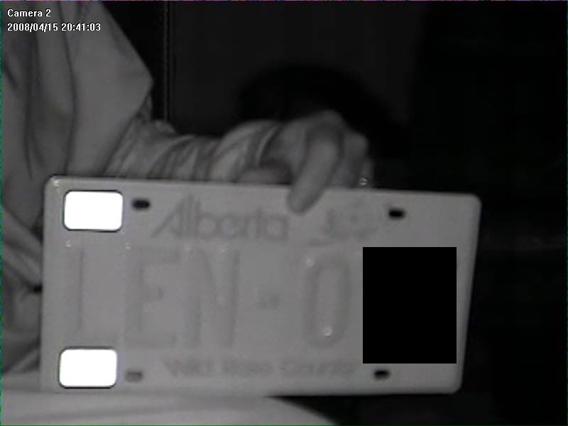

Soundy 1 Posted January 19, 2010 Rory What should I do ?numbers on plates are RED Move away from Alberta? Share this post Link to post Share on other sites

rory 0 Posted January 19, 2010 Rory What should I do ? numbers on plates are RED We have no issues here with those plates, red writing on white background. Must be the cold up there Seriously though, why is that a problem for you? Share this post Link to post Share on other sites

ak357 0 Posted January 20, 2010 Seriously though, why is that a problem for you? Have a look IR and Plate Share this post Link to post Share on other sites
rory 0 Posted January 20, 2010 Seriously though, why is that a problem for you? Have a look IR and Plate What kind of IR are you using, also what type of camera? Maybe its a different red then on the plates we have here. All our government plates are red letters with white background. Maybe its the camera? I only used the Extreme CCTV Reg camera for night time licence plate capture .. are you using that or is that something else? I wouldnt sit so close to the Extreme Reg camera with IR on though, could burn skin. Share this post Link to post Share on other sites
ak357 0 Posted January 20, 2010 (edited) Seriously though, why is that a problem for you? Have a look IR and Plate What kind of IR are you using, also what type of camera? Maybe its a different red then on the plates we have here. All our government plates are red letters with white background. Maybe its the camera? I only used the Extreme CCTV Reg camera for night time licence plate capture .. are you using that or is that something else? I wouldnt sit so close to the Extreme Reg camera with IR on though, could burn skin. IR is from reg 840 nnm bullets tried with few diff bullets I was able to get good results if I invert video Edited January 20, 2010 by Guest Share this post Link to post Share on other sites
cglaeser 0 Posted January 20, 2010 What kind of IR are you using, also what type of camera? Maybe its a different red then on the plates we have here. I don't think it's the IR or the camera. I'm guessing it's the color. I have an Axis 223M and RayMax Fusion 50. A very dark blue sweatshirt that I own appears bright white and much brighter than a medium pair of blue jeans. I've seen various dark deep colors reflect the IR very brightly and while some lighter colors don't reflect much IR. Best, Christopher Share this post Link to post Share on other sites
rory 0 Posted January 20, 2010 What kind of IR are you using, also what type of camera? Maybe its a different red then on the plates we have here. I don't think it's the IR or the camera. I'm guessing it's the color. I have an Axis 223M and RayMax Fusion 50. A very dark blue sweatshirt that I own appears bright white and much brighter than a medium pair of blue jeans. I've seen various dark deep colors reflect the IR very brightly and while some lighter colors don't reflect much IR. Best, Christopher Yeah but thats why we pay extra for the Reg cameras. .. its not your standard IR, its totally different build. not sure about the reg bullet though. Id have to check but im pretty sure we had no problems with any color plate here. Its been a while though. Share this post Link to post Share on other sites
